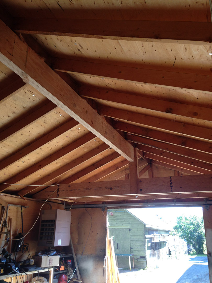

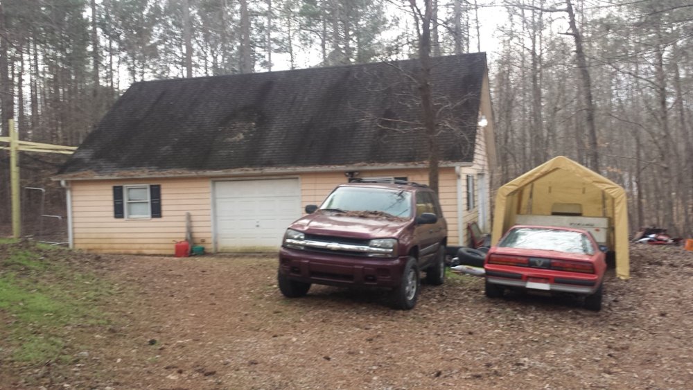

Looking at the slope, you may be better off modifying the trusses appropriately for a higher ceiling.
thats kinda what i was thinking... open the trusses up above where the lift is for clearance.
Mod the trusses where the lift will go and change the roof over the door to a huge dormer with a taller door? Not my shop and can't see it from my house.
I don't think that would work, they are prefab trusses and the shop is only 26ish ft deep.
From the pics, the trusses are still wooden, even if prefab. You should be able to mod them or place a beam it to open it up. Might not be where you want your lift though. If your side door was centered in the room, you could easily raise a section and put a taller door in.
If you are planning to add onto it anyway, why not build the expansion such that you can put the lift in it?
Rafters on a prefab truss are too small to put a beam up at the ridge. Look at a truss. The rafters always have 1 or more supports going to the bottom chord/ceiling joist to support it. Removing it would likely double the allowable span of that joist member.
And, without the ceiling joists how do you keep the walls from falling over during wind loading or dead loads pushing on it from the roof?
I talked to a truss designer he made it seem like it was a simple process to redesign and sister the trusses to change it around. He was only going to charge me something like $400 for sealed drawings
