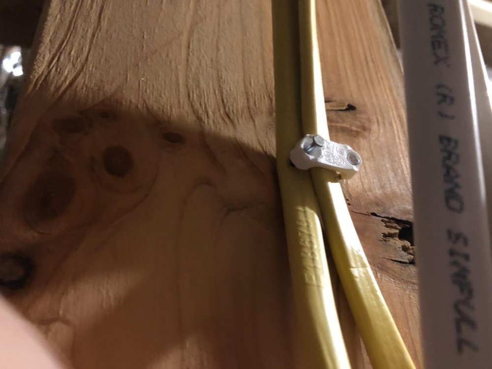

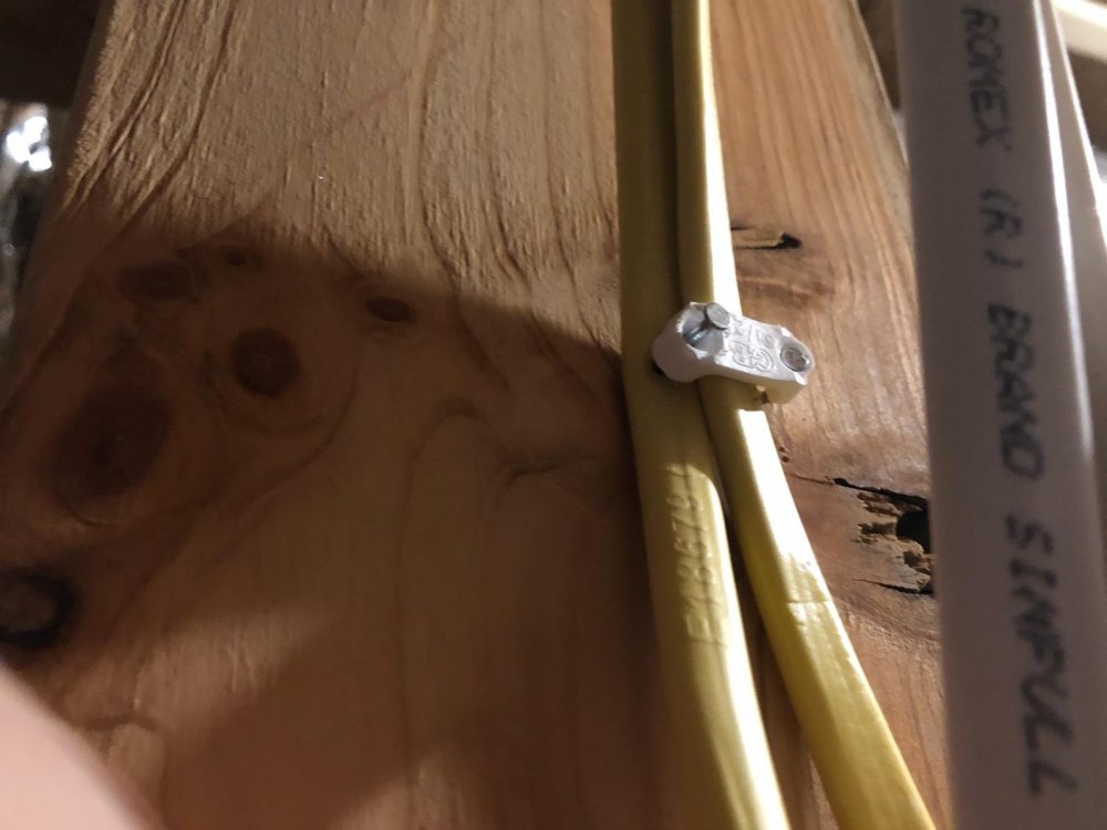

At least I finished up some rewiring on the house. I started last night and had
@Ron come over today to help me work through a couple places where my electrical skills came up short

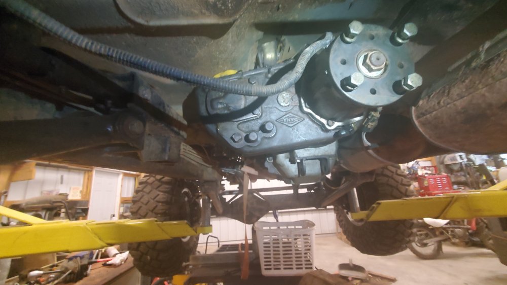

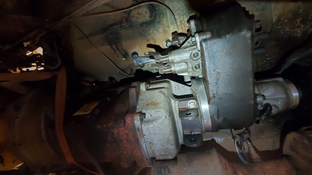

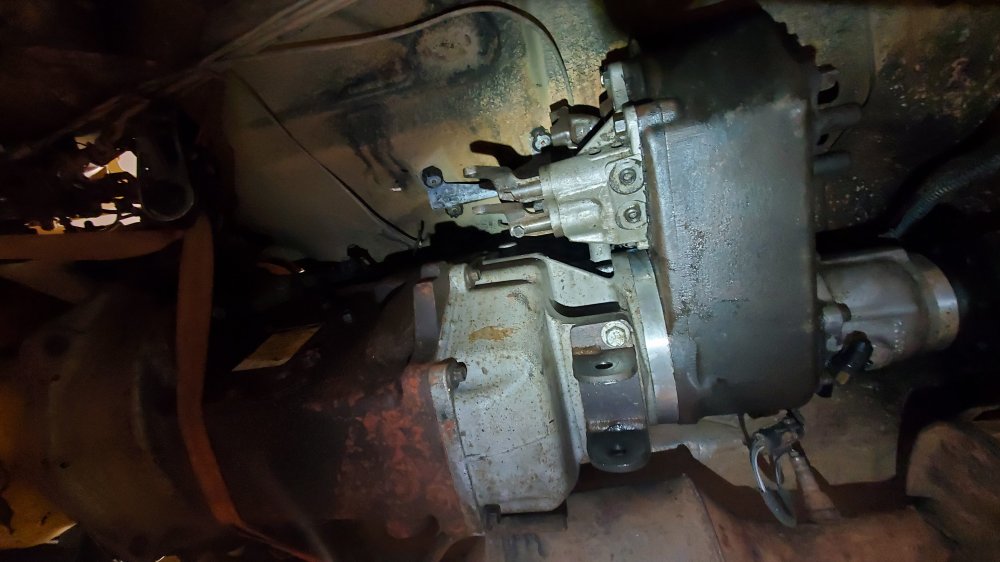

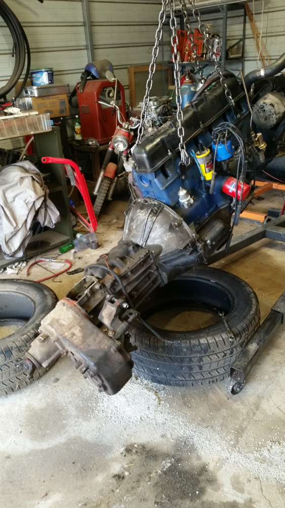

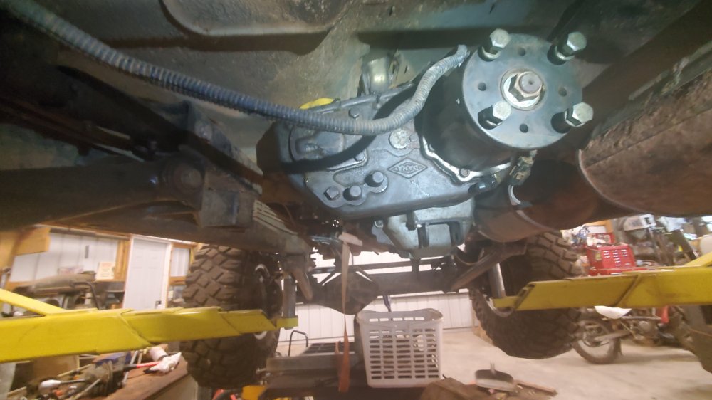

Also did a little work on the jeep. Finished putting together the Dana 300 I took apart 2 months ago. Enlisted the help of
@Andy J. to wrassle it into place. Only to find out it wouldn't work how it was clocked. Pulled the studs out of the clocking ring, rotated to the right spot, and tried to put it back in, only to realize the clocking ring had the non-symmetric D300 pattern and my NV4500 has the symmetric NP231 pattern. Doh! No worries, I've had a D300 behind this tranny before, so just pull the clocking ring off! Except its the JB Conversions clocking ring and seal retainer, which requires you to pull the input also. No biggie, except the case has Lomax 4:1 gears that require you to pull the intermediate gear in order to make clearance to slide the input out. Ok done disassembling, and fortunately I had my old input retainer, so we went to put that on, but there were no bolts because the integrated clocking ring replaced them. No fear! I have the proper 1" long 1/4-20 socket head cap screws! Get everything together, button it up, go back under the jeep and realize that the dang cable shifters won't work in that position. Crap. Gotta undo everything we just did to get back to where we were.
It's after midnight, so I tell Andy to head out because he is a peasant that must go to work tomorrow. I was gonna call it a night too, but sometimes frustration is one of my greatest motivators. And the RTV wasn't dry yet.
Ripped it all apart, pulled the intermediate gear, swapped input bearings, moved the studs for a third time, buttoned it up, and threw the dang thing under the jeep one last time. It may not be perfect, but its in there! And its heavy.
View attachment 334226 View attachment 334227

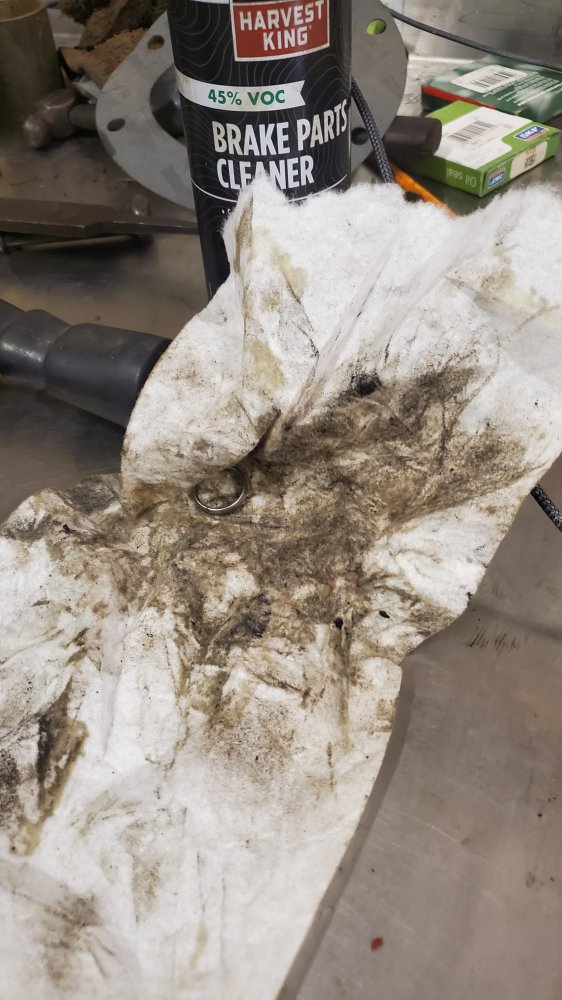

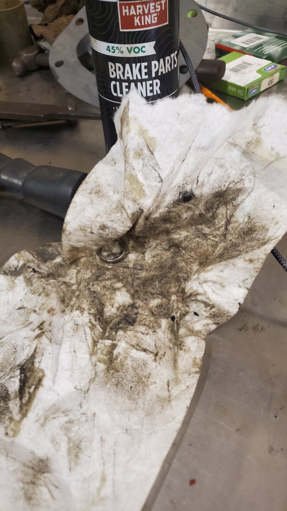

Once I got back to the house and got in the shower I realized at some point I lost my wedding ring. It may be laying down by the handwash station at the shop, but there's a really good chance its laying it the bottom of this D300 from when I dropped an intermediate gear thrust washer and had to fish it out from the bottom of the gear oil filled case
