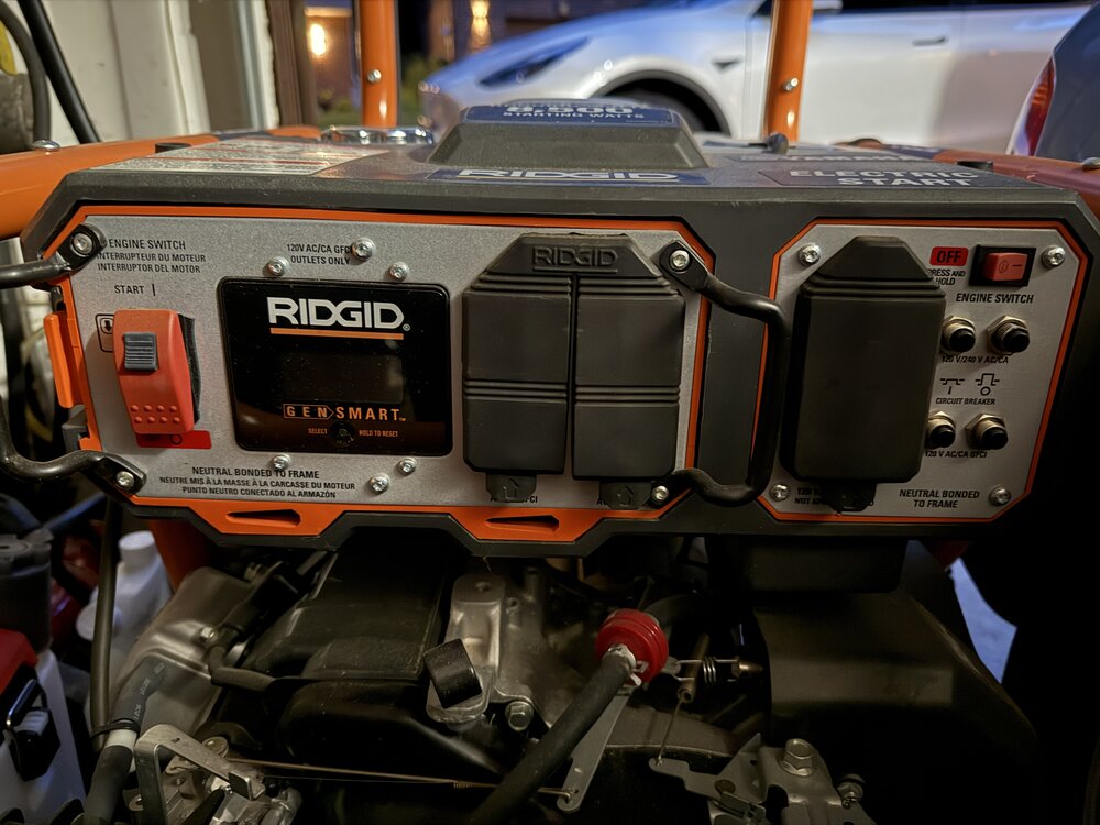

Y’all know anything about it? I’ve never cared to learn about generators
I'm pretty sure you pour some gas in that thing on the left, then press the button. It makes some noise then if you flip open those black cover thingies you'll find electricity. :D

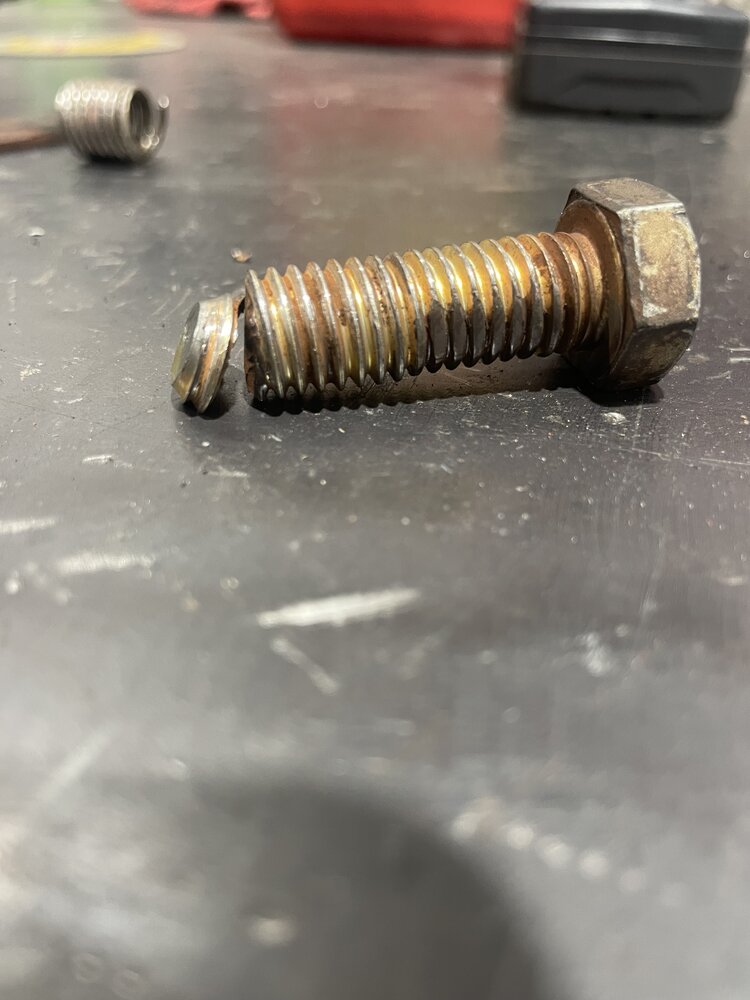

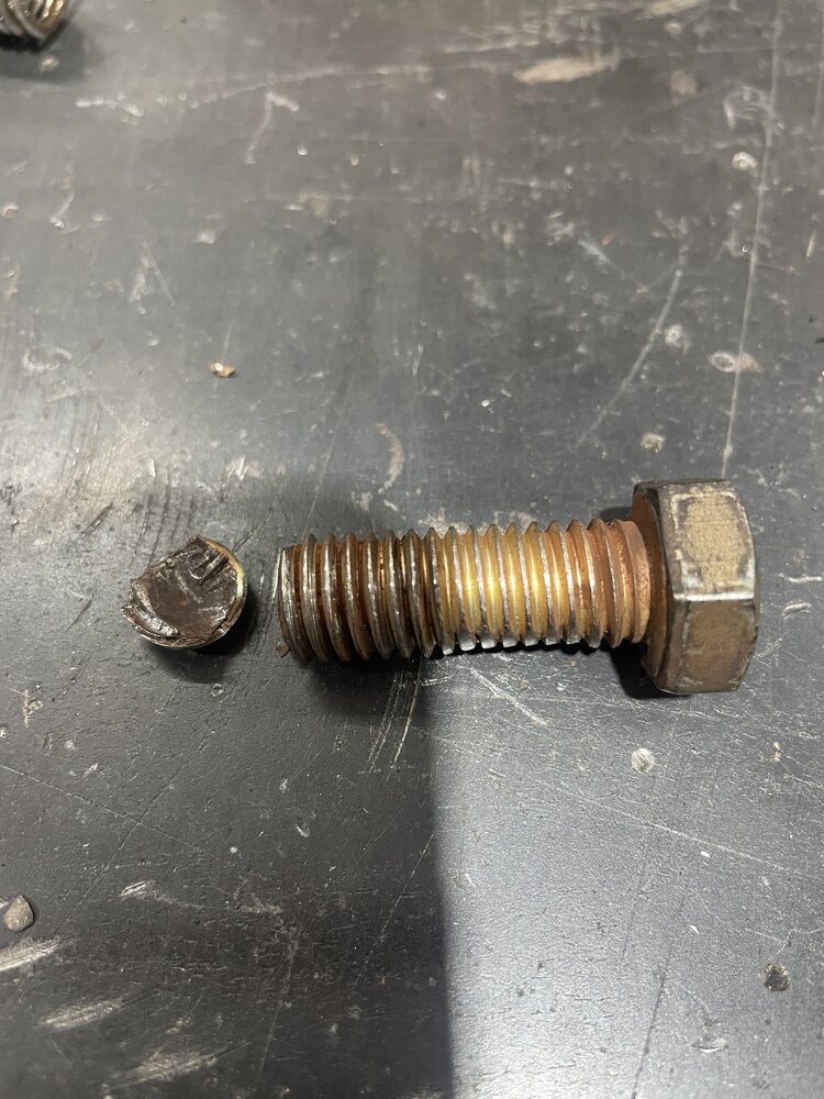

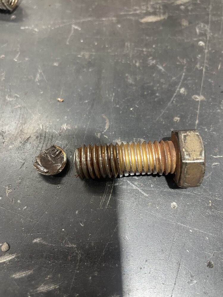

Yall ever seen a bolt fail like this? Customer said bolt broke off in the hole. Could move the piece with your finger tip. Turned it maybe half a turn and it came out. Don’t really know how that would happen
Needed more thread engagement, needs a longer bolt.
Or at least thats what I've been told by people who have trouble with short bolts.
What was it holding together? I assume it was in a firetruck somewhere.
Looks like a material defect at time of manufacture. If the bolt had complete metal through the shank, there's no way you could get enough thread engagement to do that.
