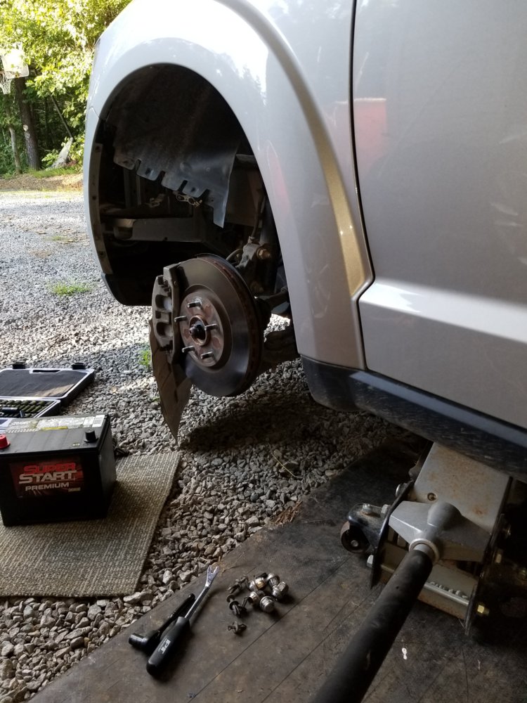

Hold on a minute, let me get a floor jack and a lug wrench View attachment 275432 and I'll change your battery.
The wife had an Intrepid that was like that. Also had to remove the windshield wipers to change the cam sensor. That is true

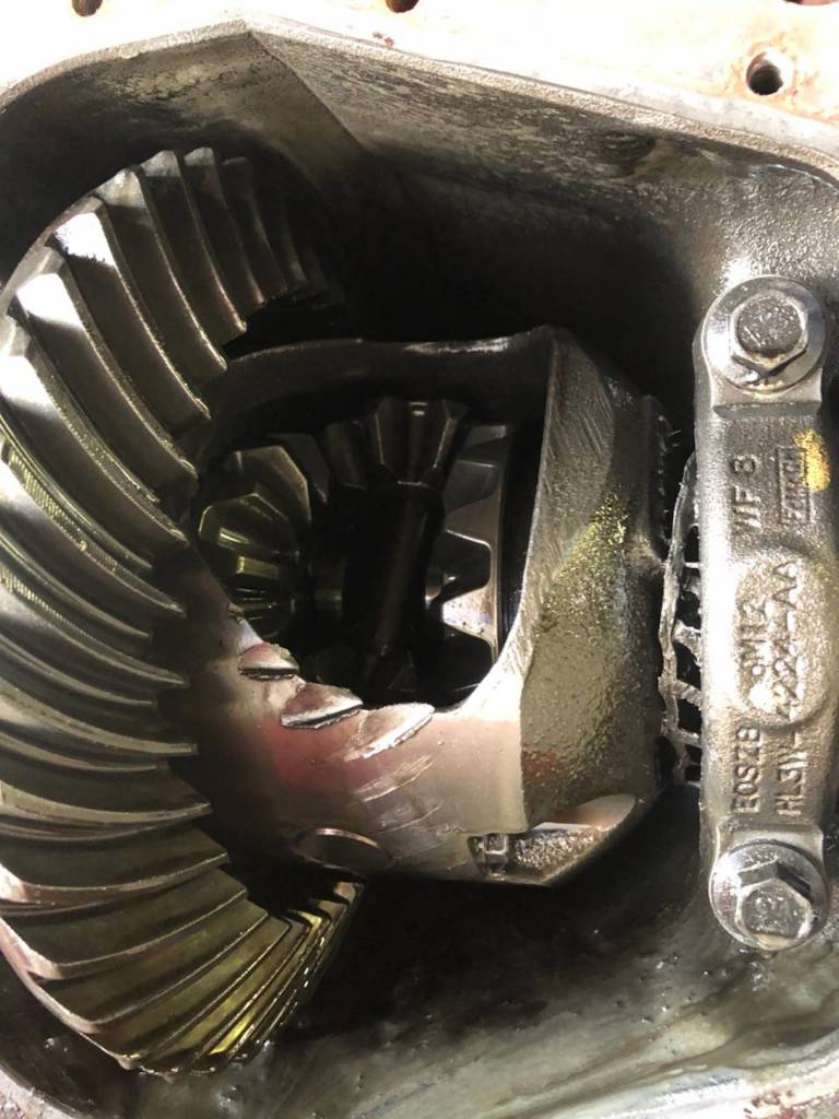

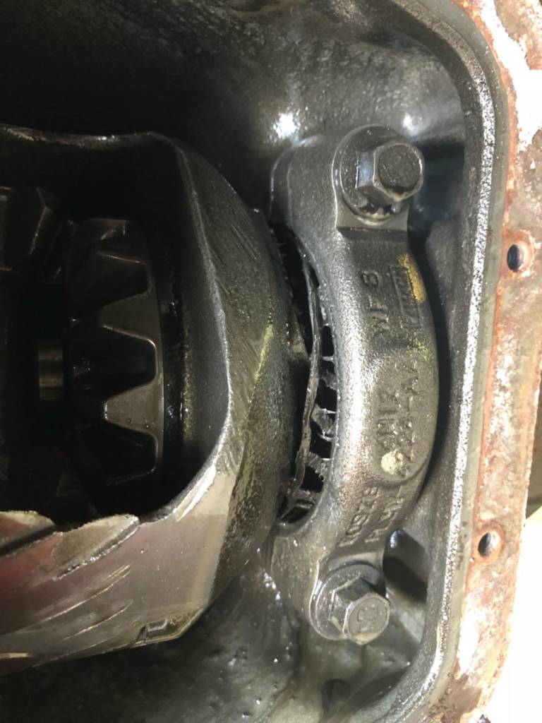

It's hard to say what causes that sort of failure. A tweaked housing could wreck a carrier bearing but you'd have to assume the axle bearing would be trashed too.
Maybe overloaded enough to catastrophically fail the bearing?
Either way, unless the dealer has a means of measuring for a straight housing, and assuming the journals aren't fubar, I'd damand a new one as well
My money is on an assembly line guy that was mad at his supervisor. "I'll show him...."
