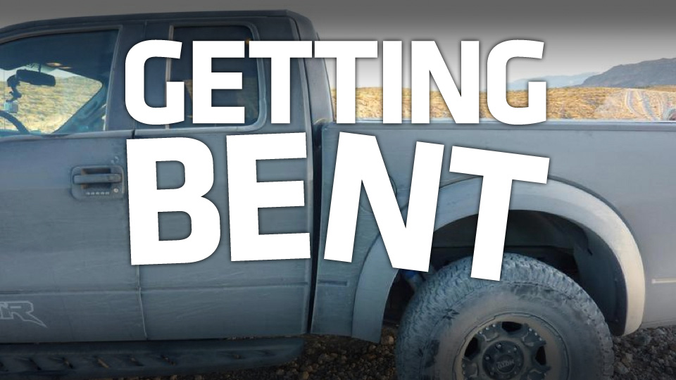

Raptors... frames too weak for offroading?
Yup, they didn't continue the boxed frame over the rear bumpstop. Easy to prevent but hard to fix.
I'm having a tough time figuring out how this happened. Was it high centered? I'd think it would bend the other way if it were from jumping the truck.
If you could see a picture of the frame it's pretty obvious. Rear bumper, bed weight, spare tire weight hanging off the rear of the frame, gets thinner just above the bump stop. A hard impact at that point combined with all that weight over hanging having momentum in the opposite direction is the cause. LOL at the caption under this picture.

Here's the thing, though....
The guy posted video of the incident.
And... they were moving pretty good. And hit a couple of BIG kickers... by their own estimate, 12-18" high.
Now... what do you think would happen if you were rolling down the interstate at 70mph and hit a 12" high speedbump? Think it would fawk some shit up? Imagine that. :rolleyes:
Threads like that are what's wrong w/America. Duder wrecked his truck. He needs to suck it up and pay to get it fixed. Ford might have done better with the bump placement, but then something else would have broken... probably the housing.

After reading the text of this guy describing what happened, one could be swayed into thinking he may have a point. After watching the video, he come's off as a whiny little bitch.
He jumped his truck and landed on the face of the next hill instead of the back side of it. Had he cleared the hill the impact may not have even been hard enough to bend anything.
Regardless, if you take your truck offroad at 70+ mph over whoops and jumps and ANYTHING happens to it, expecting the dealer/manufacturer to pay for it is absurd.

I haven't spent much time in the desert, but I've spent enough to know that it's unpredictable and unforgiving. Some pretty innocuous-seeming shit can ruin your day in a hurry. I saw a post yesterday where an engineer did some rough numbers on the "speedbump" kicker. Said that a 12" high kicker at 70mph was equivalent to dropping the truck from 60+ ft in the air.
