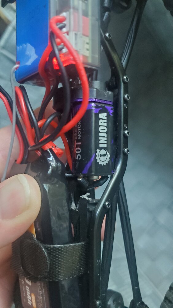

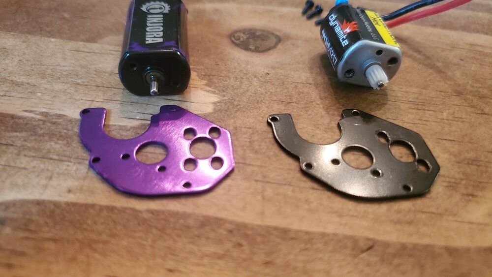

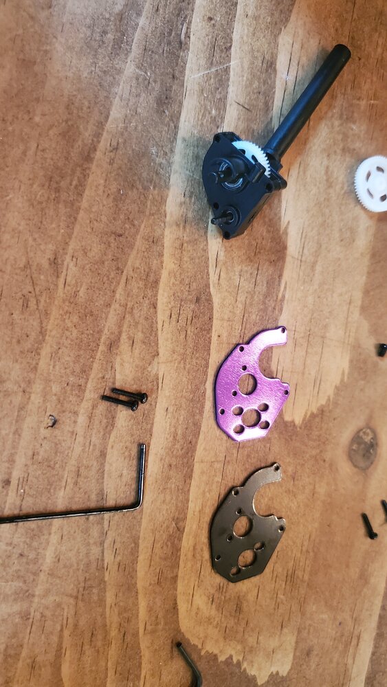

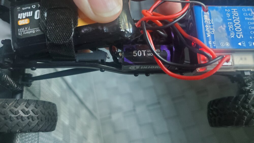

Motor #5 of 6 just died on yellow JLU. Gladiator (motor death #4) now has the Injora 50T Pro in it. Easy install with a little trimming and patience dealing with 1mm allen wrench for about a dozen screws. It's about 10-15% slower top speed, but way more torque, especially down at lower rpms, which makes for better control.
I'm really not impressed with the stock motors, but everything else is performing great and holding up ok (so far). To be fair to the stock motors, then are mostly run on 1000mah 35c batteries instead of the stock 350mah 30c. But 2s with the same voltage, and they are never getting hot.

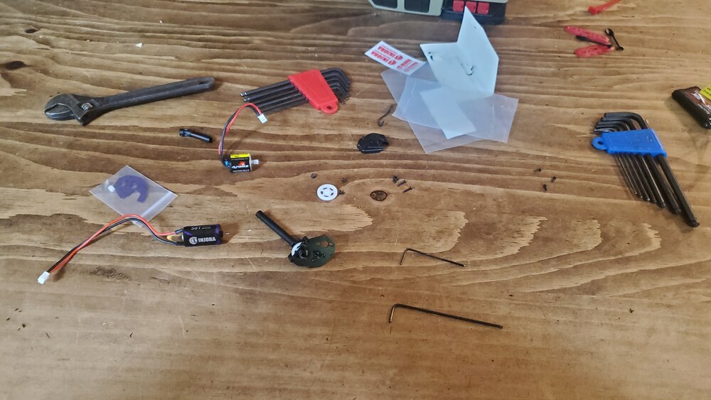

This is my biggest complaint with the scx24. My damn gorilla fingers have a hard time working on them. I picked up these and it made it a little easier, but it still sucks.

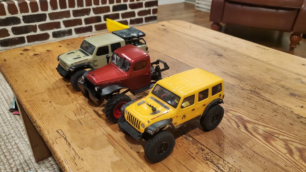

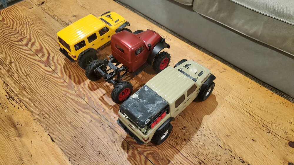

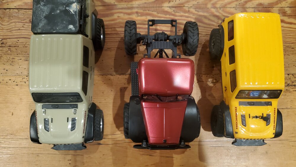

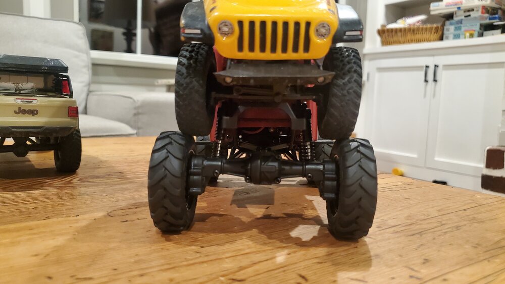

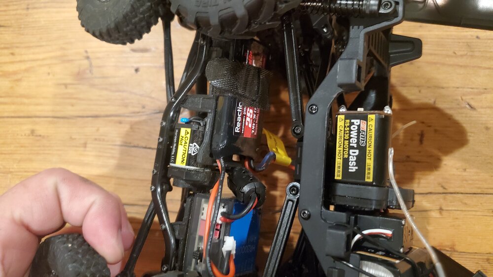

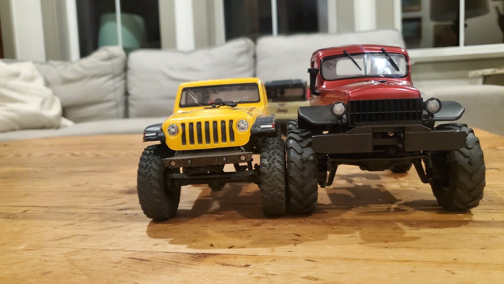

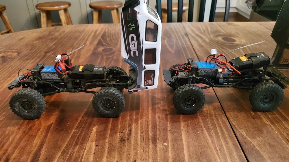

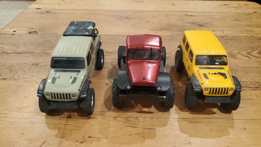

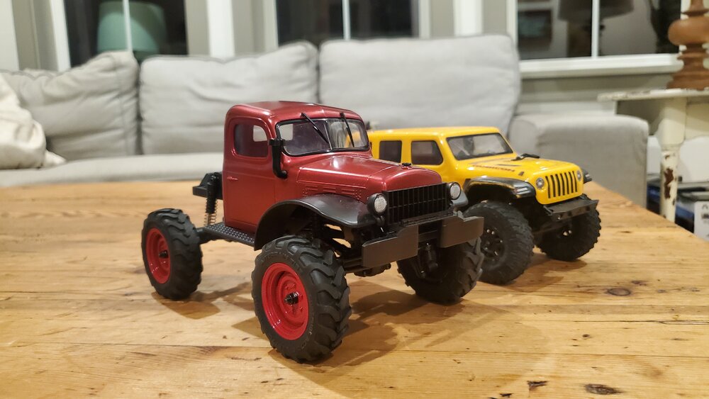

FCX24 showed up this evening. Definitely seems a little bigger, more like 1:20 scale or so. It's quite a bit wider and taller. Length and wheelbase are about the same.
Obviously the angle on the last pic exaggerates the difference, but I think it captures the size difference better than the other pics.

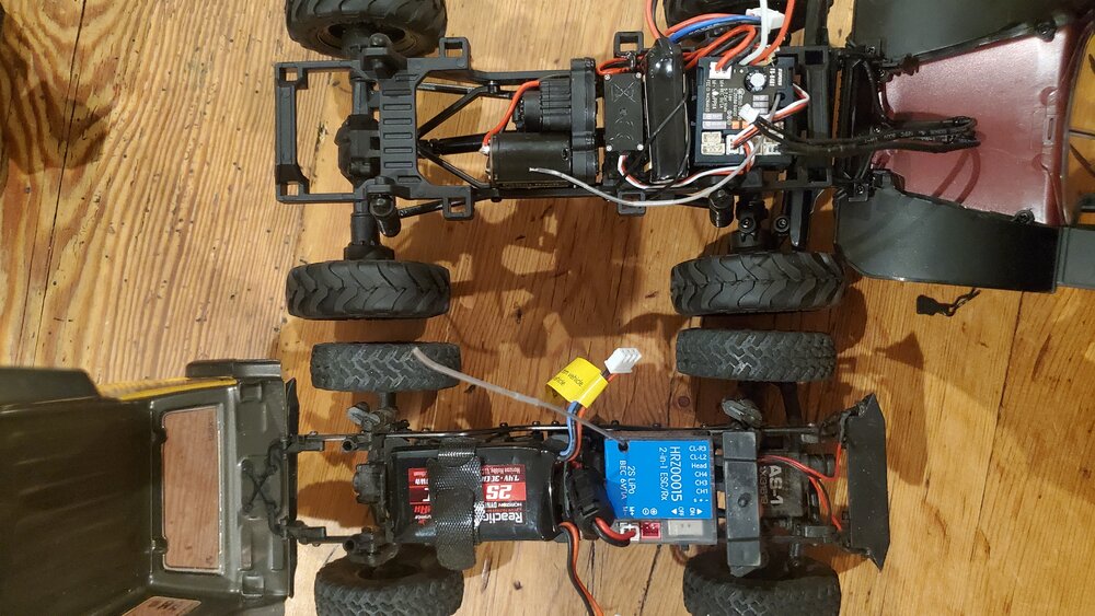

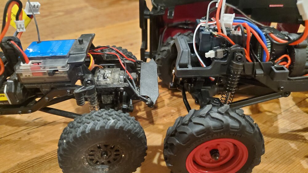

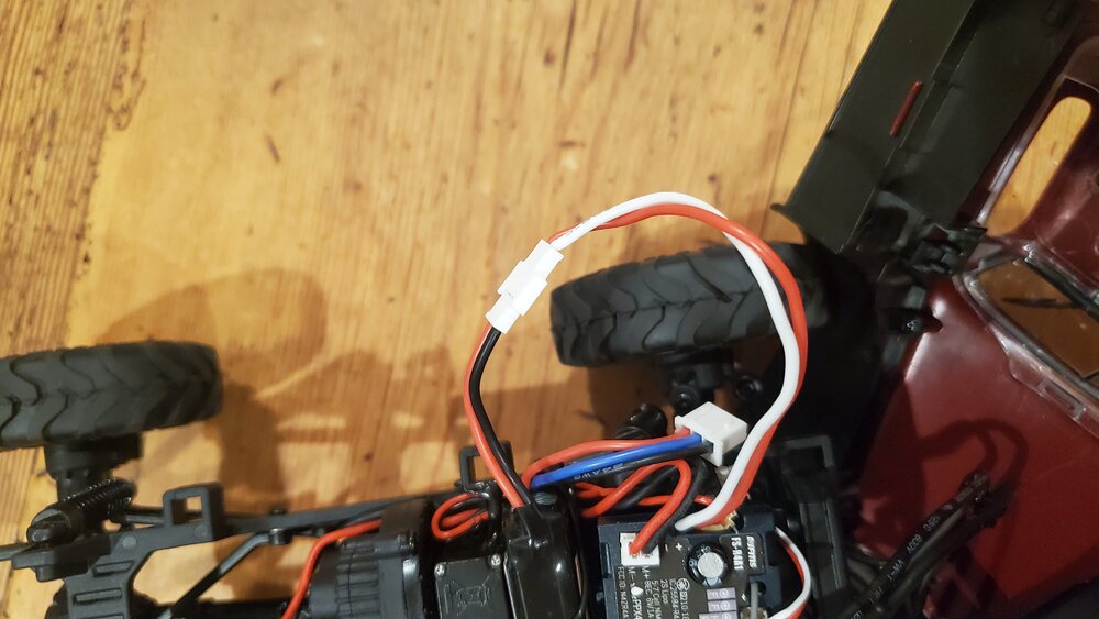

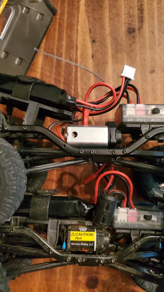

The specs are good, but im less than impressed with some of the details and build quality. Blue ESC is the Axial SCX, black ESC is the FMS FCX. Dang thing is just plain crooked.

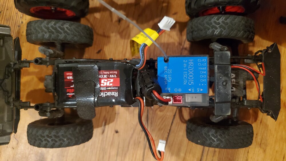

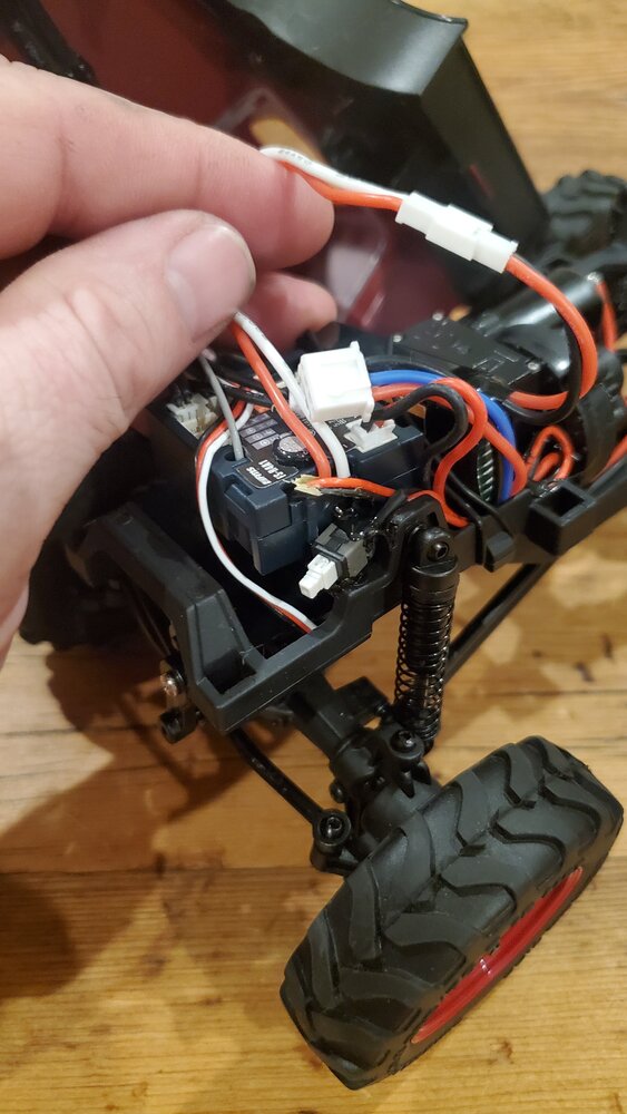

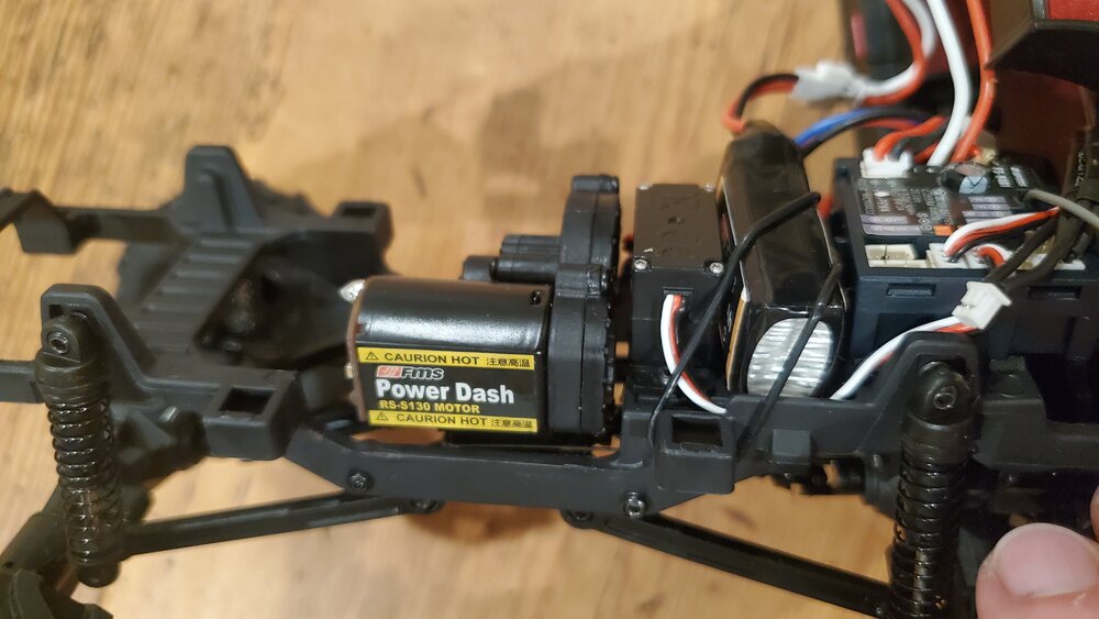

The way the battery is secured is a joke. There are hooks on either side of the battery tray, and an o-ring stretches across the battery. As if that weren't janky enough, the battery lays vertically on its side, so it's impossible to keep the oring across the top. I swapped it from the hook over to the body mount so it would at least function, but it will be replaced with some different method.
The ESC has a lead for the battery, so it's nice and easy to plug/unplug, and doesn't put wear and tear on the ESC pins and force you to pull on the wire to unplug it.

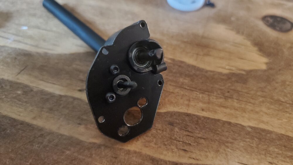

The motor is waaay bigger.

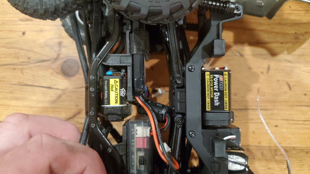

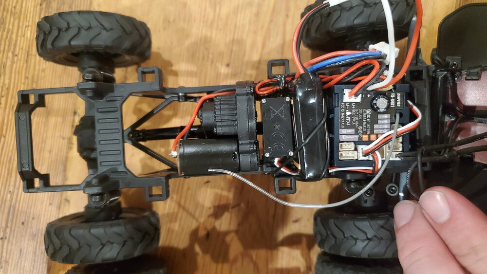

A couple underbody shots
The on/off switch is a pushy-clicky type, which is fine, but looks like a poorly positioned like an afterthought. Kind of hard to get to with the body on.
Shocks/springs are much bigger with more travel and a bigger diameter shaft.
Also, the body kind of snaps on and off. Time will tell how well that holds up and how easy it is to use. The velcro on the Axial SCX24 Gladiator only made it a week before the adhesive unadhered, so it will probably be better than that.

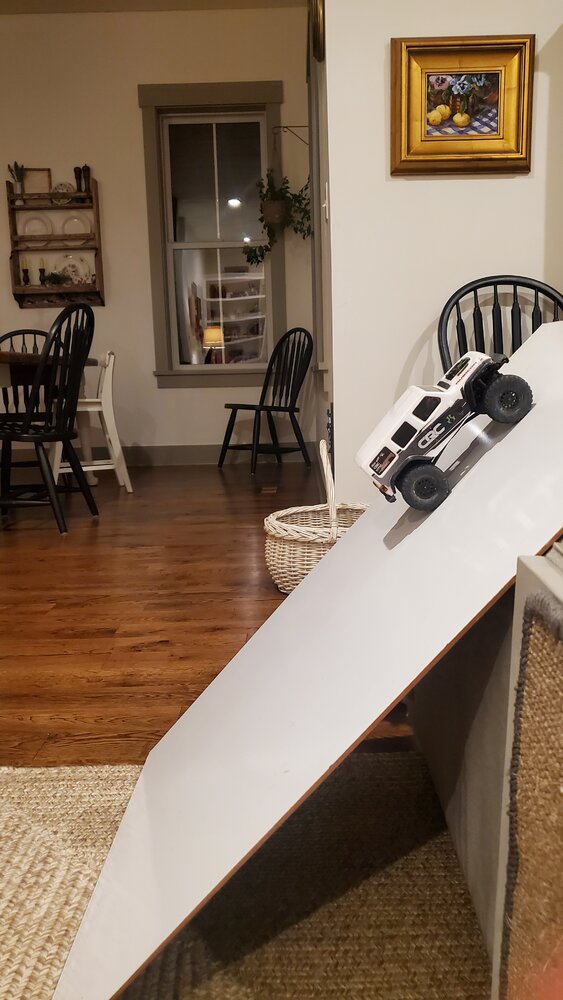

Didn't have time to get outside, but did some couch crawling and data gathering.
Wide open Low range on the FCX is about 15% slower than the SCX. High is WAY faster. It will do wheelies and stoppies (and flip itself over).

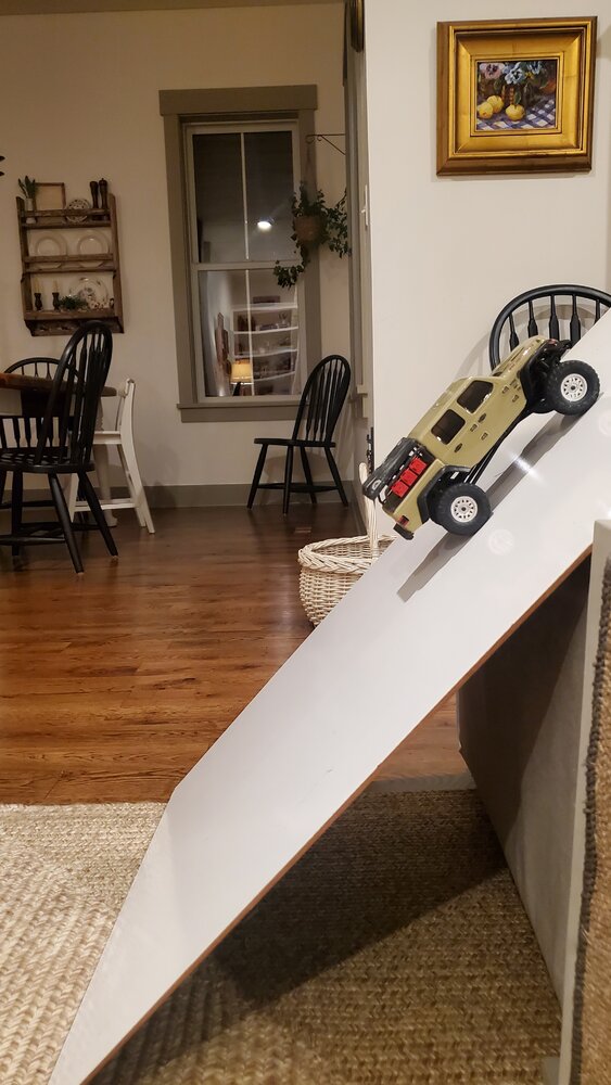

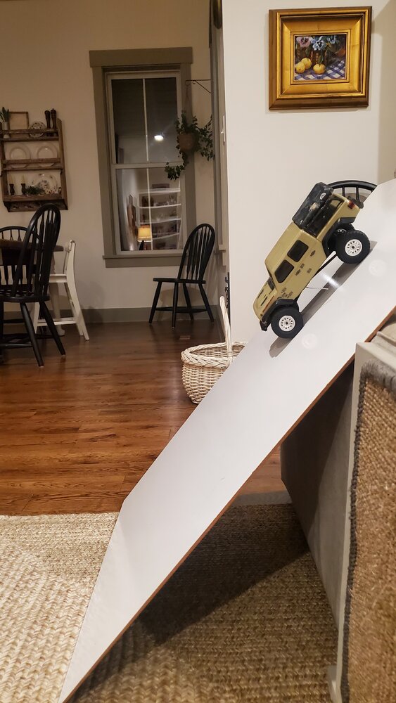

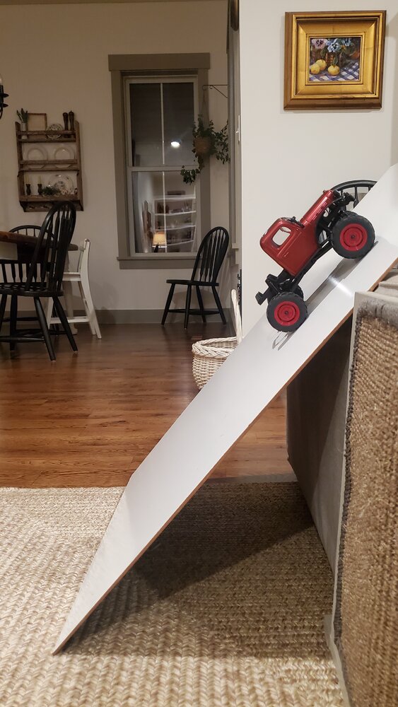

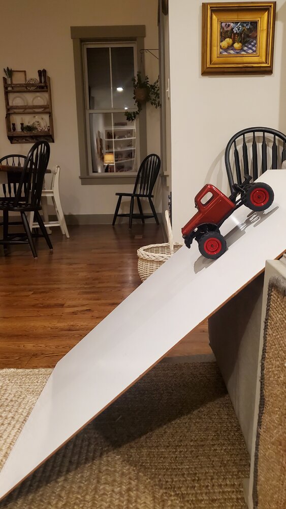

Then I did some max climbing angle testing. :D
SCX Gladiator 45deg Fwd, 56deg Rev
SCX JLU 46F, 47R
FCX Powerwagon 51F, 42R
The JLU was nicely balanced.
The Gladiator was decent going forward, but RIDICULOUS going backwards. 56 degrees climbing angle!
The forward climbing of the Powerwagon was excellent, but going downhill it flips over far too easily. Needs a little popsicle stick flatbed to balance it out a bit. :D

Stock SCX24 is still my favorite crawler. The Injora 50T Pro motor swap in the Gladiator has gained some speed now that it's broken in, and is on par with the speed of the stock SCX. If it holds up, it will probably be the ideal combo. Great, controllable torque down low, and enough speed to not be a downgrade from stock.

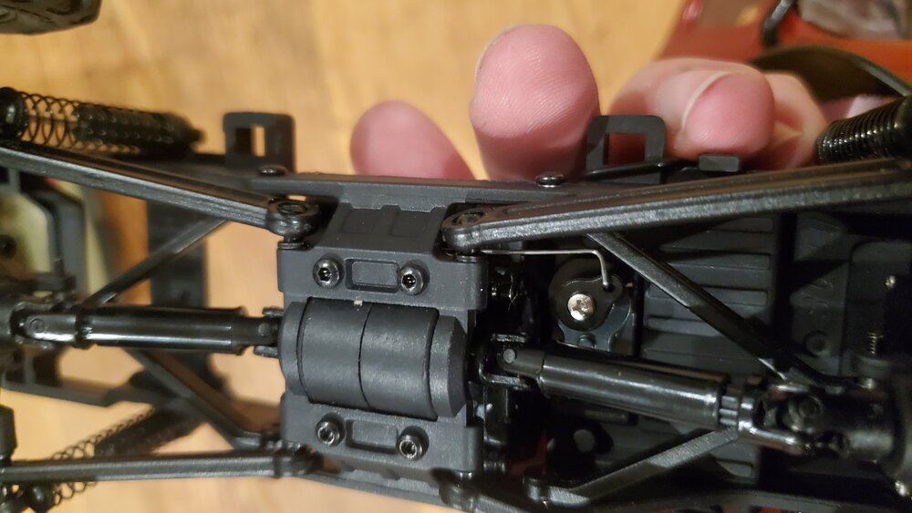

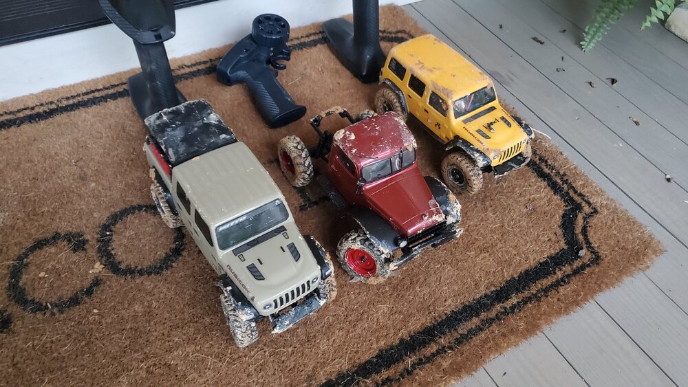

Took em out for a flogging this afternoon and came back covered in mud and broke :laughing: Two driveshafts and a portal. Just u-joints popped off on the SCX's (snapped back on). The FCX24 seems to have stripped a gear in the left front portal. So it took 2 days to break it :rolleyes: The chevron tires did best in the mud today, but aren't as good on the rocks. Also, the FCX is way too top heavy. The extra width is better, but overall balance is poor.
But the kids had a great time flogging em. :D

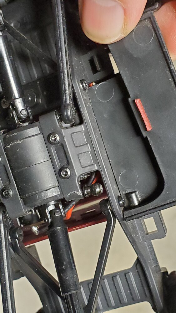

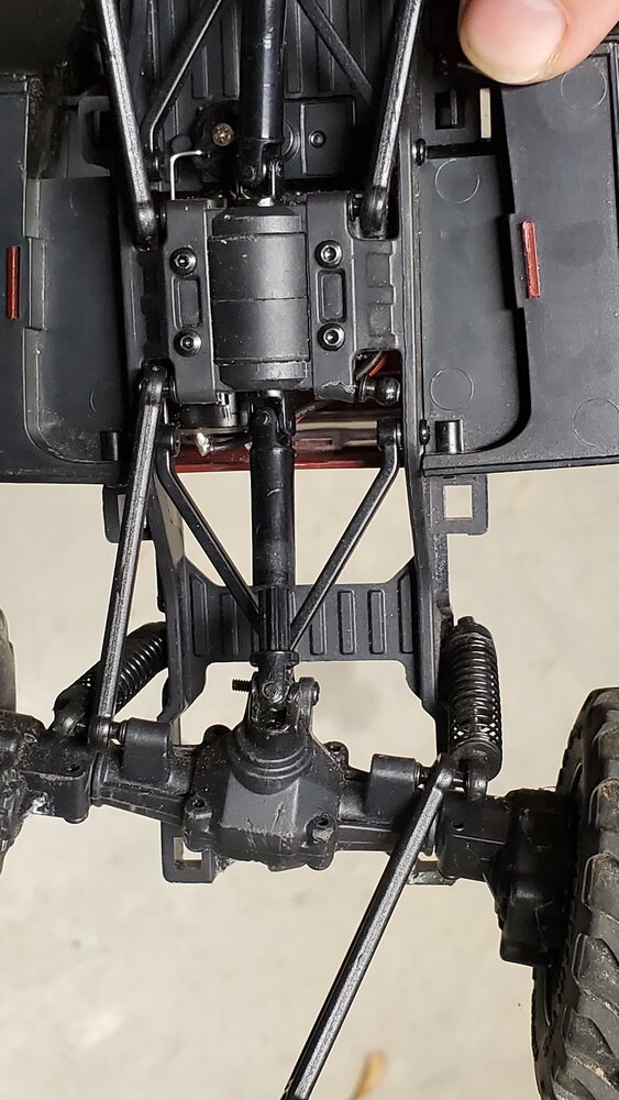

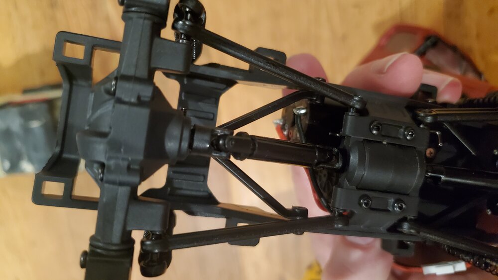

Welp, broke the frame on the FCX Powerwagon. Now it has a stripped portal and a busted frame. :rolleyes:
Not a great design in my opinion. The Axials have a through bolt in double shear, which is probably about 8-10x stronger.
