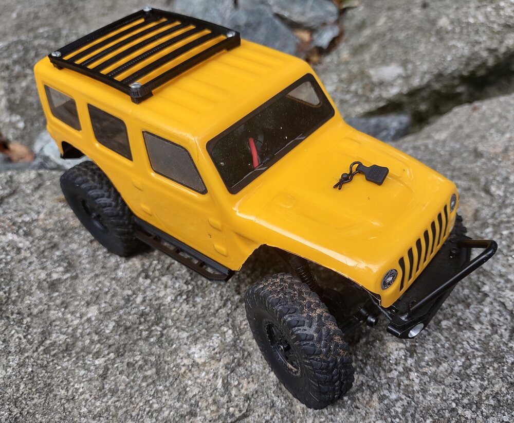

(SOLD) if anyone is on the fence. Aluminum bumper, tire carrier, and 3d printed sliders and roof rack.

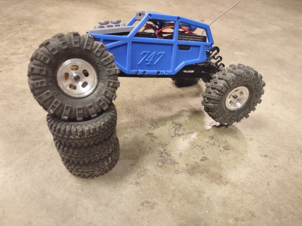

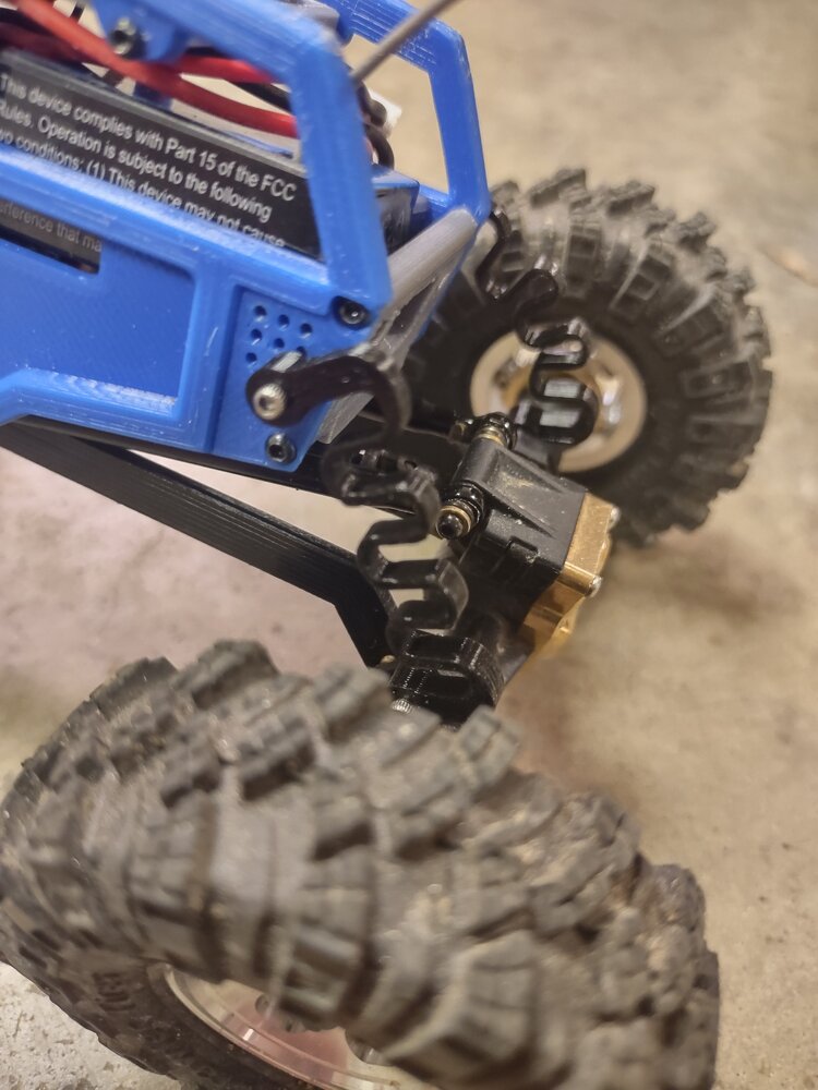

After trying to use some 43mm double barrel shocks for a 'droop' setup and not being pleased because they unload too easily, I decided to print some 'shocks'. I printed these out of PLA+ and they performed fair, but I broke one of them force flexing it. I am going to try to print them out of ABS (have never printed anything out of ABS before) and see how they do. But may tweak them some more-thickness, etc. Overall though I was very pleased with the performance over the stock shocks. Too much articulation is a bad thing on these it seems.

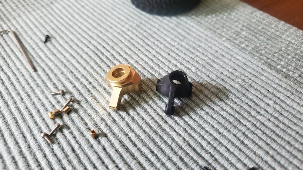

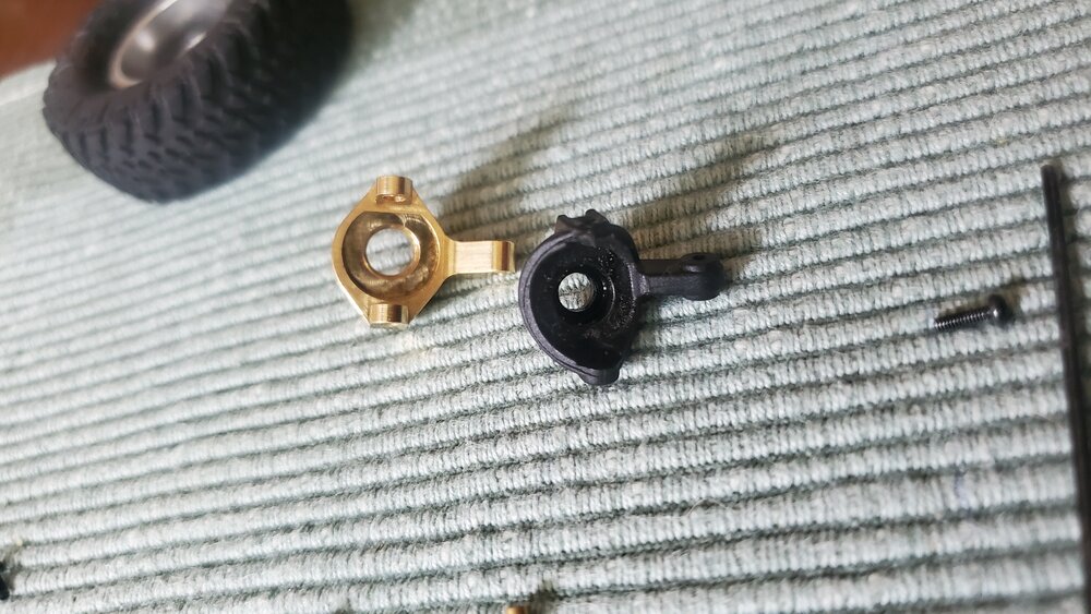

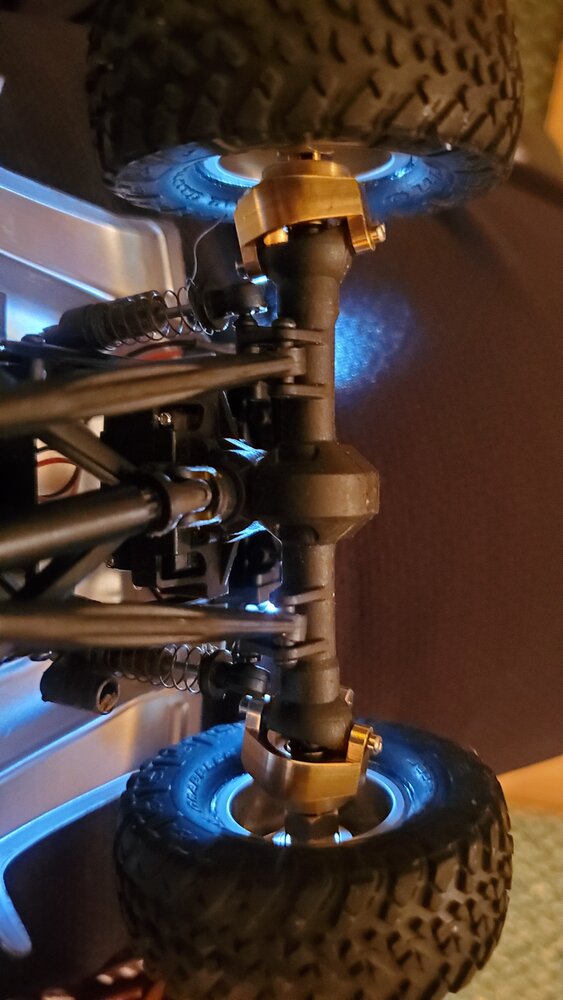

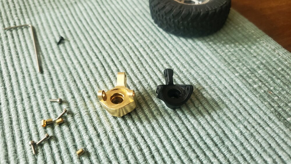

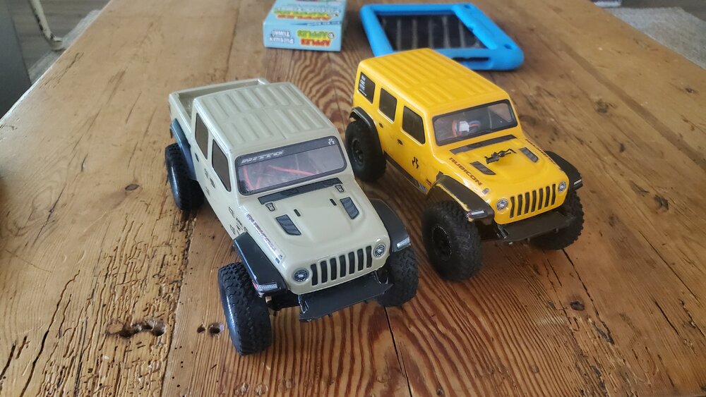

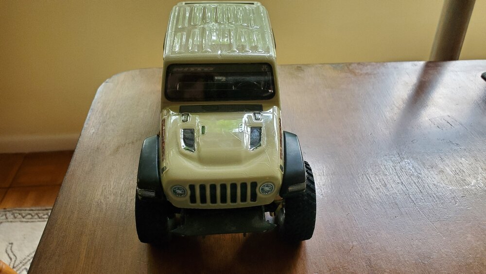

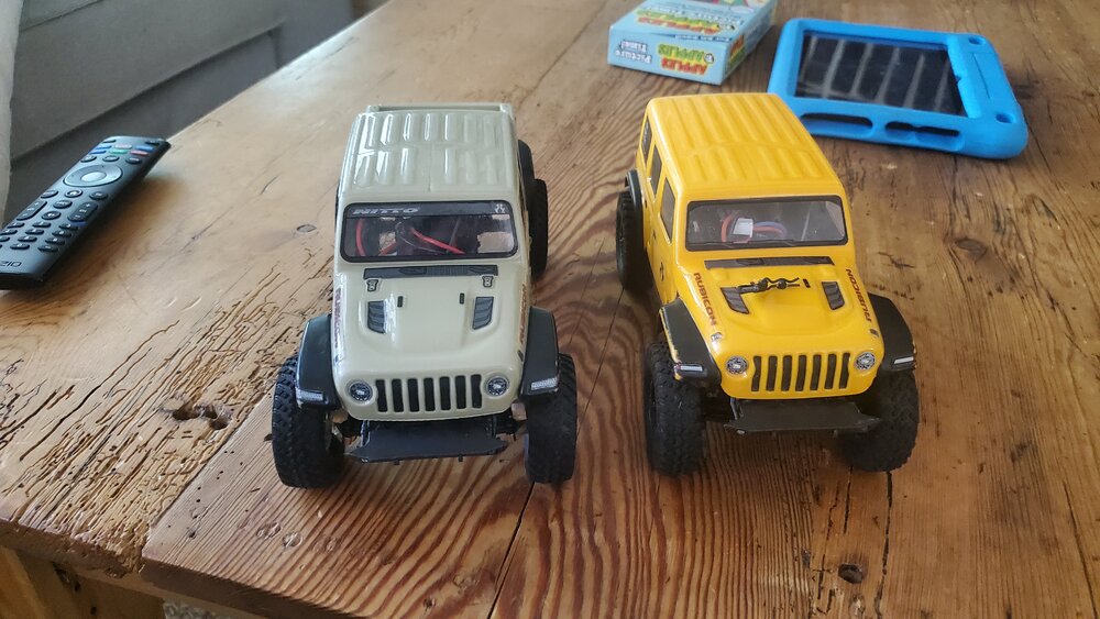

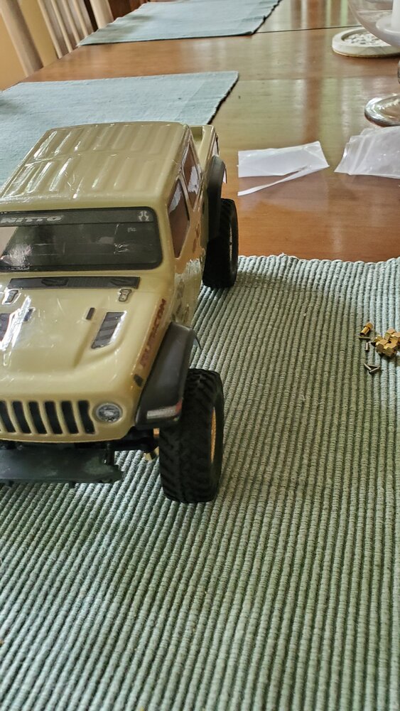

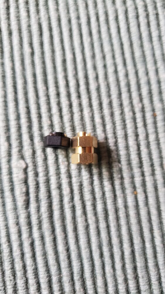

Broke a knuckle on the Gladiator. Got a brass set from Amazon that works great. Also came with 7mm brass wheel spacers. Put all that on and now the Gladiator looks right. Steering servo is definitely the weak point now, but its still working. The Injora 50t motor let out its final smoke, BUT that is because the controller batteries were dying and my 3 year old left it on all night and it sat there humming at very light throttle all night with no motion. I gave em a pass on that and ordered another.
Also broke a front axleshaft on the Gladiator. Got the RCAWD CVD shafts. They are a little tight on the length and seem to cause some binding. Hopefully they loosen up over time.
You can see the stance on the left front compared to the rear of the Gladiator.

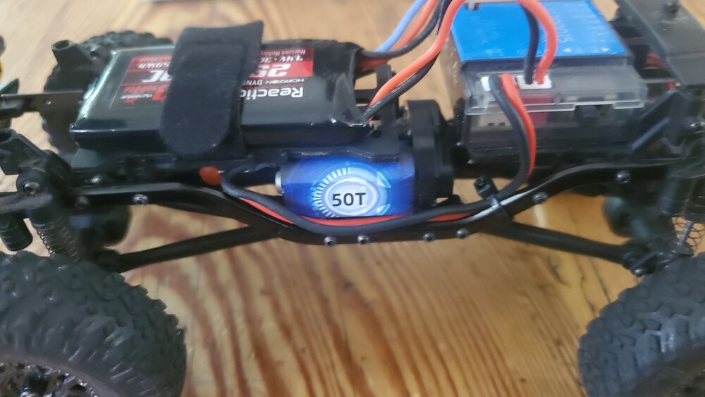

The "drone racing motor" for the Yellow jeep is still going strong, but I got tired of popping off u joints on the driveshafts. Bought some steel driveshafts, but they have a poor design and aren't phased right, so instead of breaking other parts, I sent those back and bought a different motor. Also, the drone motor was too loud. The new motor is a Hobbyfans 50T and so far is great. Noticeably faster than stock, but quiet, smooth, and good throttle control. And $12 shipped. Definitely my favorite so far. We will see how long it lasts.

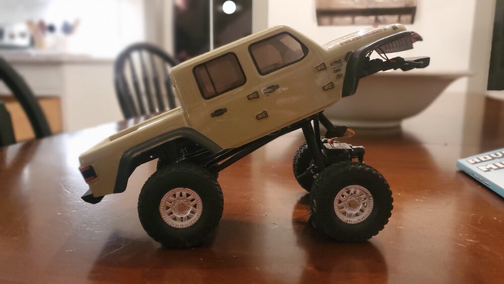

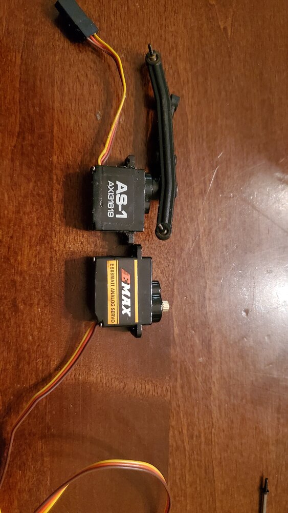

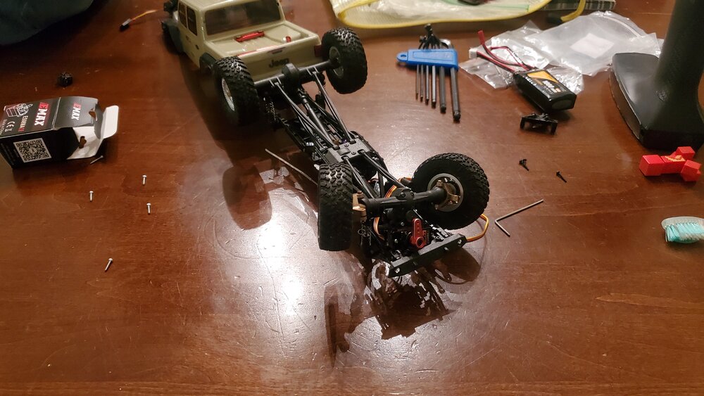

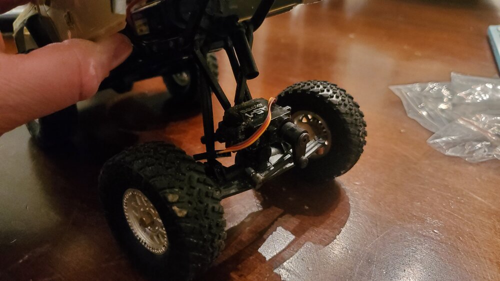

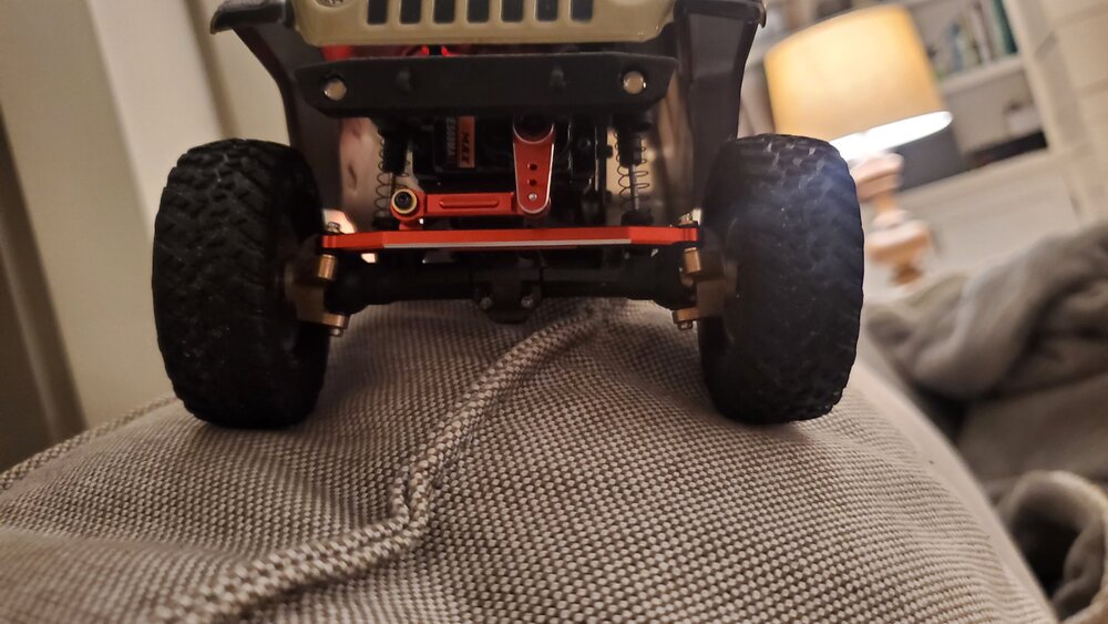

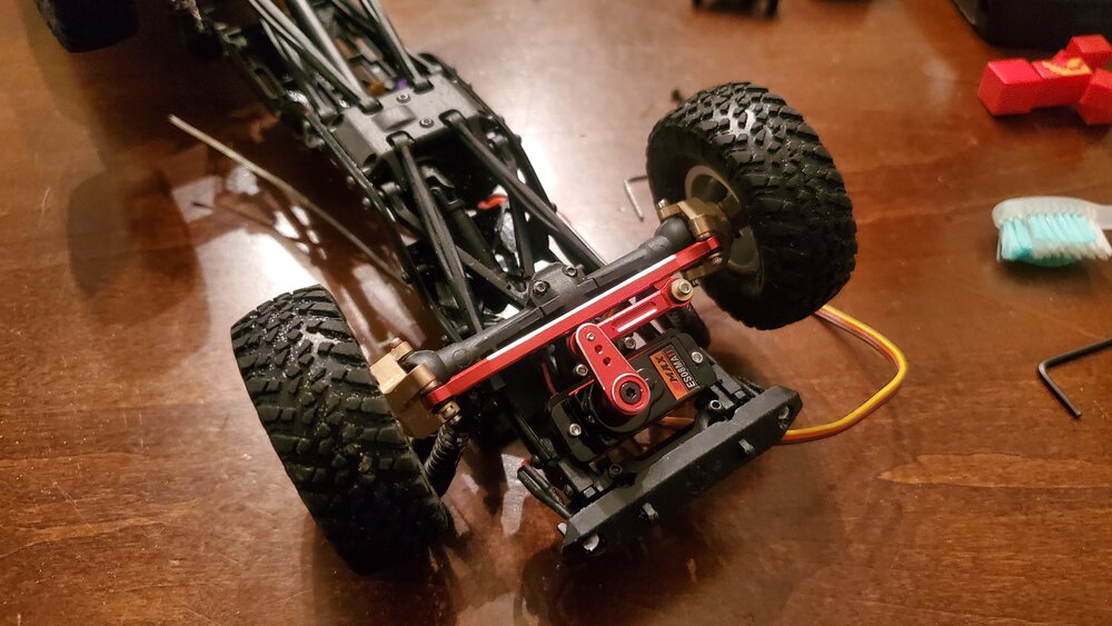

I did 7mm brass spacers and brass knuckles on the SCX24 Gladiator a while back. Made it way more stable, but the stock steering servo was too weak and couldn't steer past 10 or 15 degrees. Finally got around to upgrading the servo and steering.
Huge improvement! With the brass bits, better steering, Injora 50T Pro motor, and slightly longer wheelbase, this Gladiator is by far the best crawler of my 3 and is a blast to drive.
I just ordered u joint axles and the Emax servo for my son's C10. One axle was clicking when binding and the servo and servo saver died a horrible death also.
