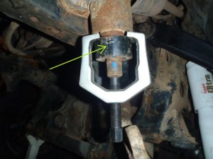

I have removed probably 100 pitman arms that guys say they cant get off, with a hammer and a puller just like yours.
Put the puller on it, get it tight like in your picture and smack it as hard as you can right at the green arrow. Hit it a few times then tighten the puller more. I promise you it will pop right off. It knocks the body of the arm out of shape just enough to pop it off.

Well I finally got it off. Used a combo of all the methods above... ground a big chunk out of it, heated it, pounded it... did like stated above, tightened it, whacked it, tightened some more... it finally started to slide off.
I'm pretty sure it was the extra cusin' that did it. It was really loud that time.

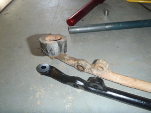

Here's a flavor of how the thing looked once off, you can see the chunk I cut out of it.

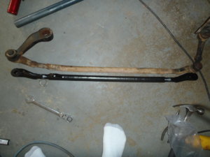

Also, the reason for all this, nice and bent relay rod. Pre-89, the old ones before the recall, guess that beats snapping.
