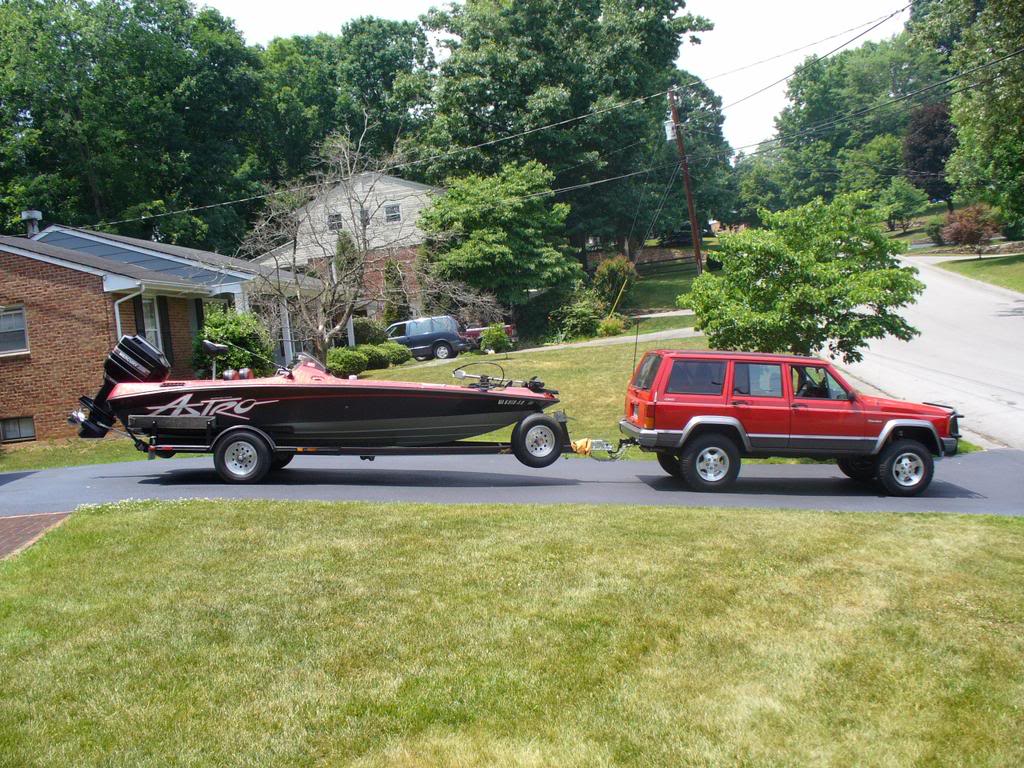

I own 6 XJ's and it always amazed me that Jeep/Chrysler rated the 4.0/AW4 equipped XJ at 5,000. The XJ is a tough little vehicle but 3,000 is scarey at best, I know, I towed a full decked out 19' bass boat with mine weekly and that boat was pushing 3,500 and even with the trailer brakes it was too much for the XJ to handle safely.

Not sure what you're implying. I wouldn't say it's "maxed out", but its not the kind of load you casually tow around with no real change in driving style either.
