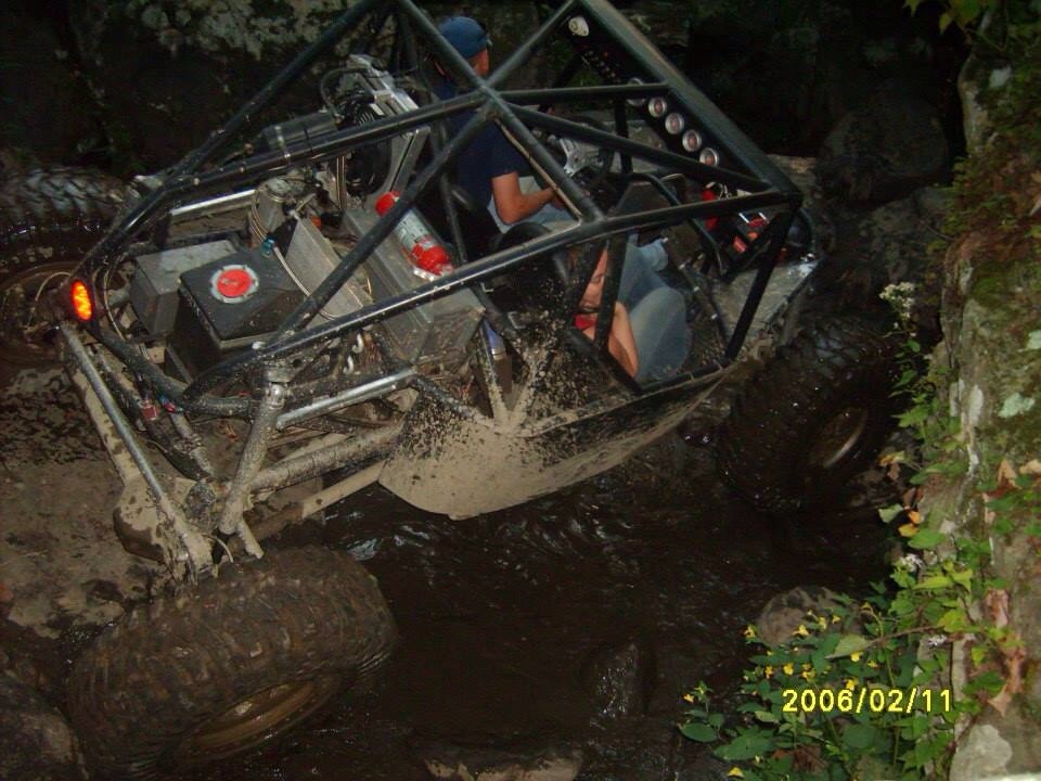

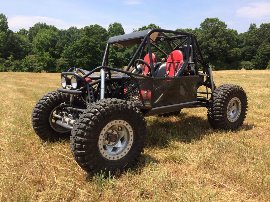

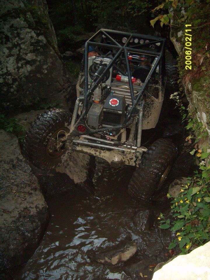

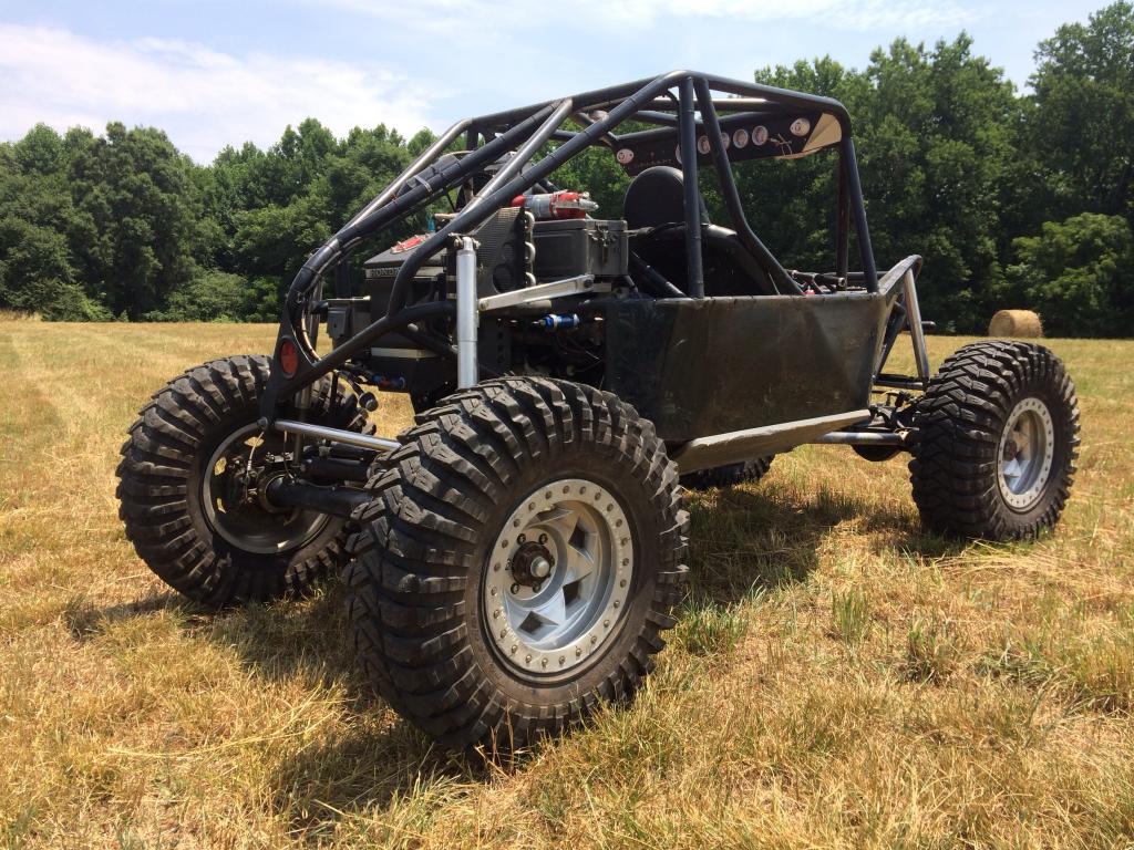

Here are a few pics of my Honda buggy I had.
And as mentioned, everything was behind the seats, the transmission was right between the seats. And my feet were basically directly over the front axle. The engine was far enough forward to not be over the rear axle, so it was almost setup more like a mid-engine.
Well I did some digging and for where it was for sale on pirate a while ago. It has a centered front 60 and a 10.25 rear.(assuming both have been flipped and possibly narrowed) trying to get some more pictures of it as it is. If I end up getting it the front will probably get changed around to be more like your buggy. I saw its for sale add a while ago. May try to copy some things on it.
