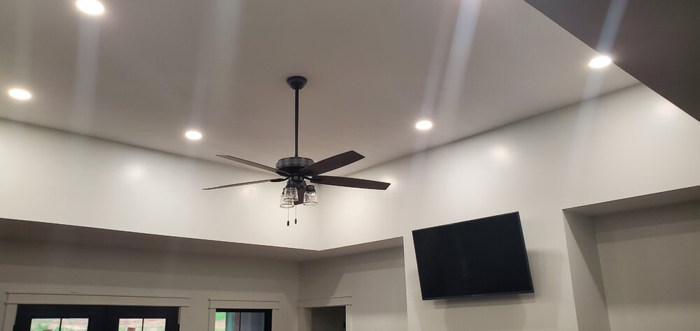

12’ ceilings…you can see the shadowing. Shadows stop somewhere around the 9’ mark. Also have to be aware of tv glares. And because I’m a piece of shit that can never remember what kind of bulbs I have, different warmths and 45w vs 60w…

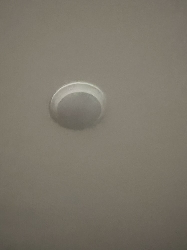

Amazon 6" Dimmable Wafer Lights
We installed 8 of these style lights in our kitchen and 4 in our den, all on dimmers. We use them every day and you can dial it up to super bright, or dim them down to very little light output. They're wafers (only 1/2" thick I think), so you can put them anywhere you want (like under/spanning a joist) and the spring loaded arms hold them up with no issues.
I put some just like that in our patio ceiling at our old place. They were so light that I was able to hang them in a viny ceiling without any extra bracing with zero deflection. My wife and I loved them
I like wafer thin style as well. Selectable color range, led, and as already mentioned, thin enough to install over a joist if that's where layout lands(still may be tricky to get the box up in the ceiling with sheetrock up ) I believe the shadowing is less than a traditional recessed light as well......but Im not well versed in the science of Interior illumination.

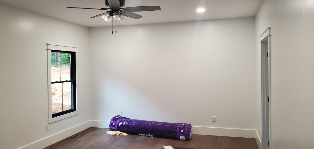

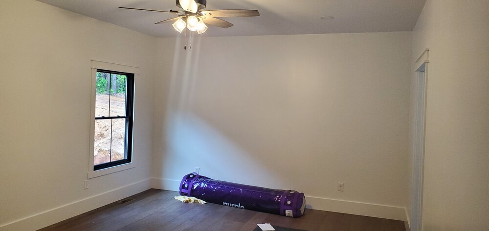

12' ceiling 16x16 area, 8 lights 26" off walls.
9' ceiling 14 x 18 room, 4 lights 44" off walls
Same room with just fan light on
Glare is the difference between the brightest thing you can see and the darkest. Your pupils inhibit you from being able to distinguish how objectively bright or dark something is. Recessing the lens makes it less likely for you to see the light source when looking across the room.

Finally! Someone said it! Get the thin LED ones and skip the “cans” all together. They are only 1/2” thick and you don’t have to avoid ceiling joists because they are the thickness of your GYP board.
If you like the traditional off white color, there is a color selection for that as well as the white colors. Pretty affordable when you buy in bulk.
