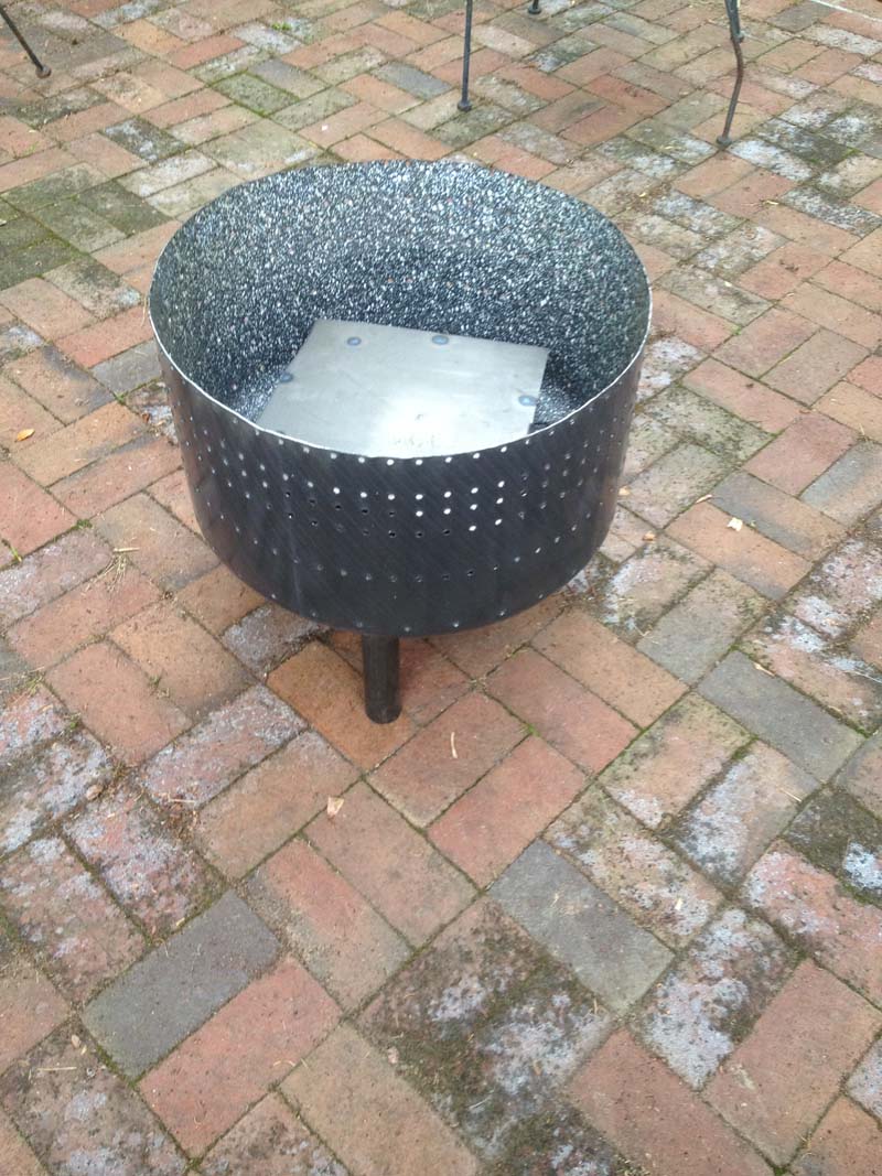

saw a few of these out at KOH so had to make one for myself.
tore the wash machine apart and used the drum. cut off the weighted top ring, welded some legs to the bottom, welded some rolled expanded metal to inside bottom and then a flat plate on top of that.. so air can come in from the bottom to help keep the fire going..

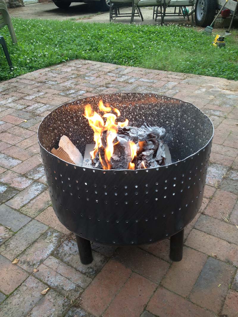

First fire lasted 2 hrs without me touching it and it even started to drizzle on it.. not bad for a small little fire..
next is to plasma some cool words around the sides :)
