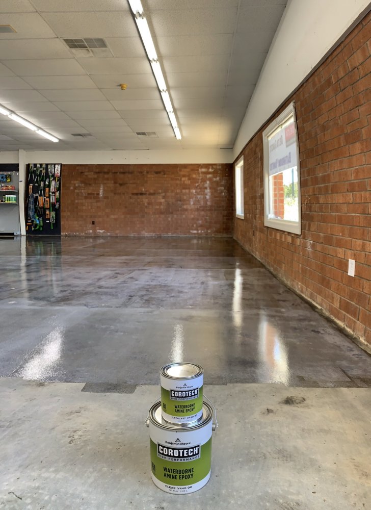

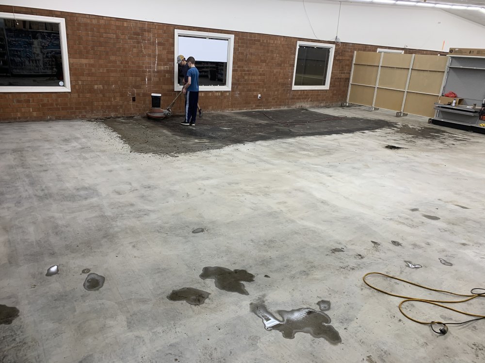

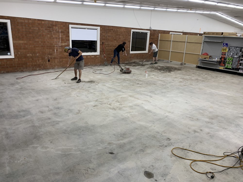

Home Depot rents the diamond bladed grinding head and floor buffer you need to do this. It’s about $125 a day and will clear about 100 sf per hour. You won’t have much dust as you have to keep the floor damp for it to work properly. I used my own buffer and a spray bottle , but they rent a buffer that has a built in water tank.
Once you’re done with the grinding you will need to mop several times to get the floor clean enough to apply your desired finish. We used V440 Benjamin Moore two part epoxy at our store and it has held up well to commercial foot traffic so far.

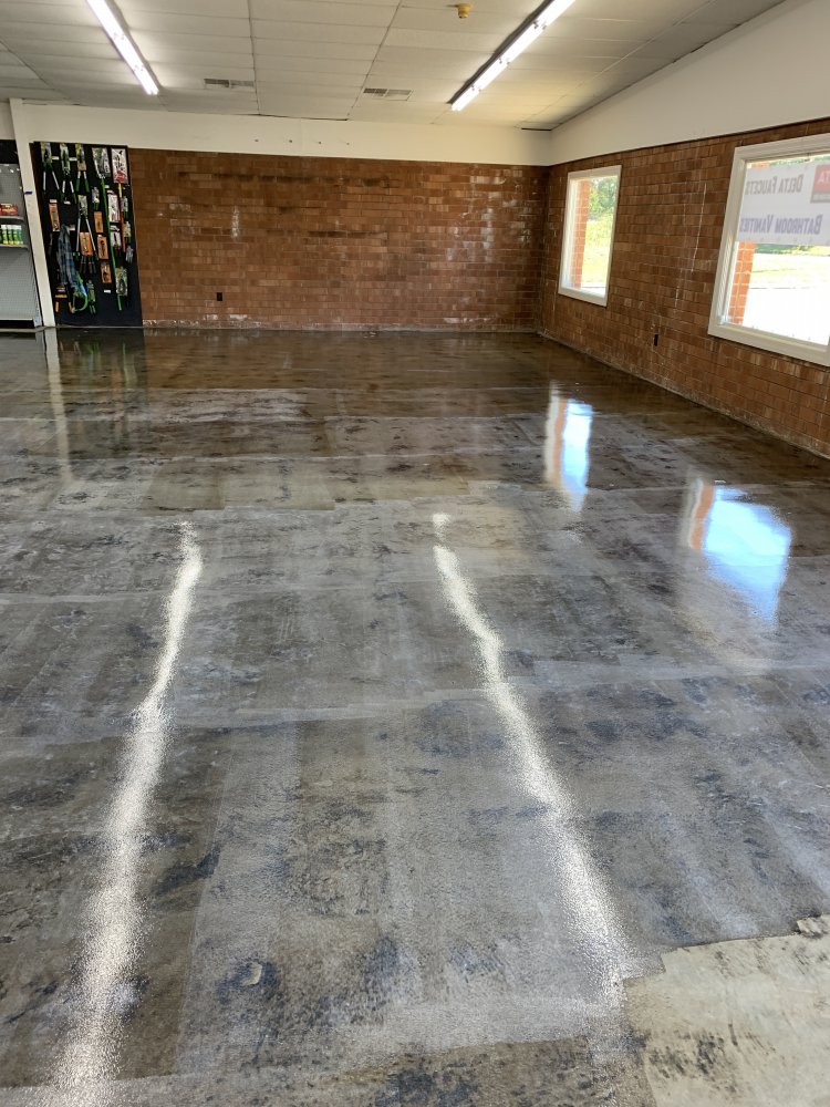

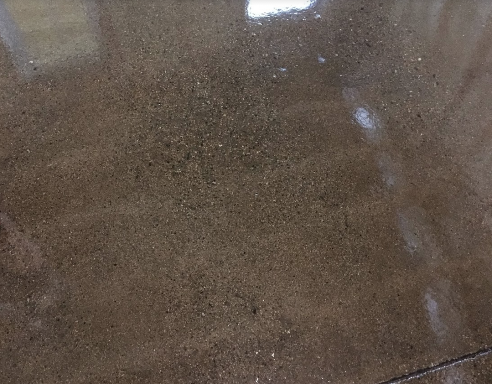

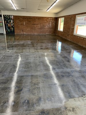

I can do a square foot in 1-1.5 min. That's taking off adhesive and a dirty top layer down to brand new looking concrete. It looks so good me just may end up using a high gloss clear sealer on it.

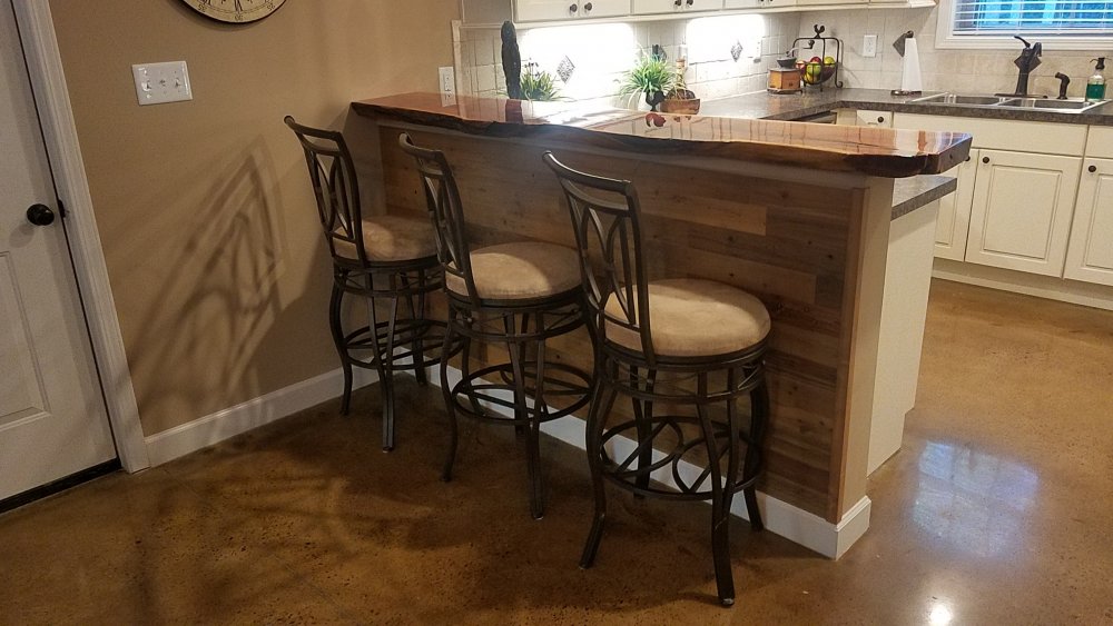

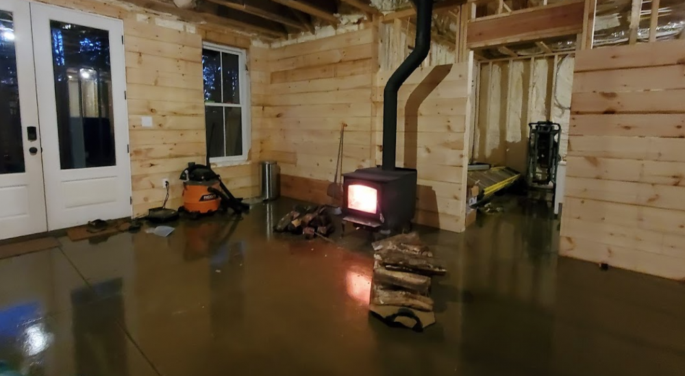

You should come check out my basement. Ground, stained, and clearcoated. Also, I fully agree with @CasterTroy about it not being worth the effort.
Your glue may come up quicker from the sounds of how the hand grinder is working for you.

It's actually not going that bad doing it the hard way. I have a while to do this since this is just a side project at the house. 10-15 min here and there and it'll be knocked out long before my june deadline.
