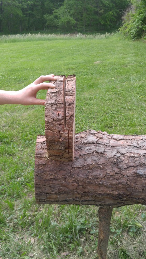

Well second sharpening results:
First diving cut from first sharpening ever with the Super Jolly.

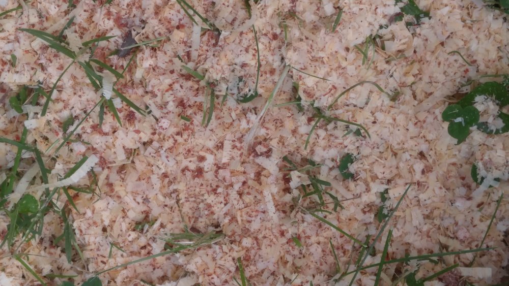

The full cut was the second attempt. Noticeably straighter. And the shavings pile was better. Granted its pine.
Made a pass with the grinder on the rounded tooth profile. Made sure to make a crisp point. 10 thousandth of an inch to get it clean. Upon switching the vise angle I notice a large amount would be needed to be removed if left at its current setting.
Rather than take the plunge I backed it out and crept up on the cut. Using dail calipers I made a pass or two til it measured like the opposing side.
I didn't take readings of each tooth or average them this go around. The cut is much better.
For a few chains I will continue this method of tooth length measuring while grinding. I have read this was an issue on a few other models so it's worth noting and keeping an eye out for it.
