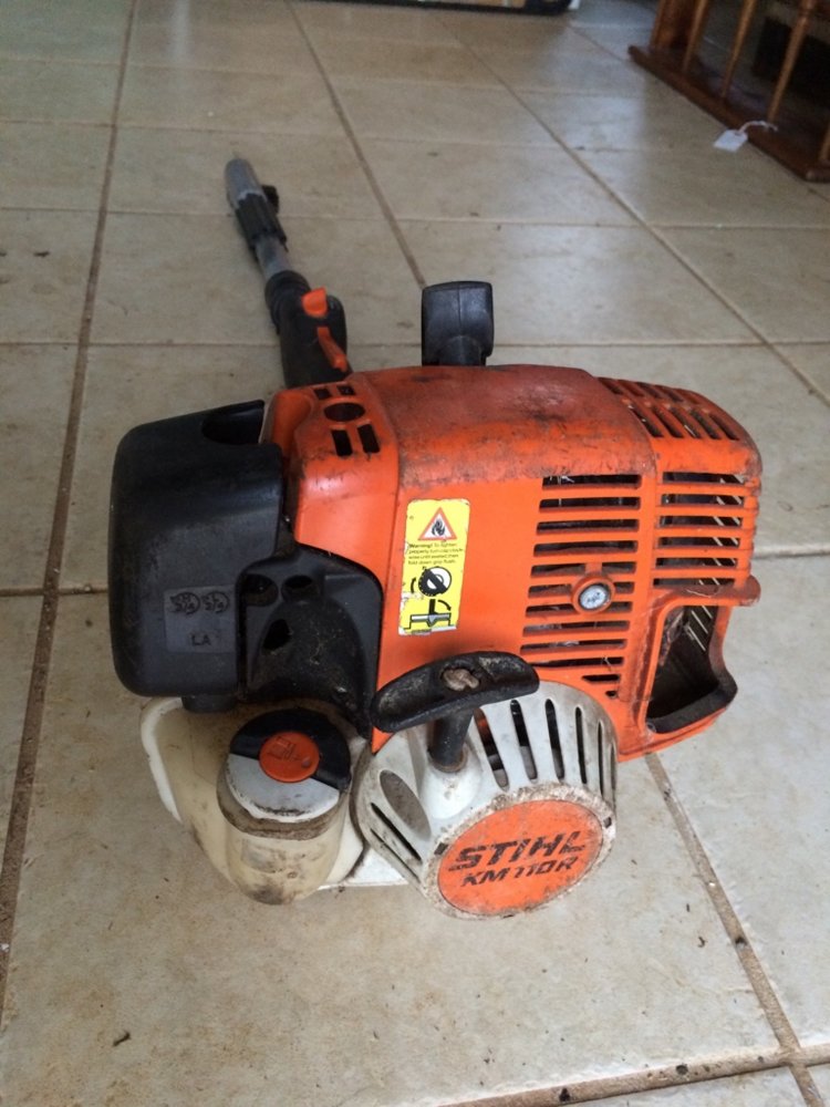

Added bonus today, scored a free Stihl Kombi power head! Pretty sure it'll run if the internals aren't toast. Appears the carb is gummed up and someone gave up on it.

On that KM110R, a new carb is fairly inexpensive (about $35-40) in comparison to the headache of rebuilding and tuning it right. Those 4-Mix engines are damn good, just be sure to keep the valves in check. Most Stihl dealers offer a valve service kit, which consists of a cover gasket and the feeler gauge that's necessary to fit their rocker design, for just a few bucks.

Ya, I saw the carbs on ebay for $38. Seeing as the throttle palte on this one was pretty corroded, I figured $40 in on this commercial grade wasn't too damn bad. Wish I had access to a spare carb just to make sure it runs before putting any money into it. Valve cover was loose, so I think someone had messed around with it at some point. If the condition of the carb is any indication, I'm thinking they didn't have a damn clue what they were doing. hopefully they were just looking around and not messing with the valves. But over all, aside from being dirty, and the housing being scratched up, it looks like it's in good shape. I can feel compression when I pull the cord.
So on the Stihl Trimmer, Cleaned up the Carb and got the Gunked up throttle mechanism functioning properly. Damn thing was so gummed up it wouldn't move. Opened it up and the internals "look" good. Nice a clean.
Ignition Module is working and I have spark.
fuel bulb is clear and pliable and pumps fine.
not totally certain I have good compression yet. Valves seem a little tight and I'm thinking this is my issue. Suppose to be a 0.001" clearance from what I've found, but I'll get my hands on Stihls Valve adjustment kit and make sure.
Handle controls test out fine with my meter. I get a beep in the off position and nothing in the Run or Start.
But after all that, I can't get a single sputter out of it. Shot some carb cleaner in the air intake and nothing. Either the valves are way out of wack, or they are toast or something in the internals is shot.

Valve clearance should be 0.1mm or 0.004" for any Stihl 4-Mix engine when cold.

Borrowed a string trimmer head for the Stihl Kombi.
Went out to give this thing a run for its money. 1 pull start from cold. Nice! Then the magic started. I quickly learned the difference in a $200 Troy-Bilt 4 stroke trimmer and this Stihl trimmer. This bitch chews through the weeds without slowing down! Also realized I now need to wear long britches and safety glasses[emoji21]
This thing kicks ass!!!
