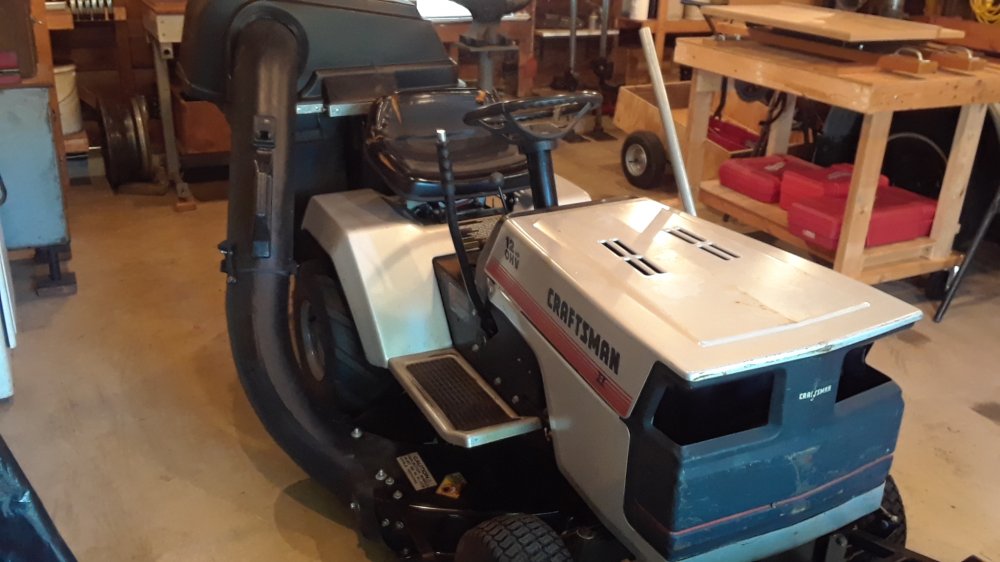

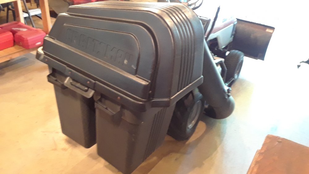

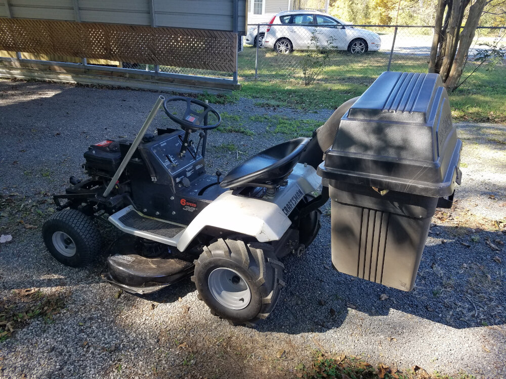

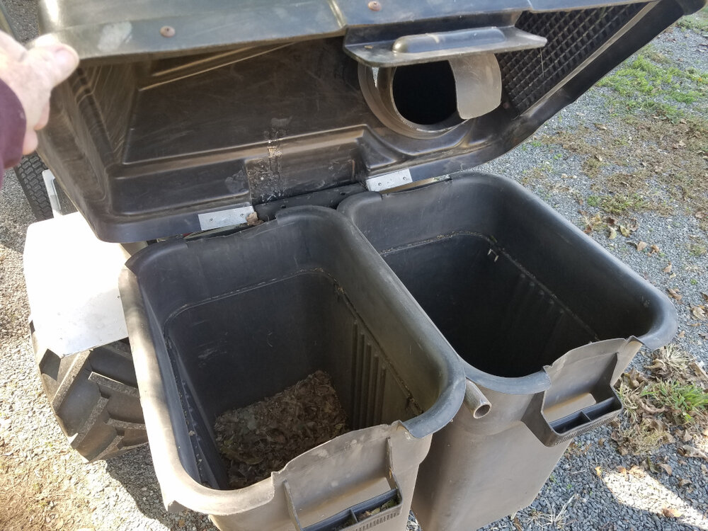

I am happy to say this one is finished. Tried it out today at sucking pecan tassels from the driveway. Considering all the rain we had and how the tassels were packed into the rock the thing did a half decent job. When fall comes I have no doubt that if I can get to the leaves before they get soaked they will pick up well. This has been an interesting project. Many thanks to all who contributed, and commented! :beer::beer::beer:

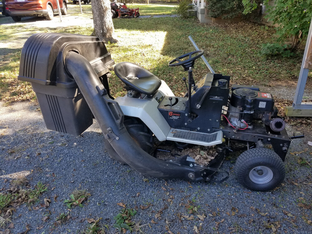

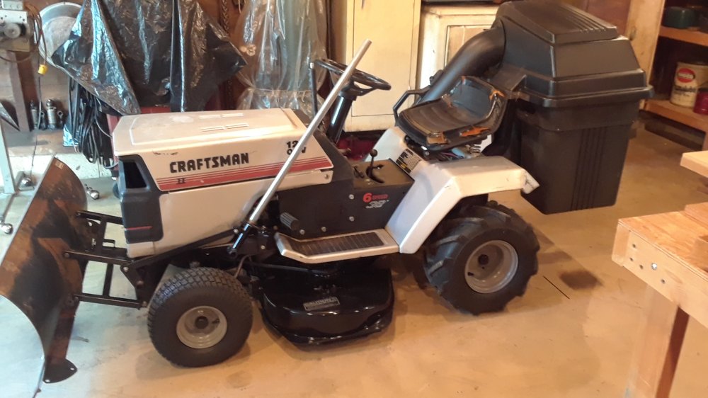

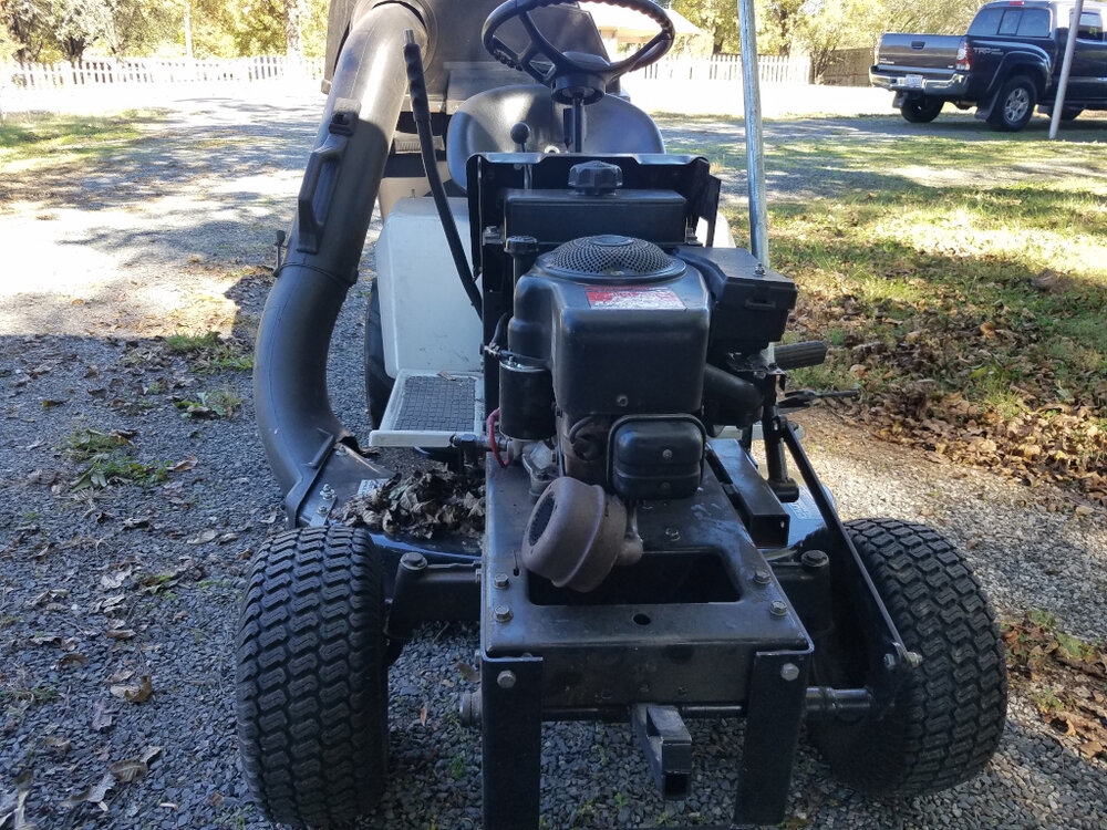

I little update on this old gal... since May 2020 (last couple posts) the deck & collector has been sitting. Recently I finally got a chance to try it out. I had to do a lot of playing with the deck height adjustment to get it right, but it is now picking up the Pecan leaves for me and saving me hours of raking and leaf blowing. The area between the house, garage and carport is like a box and I can't simply grind them up with the zero-turn so for the past few years the rake and leaf blower has been the go-to. Thankfully those days are now over. I did have to make a modification to the exhaust system. It was pointed straight down. I doubt I need explain what that does to leaves. It is now pointed up and out the side and no longer blow the leaves out from in front of the deck. In a nutshell... works like a charm! :)
Thought I should add... the local scrap yard is now in possession of the fancy hood. It was more trouble than it was worth. :poop:
