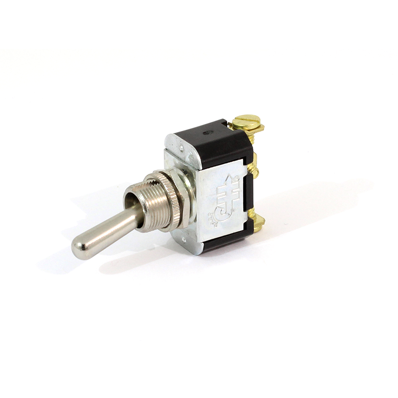

I've used both. I use the conturas where there's already a bracket or something to mount them. Toggles are easier to mount (drill a hole), and will look more appropriate in a CJ, IMHO. I'd say the conturas are less likely to be bumped, but the fact of the matter is that if you bump them, they're going to switch. You might bump a toggle, but they have enough of a positive engagement to keep them from flipping inadvertently.
I prefer the contura rockers, plus they are sealed and water resistant I believe. A regular metal toggle isn't without a rubber boot.
The Carling switches do take a little more effort to install since you can't drill a square hole LOL. Though they do make panels for them.
I just bought two from otrattw.net for the fuel pump and oil cooler fan in my Fairlane. They were Carling contura v switches, and they came with backlit rockers where the actual symbol lights up instead of the blue window like the one above, and the symbols are laser etched instead of painted so they don't rub off.
I prefer toggle switches for ease of mounting. The rocker switches are nice with the labeling. If you’re mounting rocker switches into plastic, I’ve seen people heat a razor blade with a torch and just melt/cut a perfectly square hole nice and neat.

I like toggles personally. Ease of install and i like the look.
