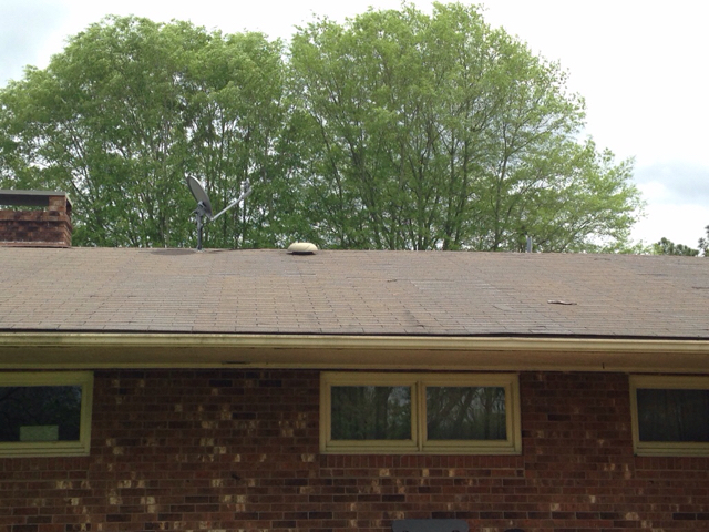

I don't know the pitch.
Yep, 5/12 at most if not closer to 4/12 is your pitch... That's an easy one.

Metal costs about 1.5x as much in material but labor is cut in half. I don't see any "waves/ridging" going on so "IF" you know you don't have any leaks, then it's a safe bet to even slap the metal down on your existing shingles if you REALLY wanted to cut labor down.

Looks like a brick ranch so I'm assuming only a valley or two at most if any. Would be an easy install for a diy guy. Flashing or building a cricket around the chimney would be the only thing you may have trouble with but nothing hard.

Looked at the picture again and looks (on my phone) like your chimney comes out the ridge if so then you wouldn't have to build a cricket just flash around it instead(much easier for a diy).
