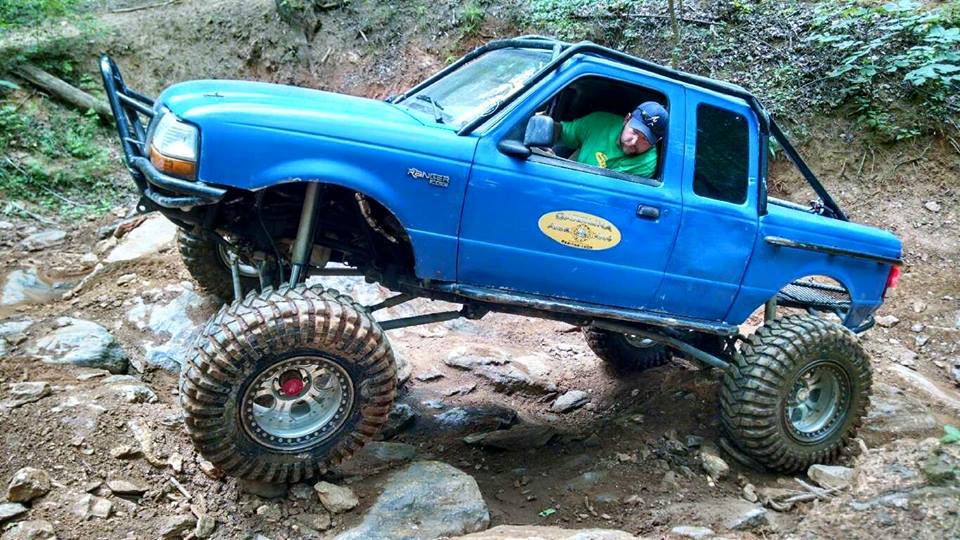

She's been a faithful servant of my 4 wheeling hobby for the last 2 years. Aside from a few high steer studs and 2 ujoints, I couldn't be happier with my Ranger. It has taken me on every trail at Harlan, Windrock, Durhamtown, Golden Mountain, The Flats and The Shop and it even made it back to trailer!

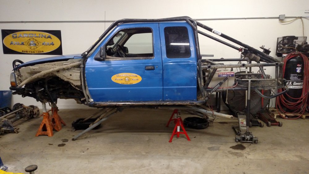

As it was
As it is currently:

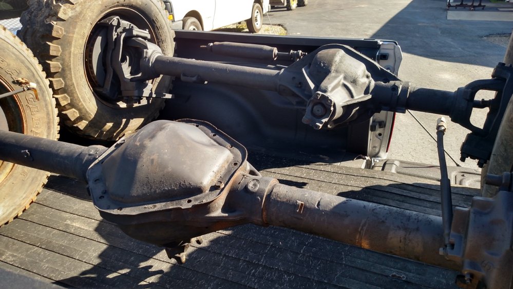

The heart transplant awaiting it's turn:

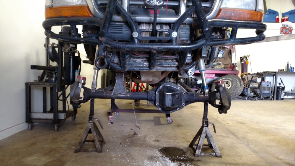

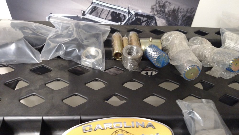

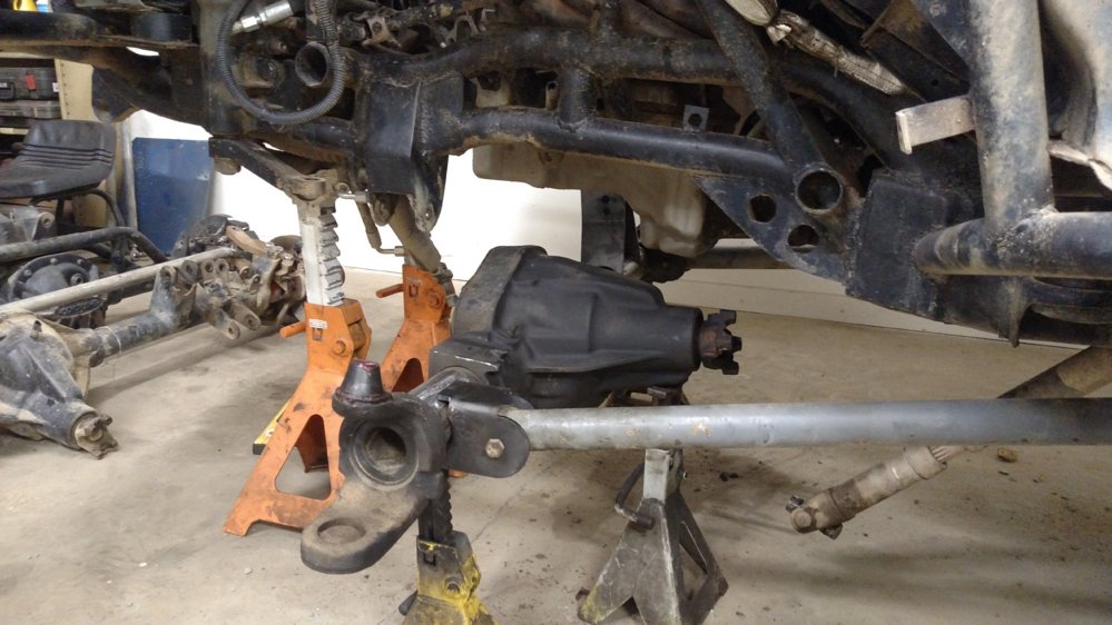

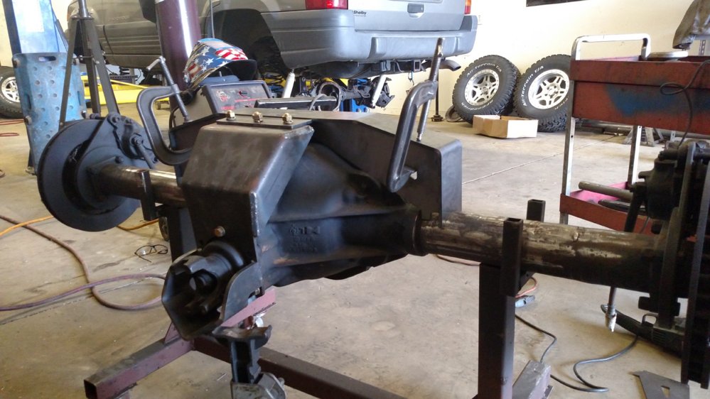

Got the front axle stripped down to the bare housing and mocked up under the front. @Pless played mailman and dropped off some suspension goodies from @Barnes 4wd.
Going to tack the LCA mounts in and place the upper tower tomorrow. Next step will be head scratching determining where the trackbar fits best
I ran the numbers once before and according to math, geometry and trig, my truck should fold in on itself.o_O
My Lowers will be flatter, my upper will be parallel to the ground and my trackbar will be just shy of parallel all at ride height.

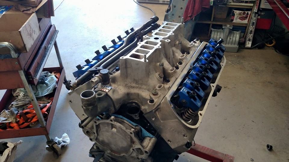

What is the engine going to push out when you're done?
According to my engine builder and the software we've plugged it into it should generate about 425 HP and 380 ft/lb torque. Peak HP is higher in the RPM range as you would think. The torque curve is somewhat flat above 2500 for a smaller displacement engine.
There's no replacement for displacement, but a lot of compression and a thoroughly thought out build plan don't hurt!

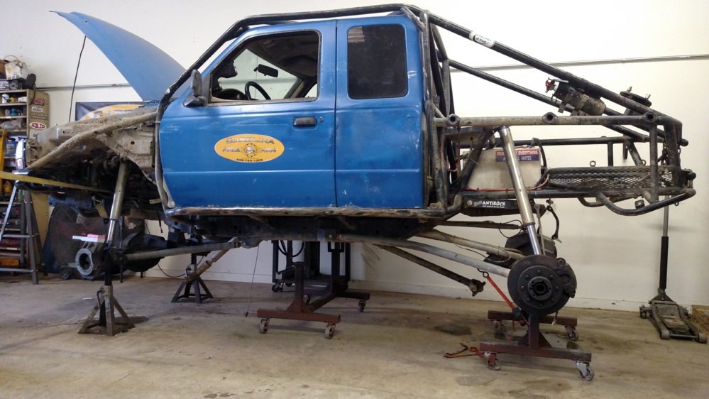

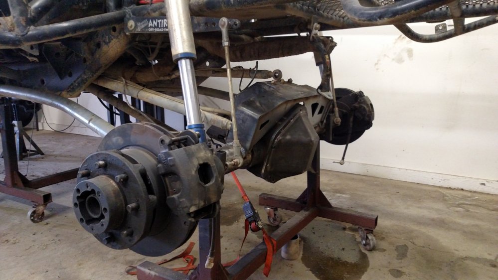

Today consisted of getting the rear axle underneath and ride height established. Thanks to Brad @Barnes 4wd I had a pile of goodies for my front and rear suspension. I installed his truss, pinion guard and 13 bolt rear diff cover kit. After welding on some air shock tabs, I installed the rear axle. Still need to weld on the upper CA mounts on the truss, just ran out of time.

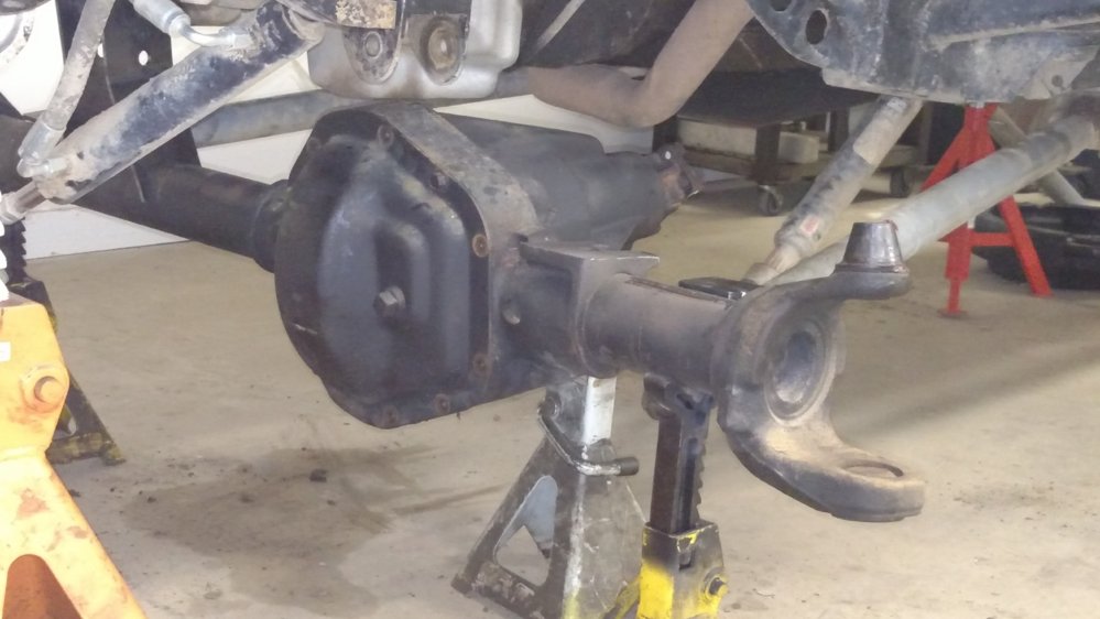

Up front I got the front axle installed to finish mocking up the steering and track bar. Excuse the super sweet ratchet strap keeping the body centered on the axle. I'll bend some 1.5" x .250" DOM this week and finish the track bar design. Ride height is now established and I can make some tweaks here and there.
I hope to have it as a roller in another week.
