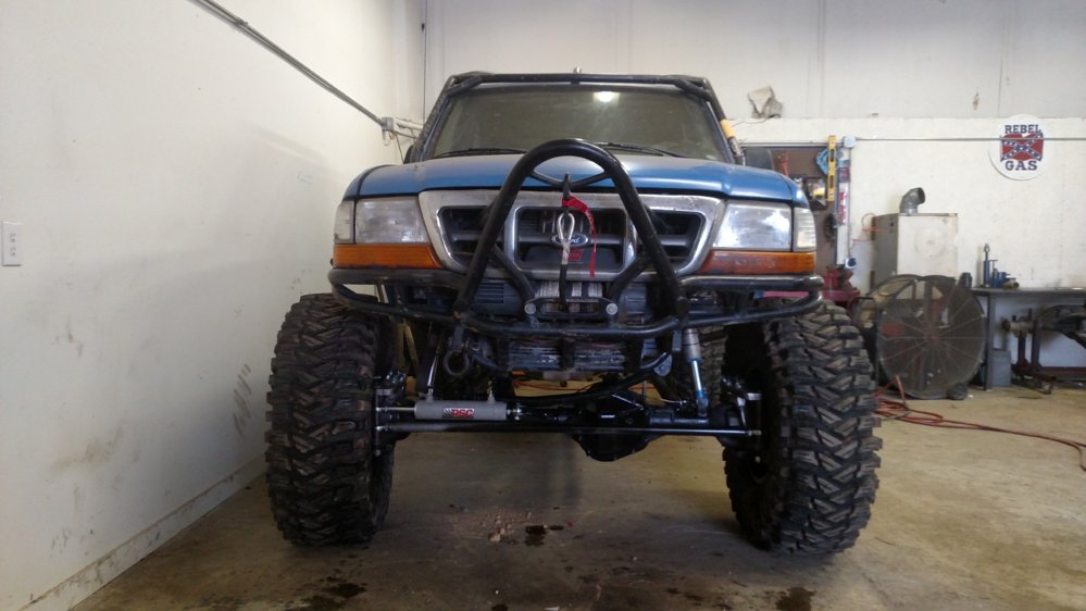

Left out one from the front.

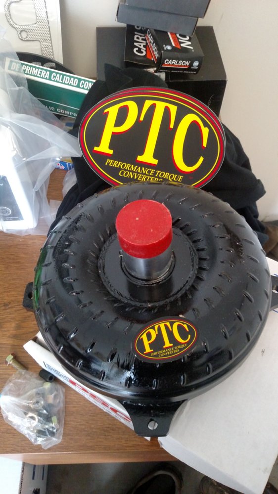

The last of what is needed to install the new engine and fire it up arrived today!

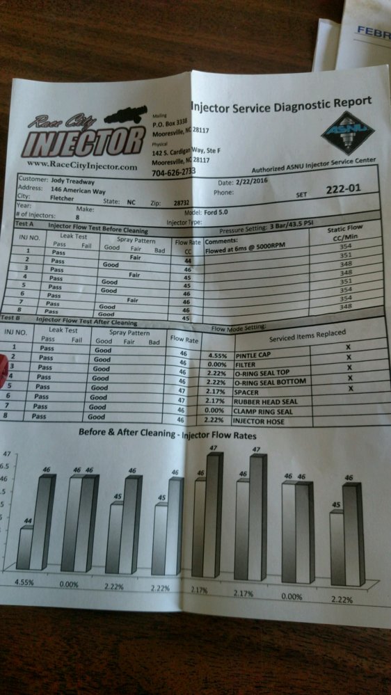

PTC made a converter to my truck's exact specs. I sent my injectors out to Race City Injector in Mooresville to have them flow matched and cleaned

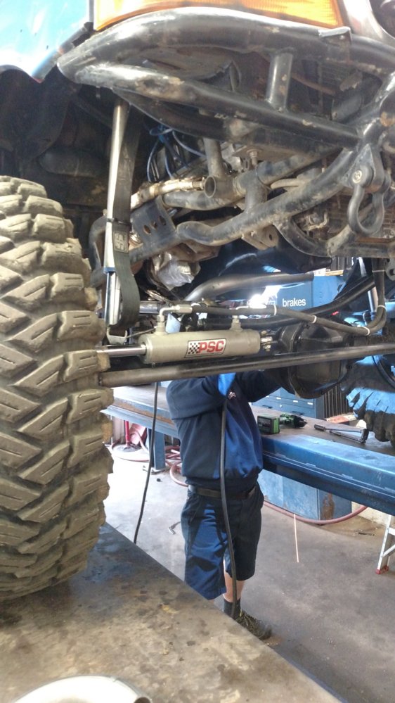

I buttoned up the suspension, did some engine tuning and drove it around the business park last weekend and everything seems to be in order.

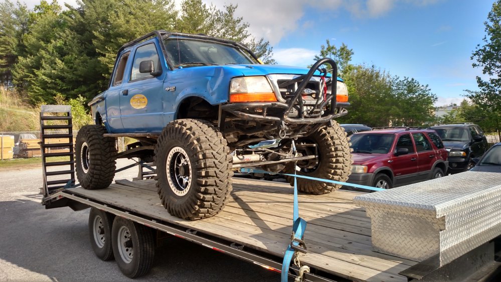

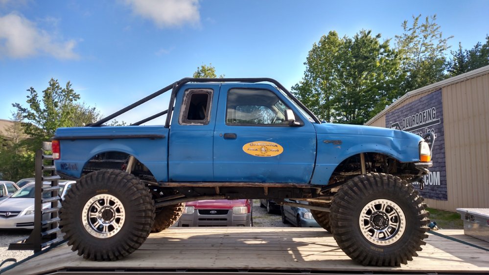

Yesterday I loaded up and took it to Custom Exhaust and Brakes here in Asheville for some sound therapy. 4 hours later the drivers down pipe will no longer boink the driveshaft and the new muffler choice let's the ol SBF sing a little :D.
I'll test it out at The Flats next weekend in preparation of wheeling 3 of the next 4 weekends!
On to the pics.
