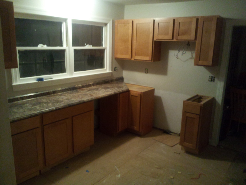

Got the whole kitchen painted and half the cabinets hung. Tomorrow we are going to hang the other cabinets.

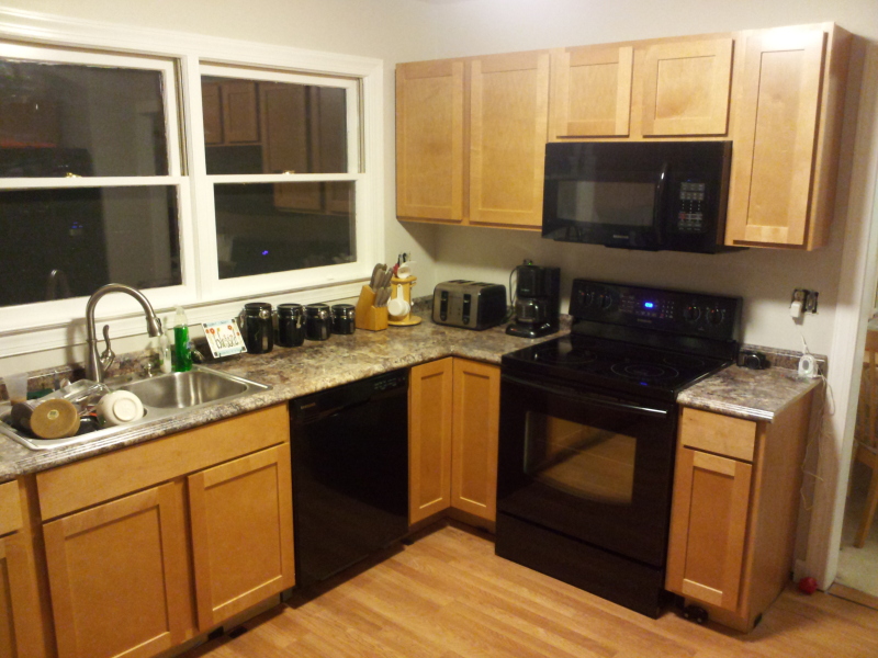

Cabinets are hung! Man, that lasy susan was a filthy whore.
