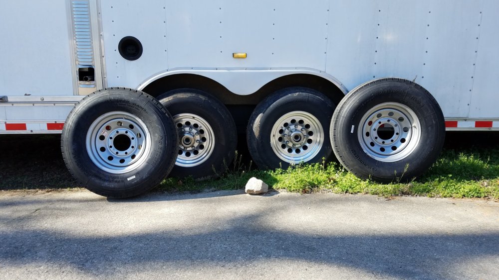

We've popped four trailer tires in the last ~5 years. The first two came with the trailer, and while they weren't old per the date codes, the sidewalls were pretty badly checked. I figured they were just past their prime.
So we bought four new LT truck tires for it and ran like that for a pretty good while. Two years ago, I lost the left rear in the middle of the night somewhere in Tennessee. I figured it might have been a fluke, maybe picked up a nail, etc. But a couple of months ago, the right rear threw the tread. It still had 80psi in it when I pulled it off the trailer. I decided it was time to do something different.
I have a buddy that really likes the Gladiator tires. They're pretty cheap (about $120-140/ea), G-rated (3750# / 110psi max), and made in China (like pretty much every other trailer tire nowadays). I looked at them pretty closely, but found some chatter about Sailun S637 tires. They're also Chinese, but they're pushing into the commercial truck market, and there's some internet chatter that they're "better", due to the QC/ISO requirements associated with commercial truck tires. The 235/85R16 tires are rated for 4,080 lbs each at 110psi.
I found a place up in Ohio that had them, and would mount them on 3960# rated aluminum wheels and ship them for $310/ea. I ordered them on Wednesday, and FedEx dropped them off at the house on Friday night.

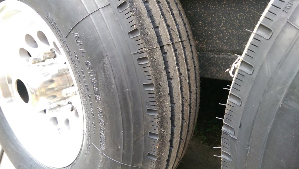

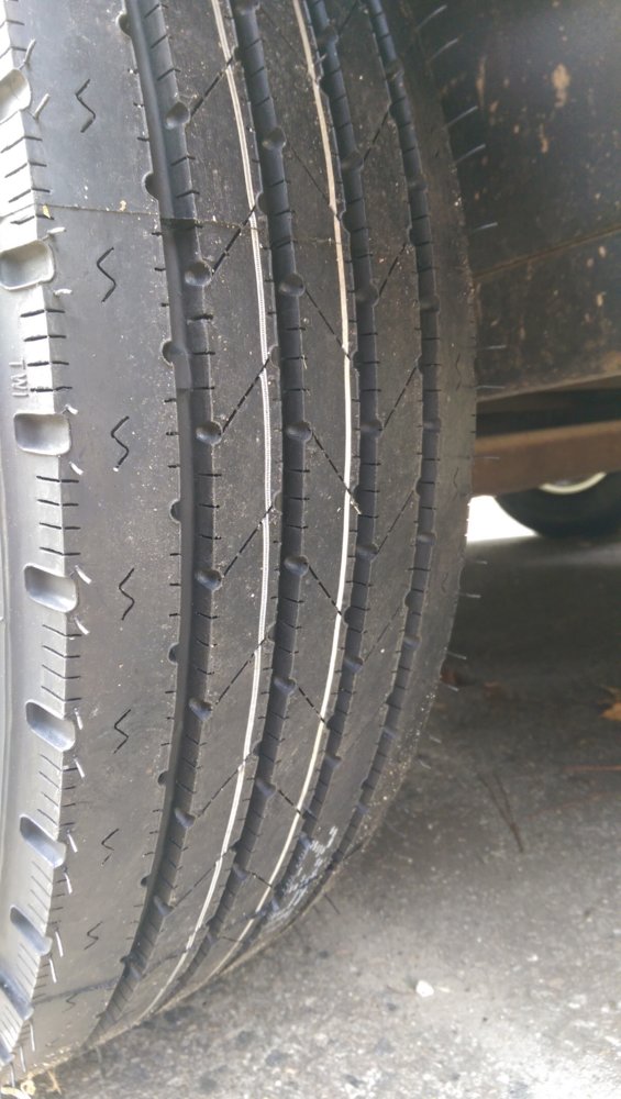

My first impressions are pretty good. It's an all-steel tire (steel sidewalls), and even though they're still 16s, they look every bit like a commercial truck tire. With a total capacity of 15,840 lbs, there's a good bit of extra capacity over the 13,500ish that is usually sitting on these tires.
