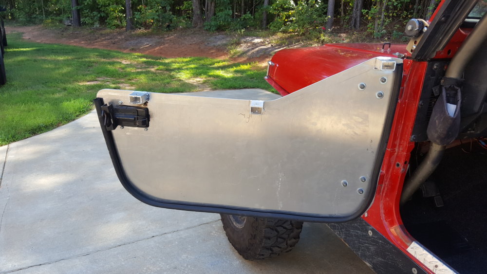

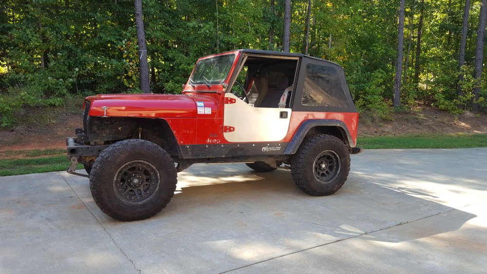

Couple more door pics. I need to polish them now :flipoff2:

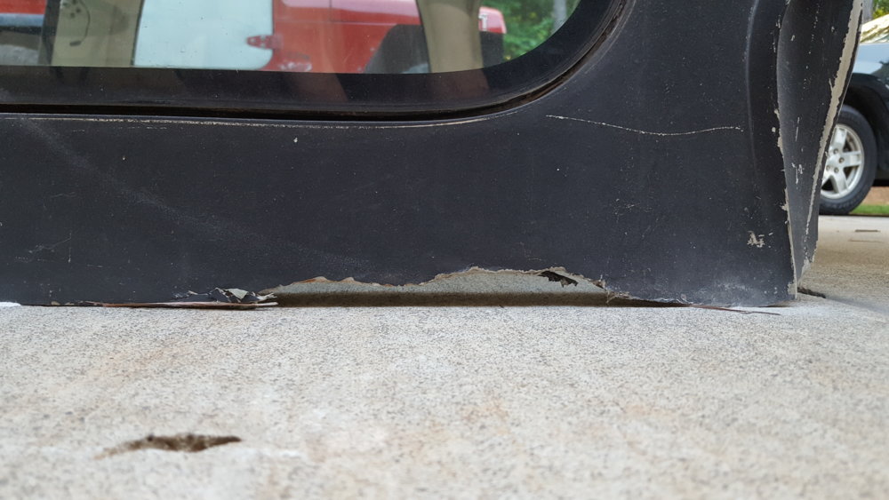

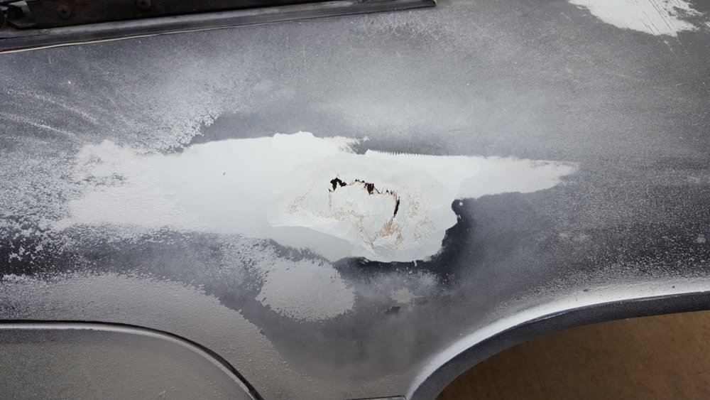

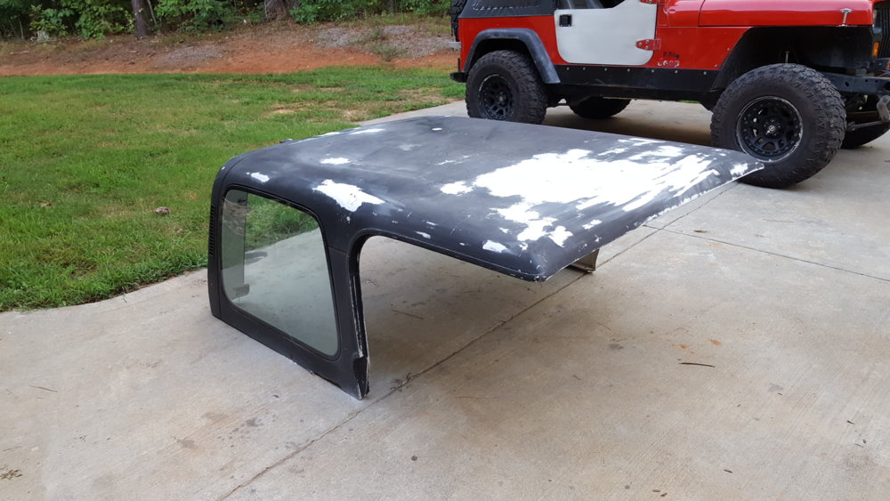

Picked up a hard top from a buddy up north for dirt cheap and finally got around to fixing it. Anyone have tips on fiberglass repair?
It's not just fiber glass it has a plastic blend. Use boat repair epoxy they sell it at lowes in the paint section with glue. Apply let dry and sand. Worked great on my lj hard top.

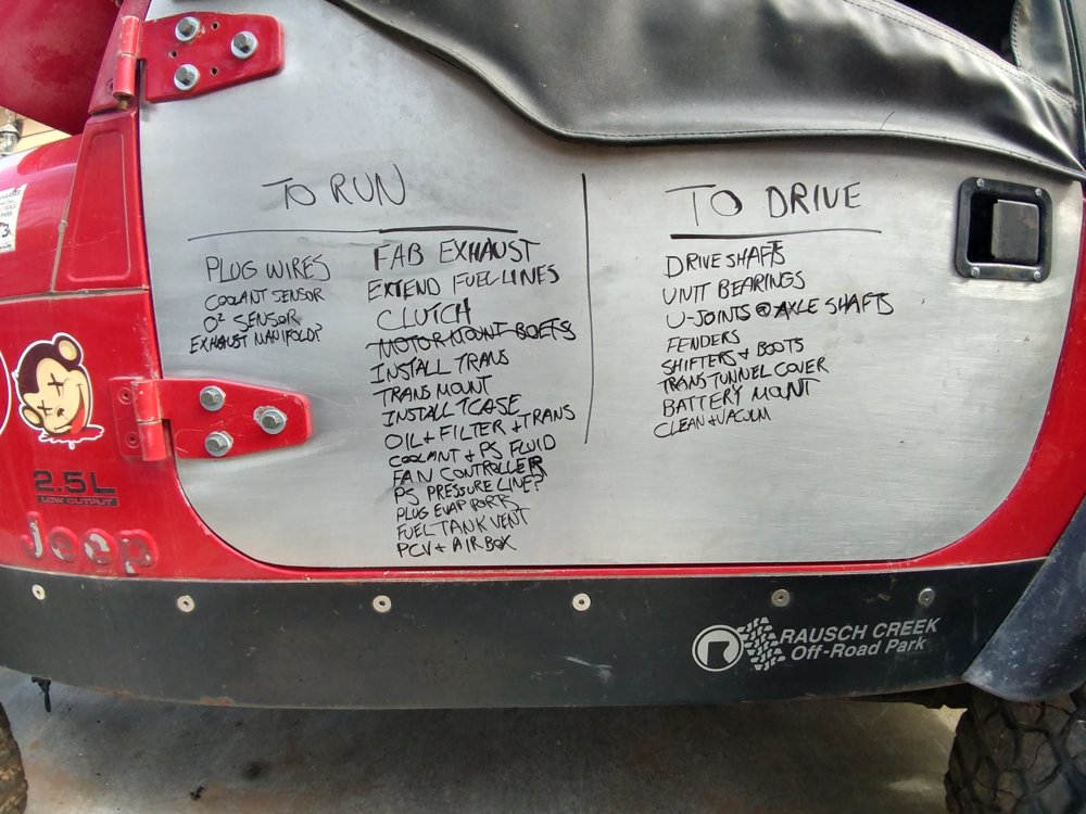

Welp I should probably update this as some progress has heen made. The engine is properly bolted in and I bought an ax15 off another CNC member. Put a clutch and flywheel in it and bolted it up. I have the engine all wired up and everything powers up properly after chasing some loose connectors in the harness.
I bought a 23 spline 231 off another CNC member with a nice SYE already installed but I have yet to put it in. I need to install the tcase, extend the fuel lines, add fluids and it should be ready for a start attempt.
The engine is about an inch farther back than stock so the water pump clears my electric fan. The bad news is this means the trans is all up into the tunnel and I won't be able to keep my super sexy flat belly without cutting the whole tunnel out so the bellhousing clears. For now I decided to run the factory trans mount in lieu of a crossmember and use some 1" spacers to drop the skid down so everything is kosher. I'll have to redo my engine skid as well. I'm bummed, but I also don't mind it, since the old engine/trans combo didn't really clear either and caused all kinds of rubbing and vibrations in the cabin. I'm ok with losing an inch of belly height if it means a more comfortable ride.
I actually made a checklist this time too :D
