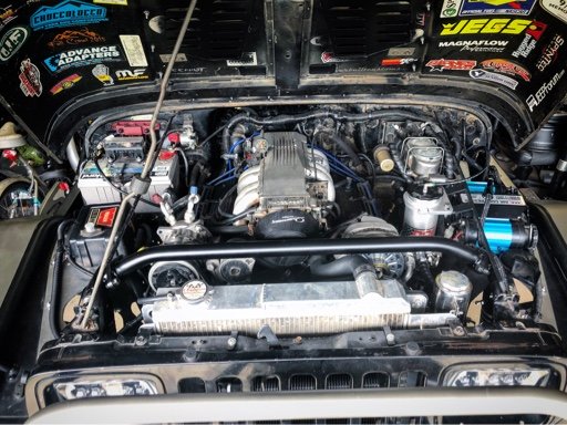

My WJ ECM was tripping out before I converted to these. Also don’t let the parts store jack ass change your battery. They destroy cable terminals.

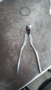

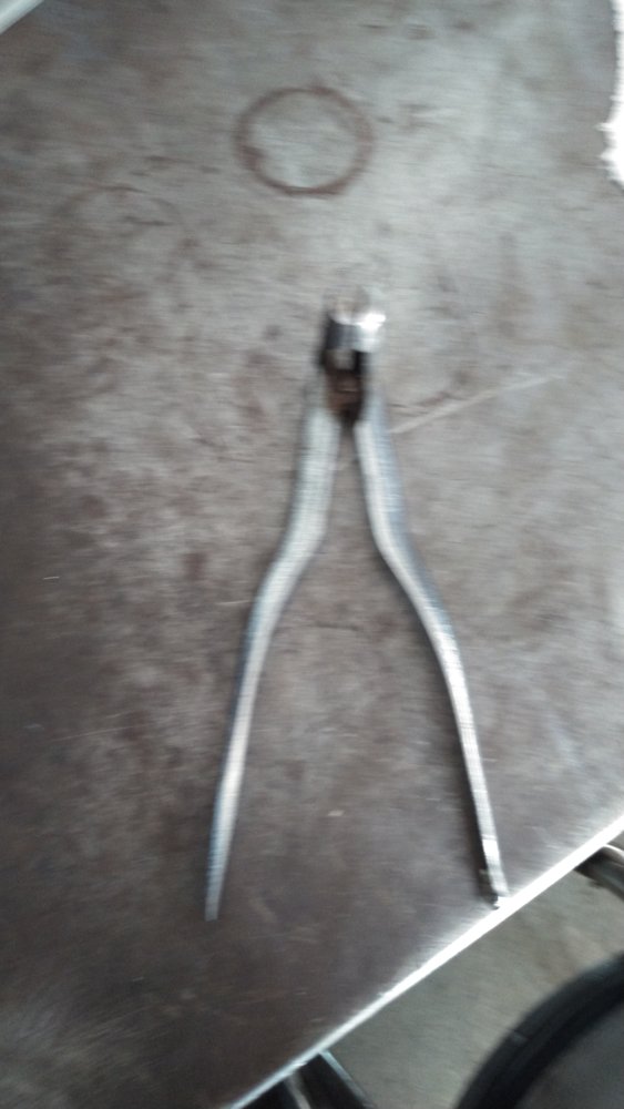

I can't recommend a terminal end because I have mine set up using regular cables from advance and a junction block off the Ford solenoid for add ons, but just wanted to add you should never beat a battery cable on a battery. Best case it'll crack the plastic housing letting gasses out around the terminal causing the powdery corrosion. Worst case it can crack the lead strap connecting the terminal to the plates internally. They make battery cable pliers to open the cable up so it will fit the terminal. It's not unusual to have to open up new cables or repair ends to fit either post.

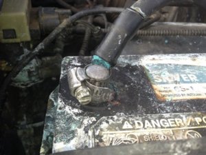

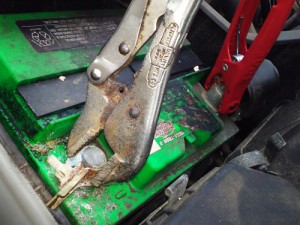

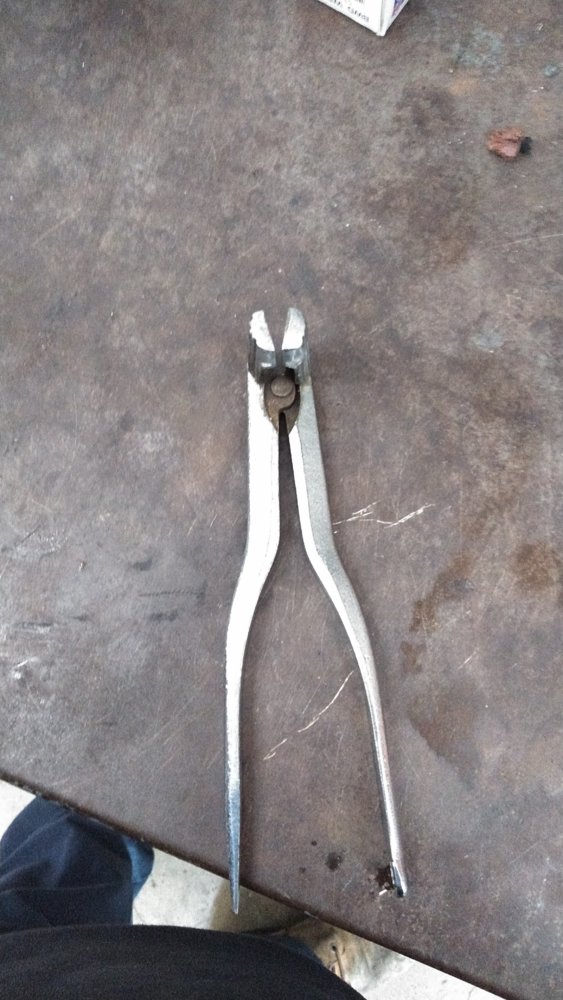

Here's a better picture.
