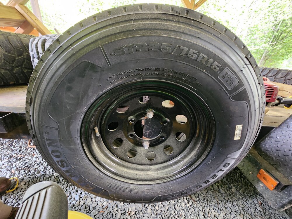

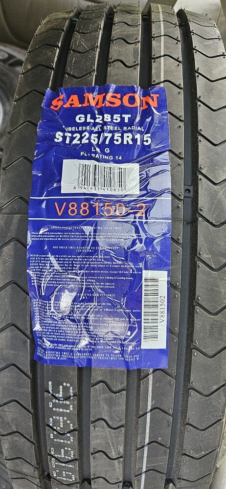

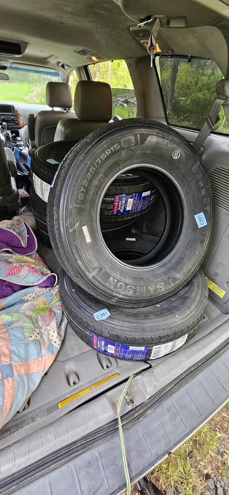

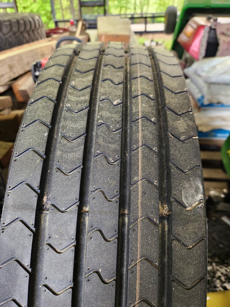

I recently put on a set of 225/75/15 Samson All Steel GL285ST 14ply on my 10k trailer. I've only used the trailer twice since putting them on so don't know about longevity but im happy with how it rides so far. Trailer had 10 ply tires on it before.

Shit, those look nice.

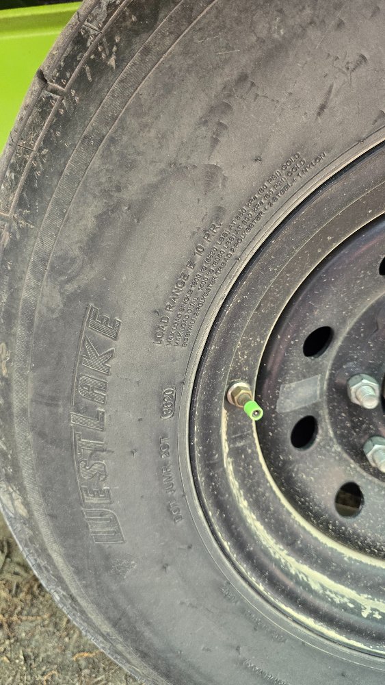

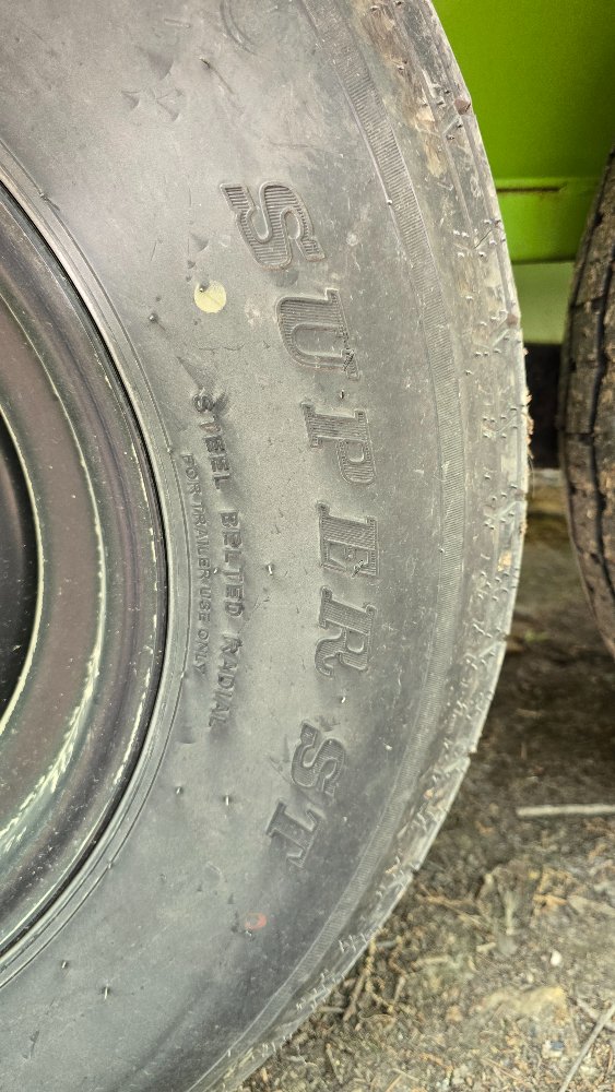

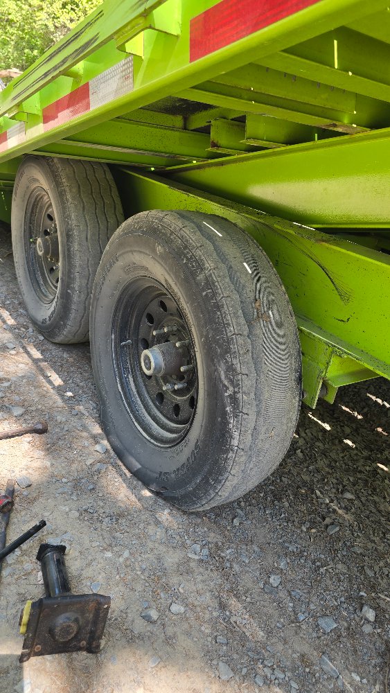

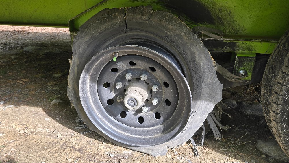

These Westlakes came on my trailer new and are dated for 2020. They have been the worst trailer tire I've ever used. Multiple pin holes from what im guessing is 18Gauge copper wire. Im upgrading to some LR F tires on the two that blew out this weekend to see how I like them before swapping the last 3 over.
