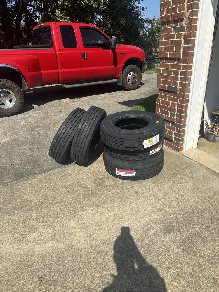

Still looking at tires. Been reading up on 17.5 wheel/tire combos. Any reason not to step up to them?
$250 ea (wheel and tire) gets me 4850# capacity per tire. Seems like I'd never have an issue with overloading them. Can keep my old wheel combo for spares.
Thoughts?
Sailun 17.5's here, zero complaints. I've had one puncture in 5 years, and that was a big chunk of metal in the parking lot of a metal stamping facility when I was picking up some machinery. Otherwise they ride good, have good braking traction wet or dry, wearing very nicely, and carry a shit-ton of weight.
I've got 30k+ miles on the Saluns I put on my toy hauler about 6 years ago and that's loaded to ~21k lbs. It's about time to replace them but I can't complain with that mileage. I'll put a set on my gooseneck when it's time for new tires.
Thoughts?
I love 17.5s. I've had one blowout and I believe that tire was bad from the very beginning. It had a bounce in it from day one. As far as tire brand...it doesn't really matter. They're all good enough. The rear axle of my trailer still have the Double Coins that came on it and the front axle has some Iron Mans. Iron Men? Whatever. :D The initial swap over is pricey, but tires are pretty cheap online.
