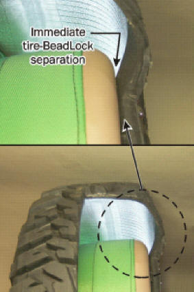

well how do the internal ones work?
the tire has an inner tube type device that is inflated to apply pressure to the bead from the inside out, which keeps the bead from being pressed in.
Example
