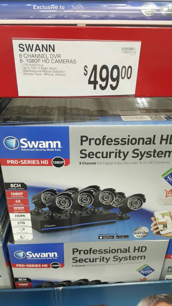

Any of the experts on here, can you recommend sites to purchase equipment from?
I'm capable to install my own system, and willing to source different cameras and drives, just not sure what are the better things to look for and buy, and where from.
My specs, not to hijack the thread:
I want 4 to 8 cameras, night vision, etc, enough storage for a month, and ability to monitor remotely.
This kit has all of that, but I don't know if it's worth the $$ or find build my own kit.
