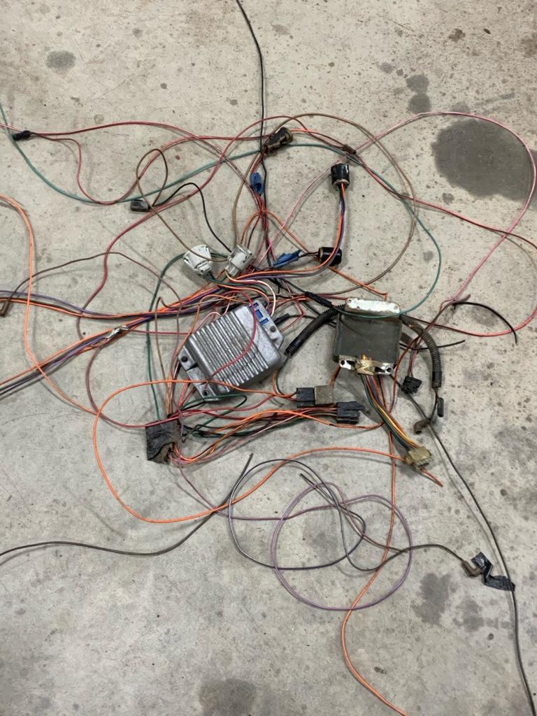

Finished up removing the unused wiring. Traced the wires all the way back and removed them from the firewall plug. It ended up being more useless wires than I thought. Going to finish this up and get the wires routed back to their respective locations.

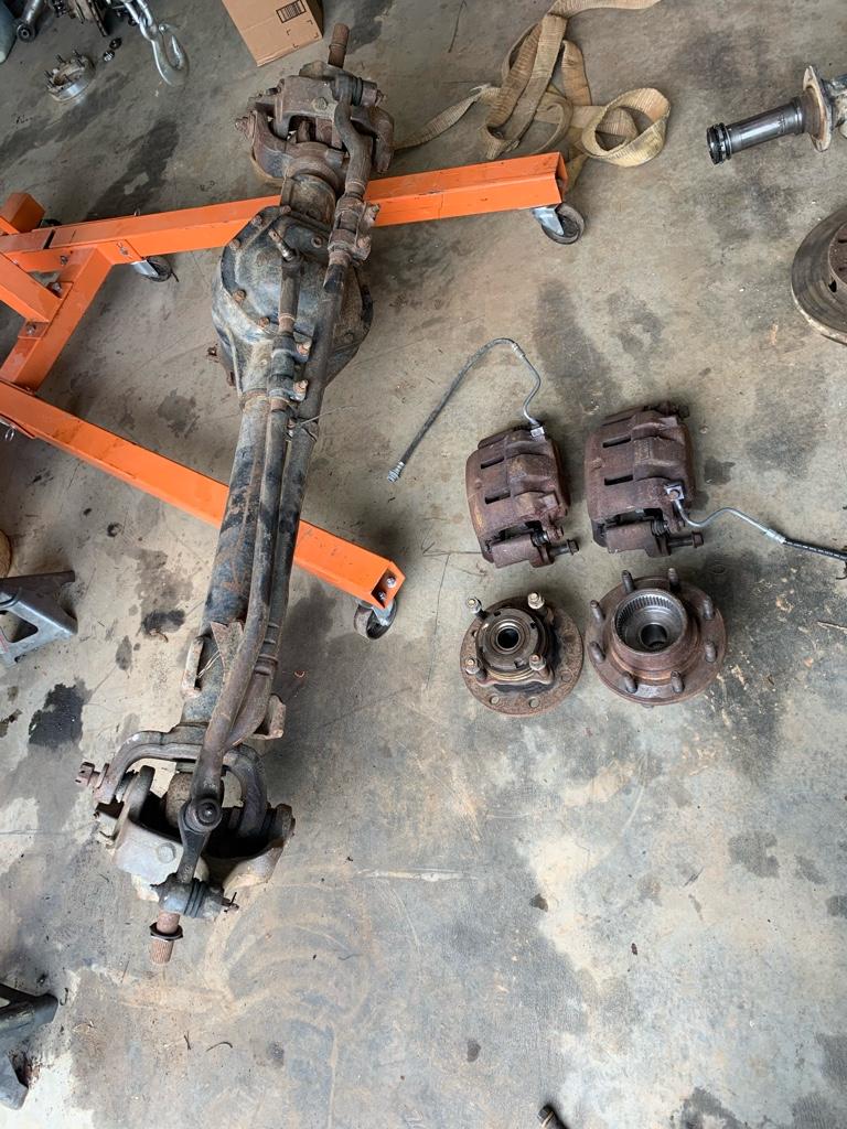

The plan has always been to upgrade from the military tires to something with traction, and the rig really needs a larger tire to fill up the wheel wells. With this added size we figure the front 44 isn’t going to hold up to much more so we decided to stop spending on more upgrades for it, and I snagged a deal on the solution.
99-04 SD 60 pretty much complete besides the locking hubs and rotors. Throwing some cheap matching gears at it for the time being and out boarding the front springs 2.5” per side.

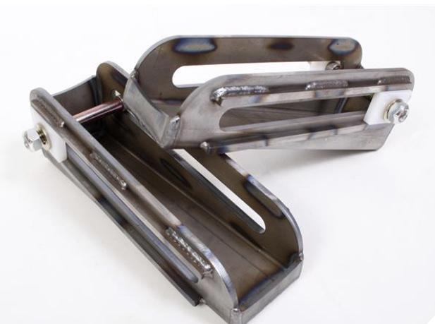

An issue I run into with out out-boarding is the spring perch width of the 60 puts the shackle directly centered on the frame. So my solution is the leaf spring slider.
This picture is from liquid iron industries but my plan is to custom fab my own.
They make sense to me. The current shackle angles on the rig aren’t perfect, so we wouldn’t be losing much if any down travel. It makes packaging much easier.

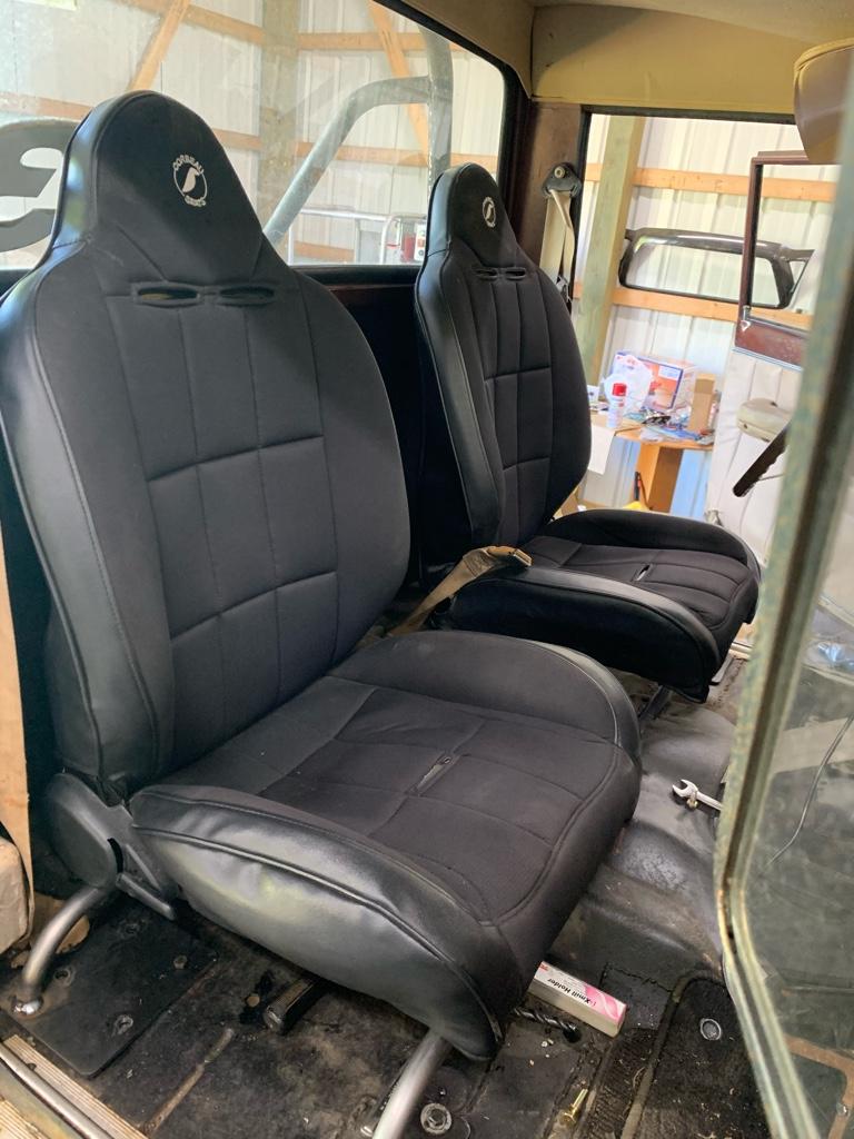

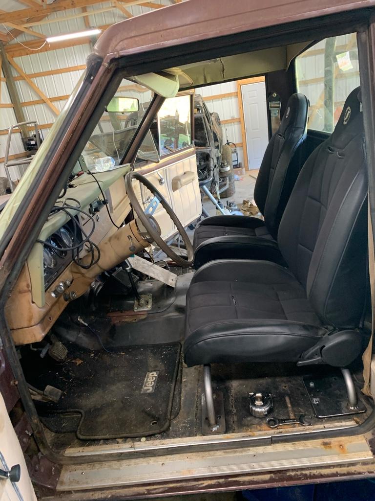

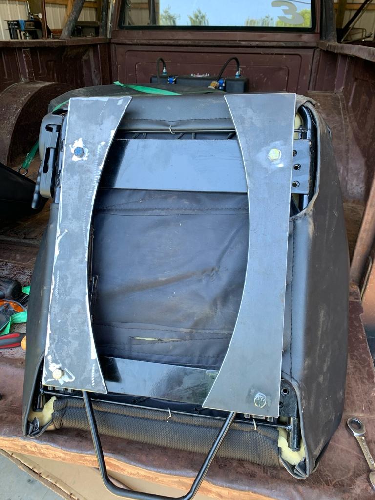

Little bit of productivity on this Saturday. Pulled the bench seat out and set some Corbeau Baja RS seats in with a little fab work.

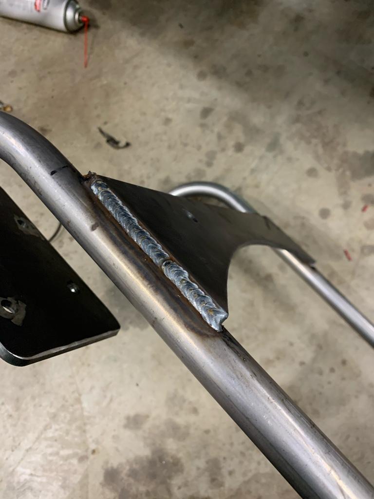

Slowly working on getting more consistent and smooth with my mig welds...
For now I’m just distributing the load of the seats through some large .25” plates. When we get ready for a cage these will get tied into that and the frame.

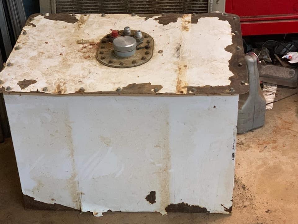

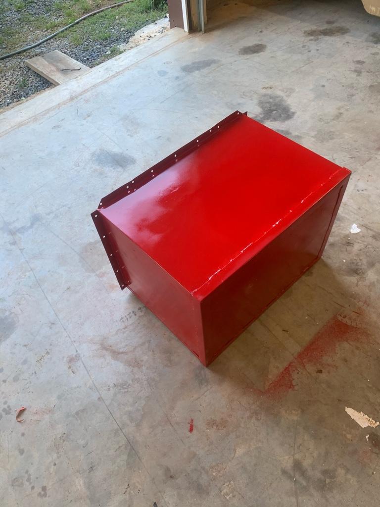

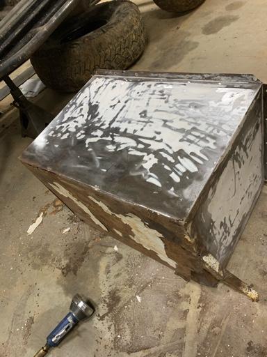

Earlier this year I picked up a 32 gallon steel fuel cell with the plastic bladder. I got it cheap because it was in rough shape, I probably should’ve scrapped it and bought a new one but I decided to rebuild what I had. I replaced the rusted out bottom with some thin angle on the corners and 14 gauge steel in the bottom. Turned out pretty decent but after all the prep I had more time in it than it was probably worth.
Going to button this up and cut out some mounts for it later this week.
