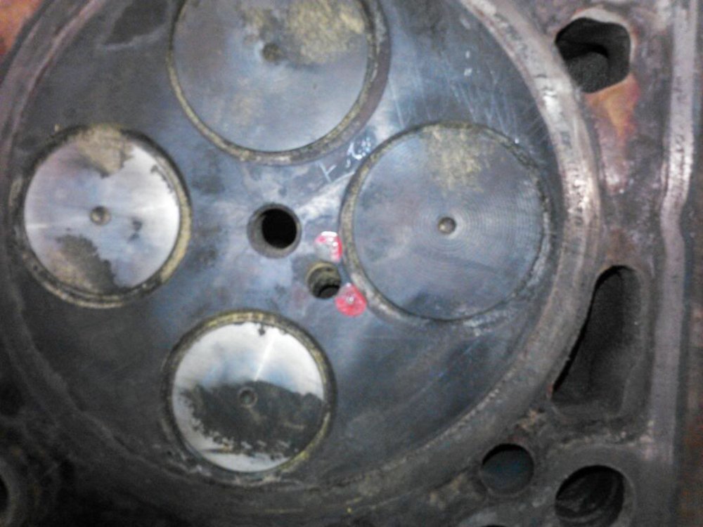

how do you machine this head and not effect the combustion chamber? I do believe they can crack, but that's when your torturing the shit out of it with piggy back programmers and shoving way more to it than stock is meant to handle.
