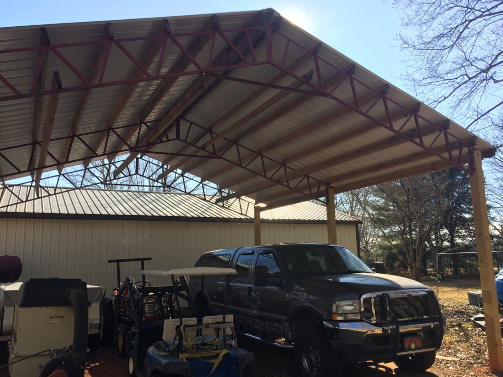

No way I would use 4x4 post @12'. 6x6 all way around if it were me. I put up a 24x24 and used metal trusses w/ 4/12 pitch. Had it up in 2 days. Dug holes, set post and Bolted trusses together. Then used tractor to set trusses on post, installed 2x6's and metal roof on second day.

@89wrangler I'm interested in the trusses you used. Brand or pictures?

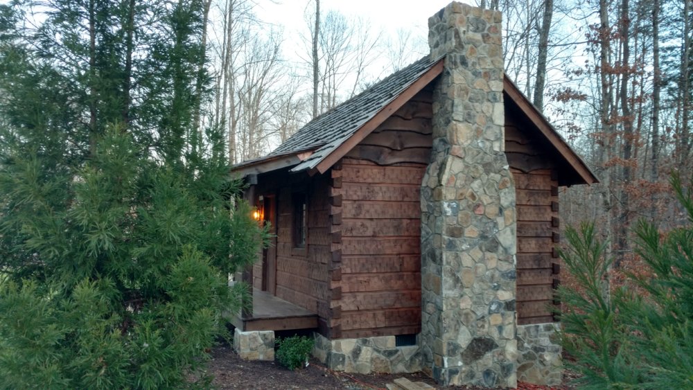

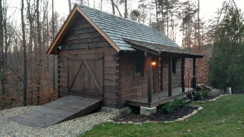

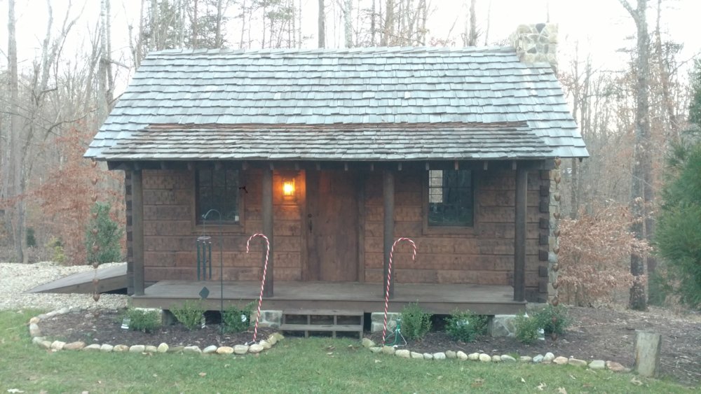

I needed a shed because I could barely walk around in my garage. I went up to House of Stars on 220 to look at buying a shed. I was surprised at how much they wanted for a 12x24 unit. I then decided to build one myself. Then I thought it would be cool to make it look like an old log cabin since I always wanted to live in one. Things continued to spiral out of control. I'm almost done with it.
Edit:. I did not do the foundation and stone work.

That’s nicer than the first few houses I lived in. Probably bigger too.

Here is the link to where I got my kit. prices are on the website, $4.95 sq ft for complete kit. Also the truss info is there.
https://www.stroudsbuildingsupply.com/pole-barn-kits

Thanks....I knew of one or two established metal truss builders.
Pm me any pros or cons if you feel like it. I'm genuinely interested feed back. I would appreciate it greatly. I am considering a venture.
No cons on the components at all. Very simple build. I wish I would have known about those trusses when I built my shop. Only con is I went 12 foot between the post to get my 24' and wish now I would have went 10' and 30' length. That is on me though. Getting ready to add a 12' lean to on the side for more storage and then put metal on three sides.
