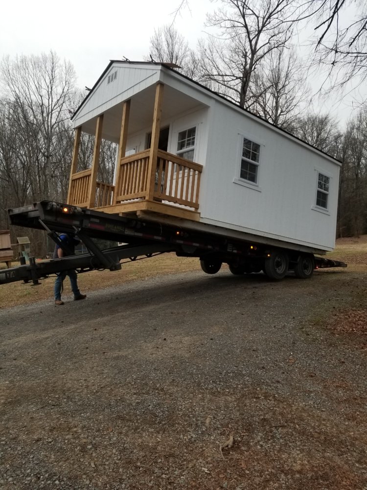

My wife now works from home and needed an office so this is the solution we came up with. Much cheaper than a home addition. 12X20 cost $6000. It has up graded windows and we added a wall for a bathroom. Will add a mini split ac unit. We are currently working on the interior.

That's pretty slick. No more square footage than you have I would just use a window unit rather than a mini split though. A split unit will be more efficient but with such a small area, you'll never see the difference on your power bill. You can "hide" the window unit and no one would ever be the wiser.

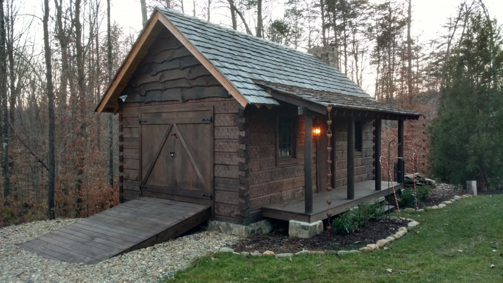

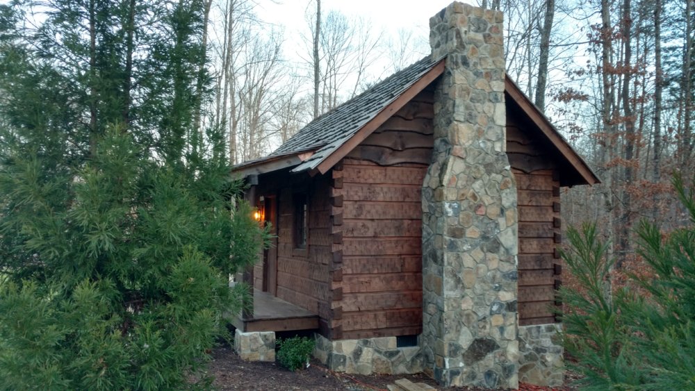

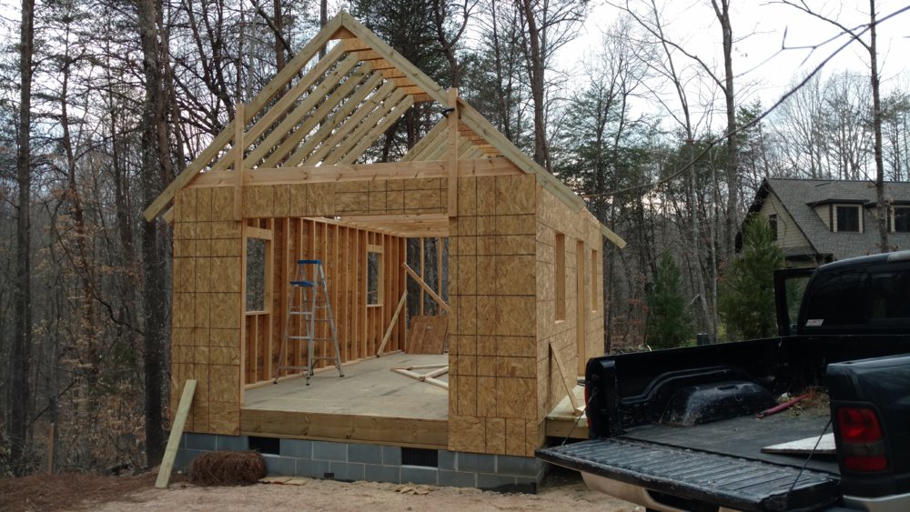

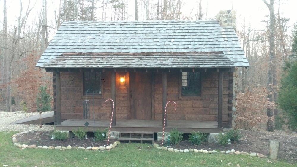

My shed building tip is to not get carried away with the project like I did LOL.
I needed a shed because I could barely walk around in my garage. I went up to House of Stars on 220 to look at buying a shed. I was surprised at how much they wanted for a 12x24 unit. I then decided to build one myself. Then I thought it would be cool to make it look like an old log cabin since I always wanted to live in one. Things continued to spiral out of control. I'm almost done with it.
Edit:. I did not do the foundation and stone work.

Ha! I started cutting the trees down to clear the site to build that one in the summer of 2016. I'm still not quite finished. I can share all my knowledge of how I did it and where I bought the materials if you wish.

Just make sure you wire it right and do it to code. Seen a couple of these go up in smoke thanks to sub par work or not being to code. One tried to hang a ceiling fan from a plastic junction box!

more info on the siding please??

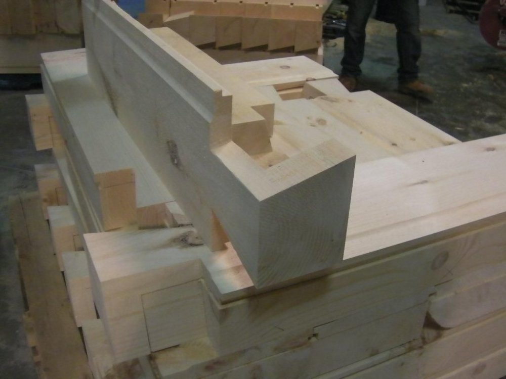

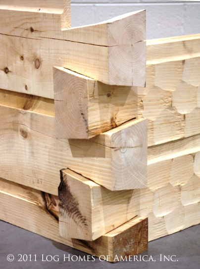

I bought the log siding and false corners from Boone Custom Forest Products. The log siding is their 'German Chink-slot' siding and I paid for hand hewing to give the authentic look. The 'false corners' start as 3' and 4' length solid logs that they cut the back side out of and then cut the dove tail on.
https://www.boonecustomforestproducts.com/siding-profiles
Here are a couple of pictures of what they look like (found this on the internet since I can't find the ones that I took).
My plan was to put use Permachink or Logjam in the chinking slot for an authentic look, but I haven't gotten around to that part yet. I might not do it since we are thinking about moving.
The wood on the gable ends is called 'Live edge siding' and I bought it from Boone Custom Forest Products too.
