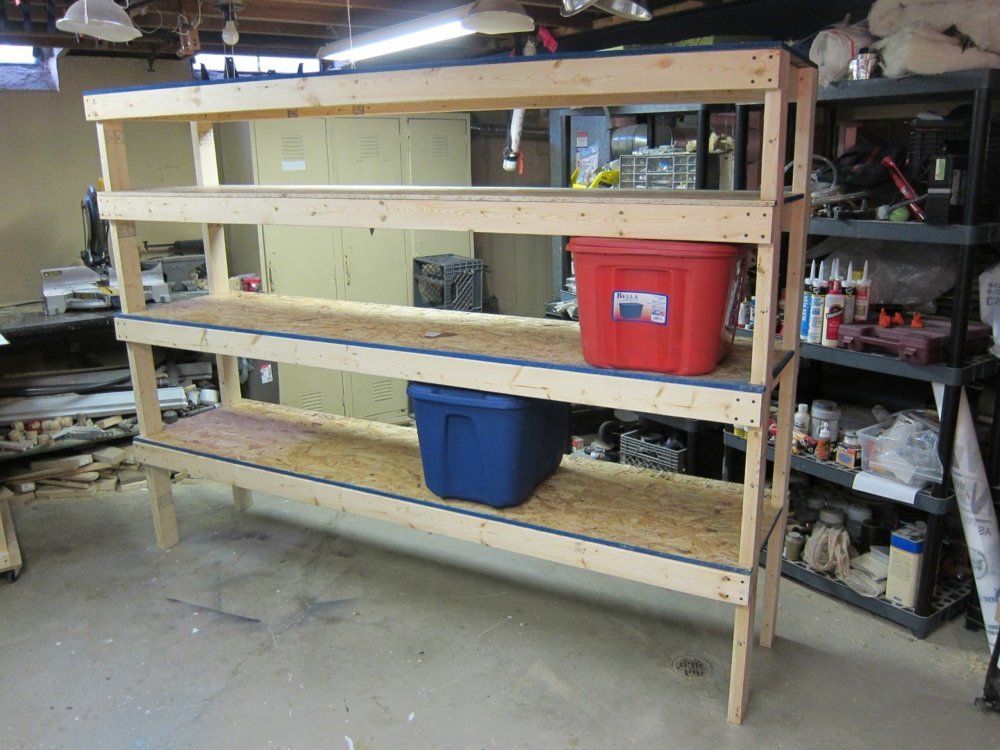

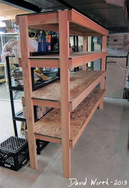

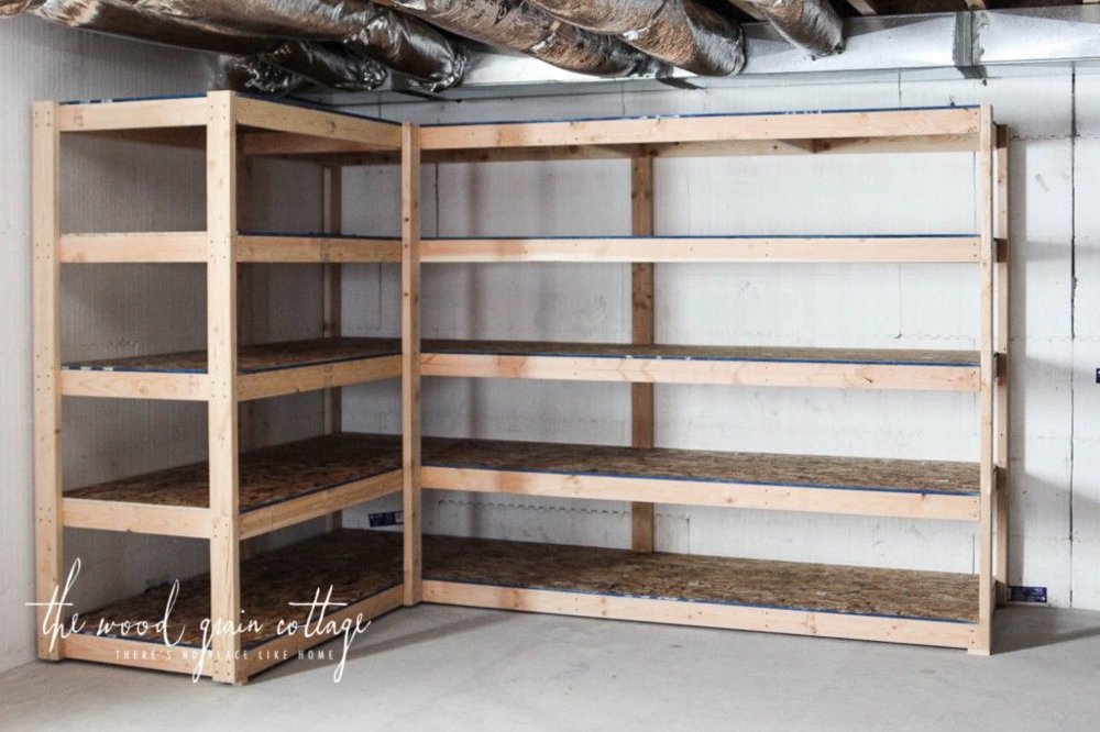

Thought I would post up a few pictures I found on the interweb. Thinking I like the 2x4 concept, I do NOT want to attach to the walls (concrete block, freshly sealed) so free standing.
What say ye!? Plastic / fast, $40 a pop or build your own.

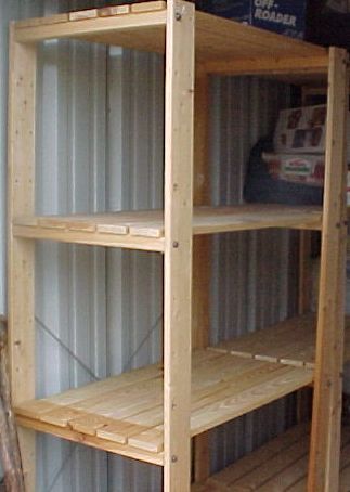

Thinner (cheaper) version with 1x4s instead, less load capacity, but fine for plastic bins and such I suspect?

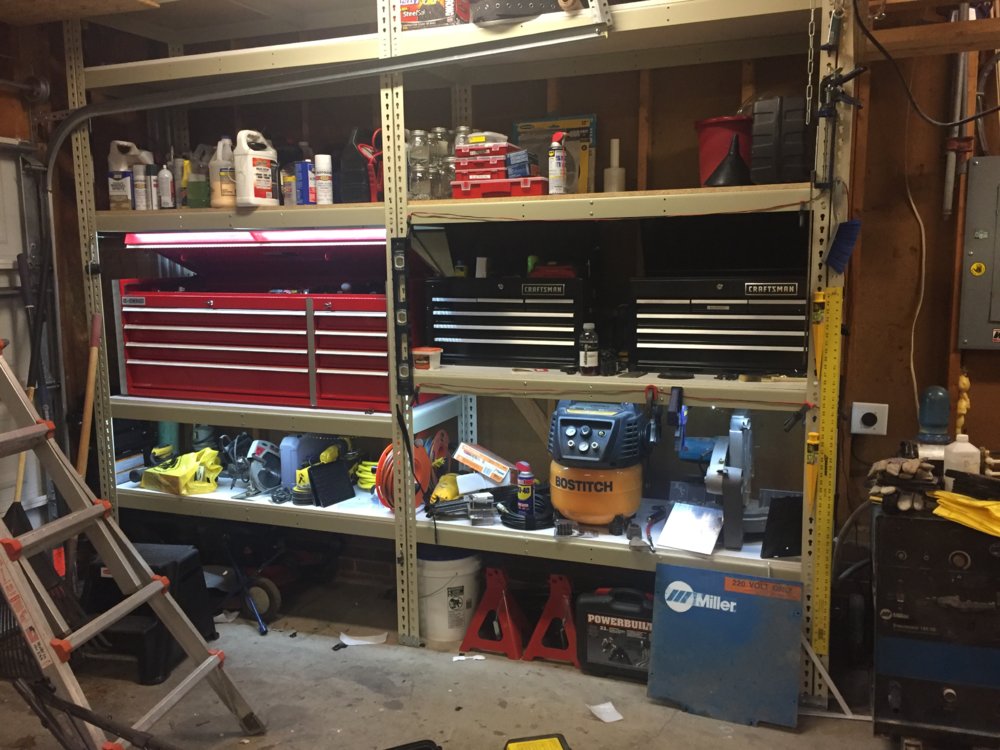

I love these shelves. They will travel with me when I move. Little on the pricey side but they are adjustable and hold 2k lbs per shelf.
Got them used at a place in Charlotte. Stein something

I like the wood ones. I built some shelves years ago for my garage out of 2x4s and plywood and they hang on the wall. You could easily design them the shelves to hang on the wall permanently later on at your final house if you want. Plywood isn’t too expensive. Build the shelves 8’ long x 2’ wide and with a standard sheet of plywood, you get 8’ shelves with no waste. And your 2x4s have little to no waste if you buy 8’ boards. A sheet of 7/16” OSB is like $13.

Wood. Use decking screws so you can take them apart when/if you move and can't move them in the assembled state. I like to make them 16" deep so you get 3 pieces out of a 4' wide piece of wood. I would use 7/16" OSB, and put a brace in the middle.
