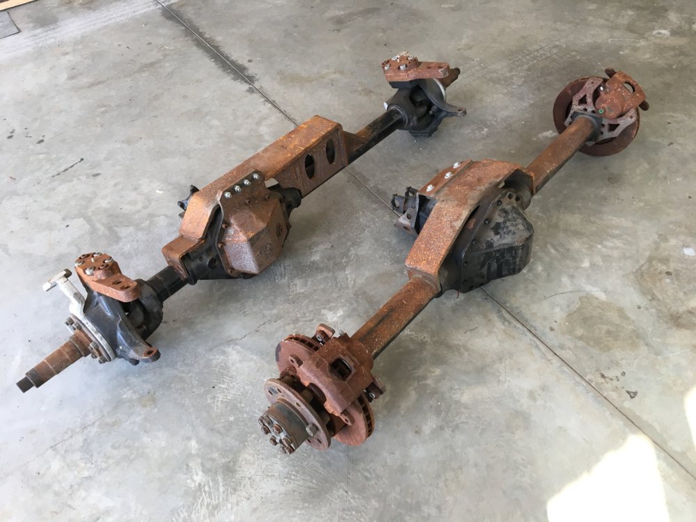

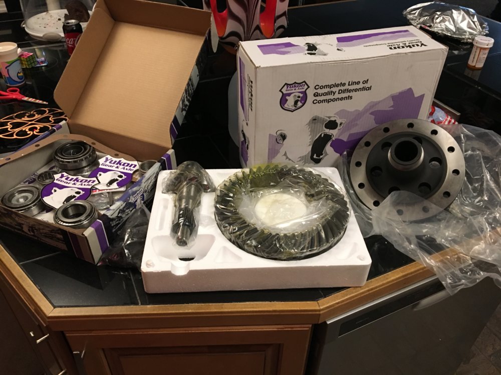

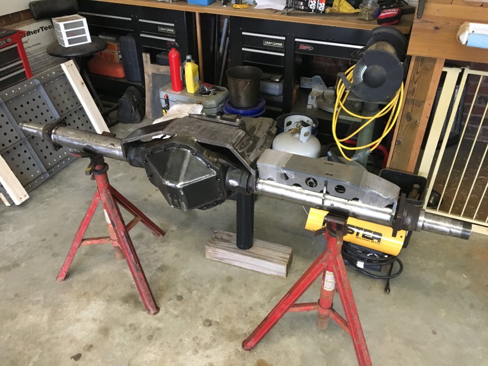

First part to get some love is the 14 bolt. Tore it down and cleaned off all the scale / rust to get down to shiny clean metal. Heavy coat of Gibbs oil to keep it that way. Both hubs spun freely so I’m gonna roll the dice and only change out the seal. Bearings seem fine for an offroad only rig. I ended up with some Artec add on trusses to beef up the axle tubes. They were being discontinued and super cheap. They’ll go in the cabinet to be added later. Loaded it and a bunch of purple boxes up in the truck to be delivered to @Jody Treadway tomorrow.

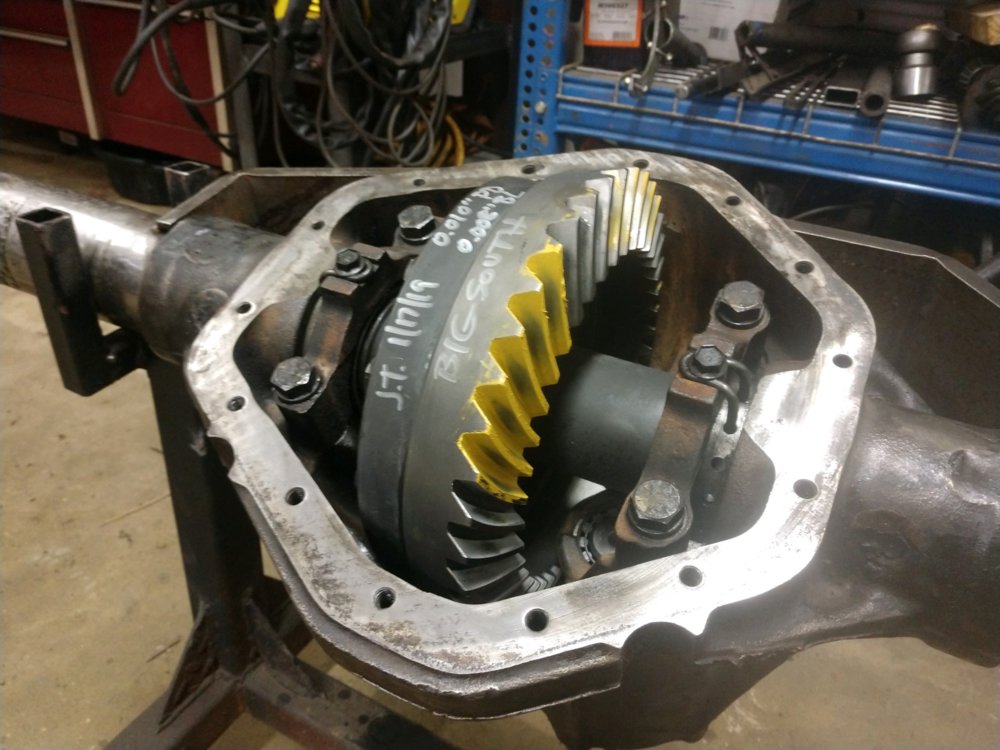

Yukon spool, 5.13 thick cut gears, and master install kit. I’m also changing out the yoke to the ubolt style 1350.
I know @Jody Treadway posted this elsewhere on the forum, but I figured I'd add it here so I can keep up with it. He says "Shits perfect"

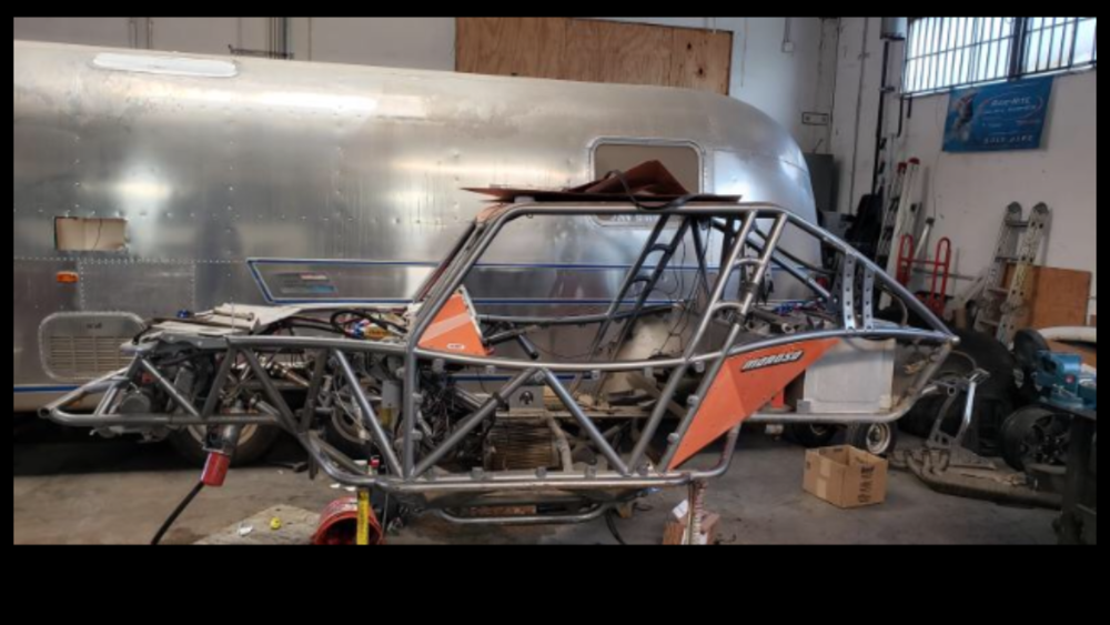

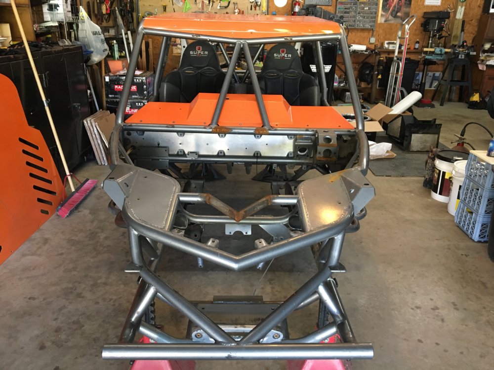

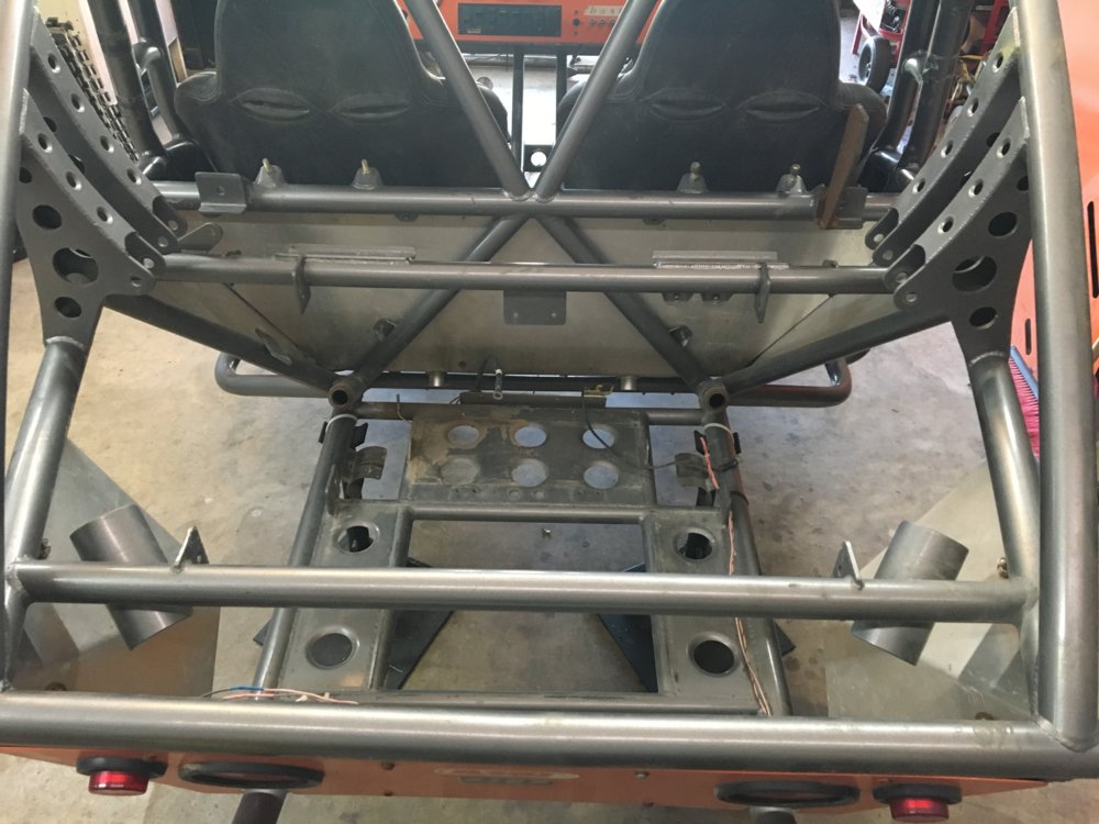

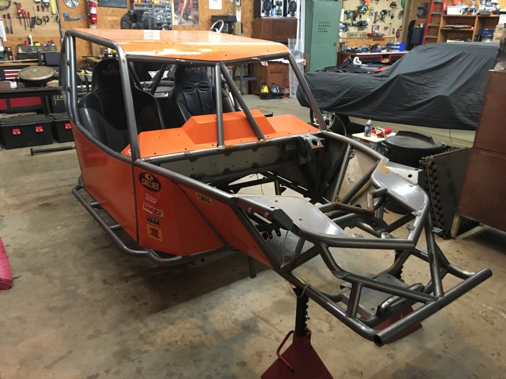

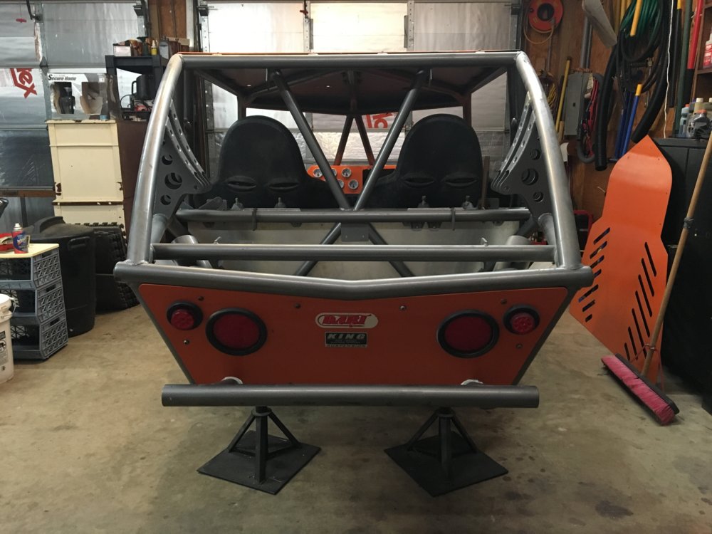

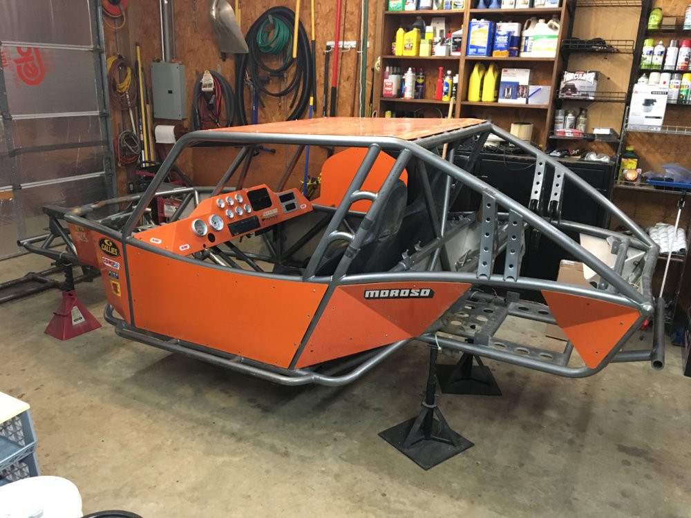

Let's try to get this thread up to date. Finally broke down and hauled to California and back to get my chassis hauled home. Here's some better pictures of it from multiple angles. The orange definitely has to go! I'll also be making some changes to the skins. I believe what's there is functional, but doesn't necessarily look the way I want them to.

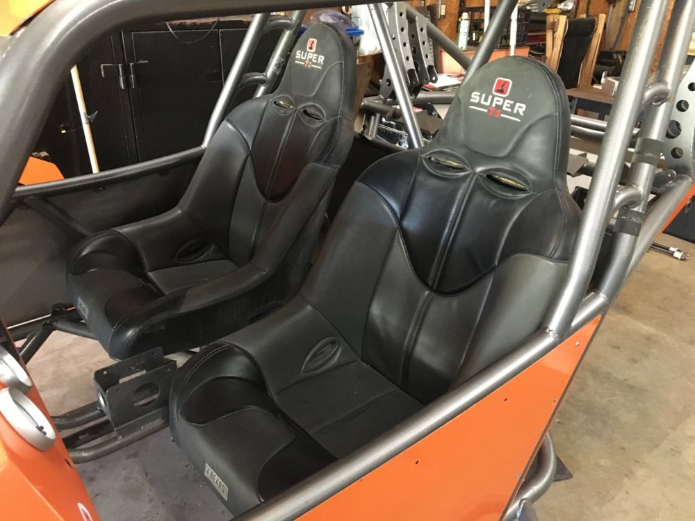

Included in the price of the chassis was a set of Beard Super T1 suspension seats. No cuts, tears, or busted stitches. They're in great condition and only need a little cleaning.

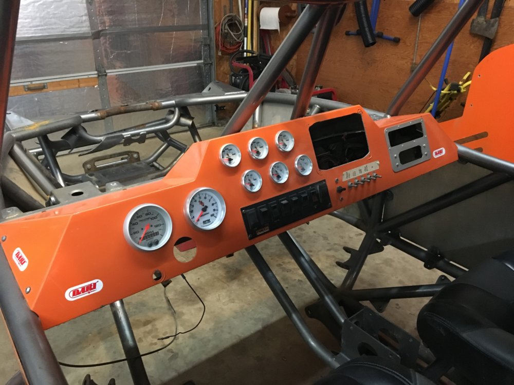

Also included is a complete set of Auto Meter C2 gauges, Painless Wiring switch panel, and the fuse blocks. I'm currently debating on whether I want to buy the Lowrance setup from the original owner to fill that giant hole in the dash. He's offered it to me pretty dang cheap, but I'm conflicted on whether I'll actually use it or not. Not seen in the picture is the steering shaft that was included also.
