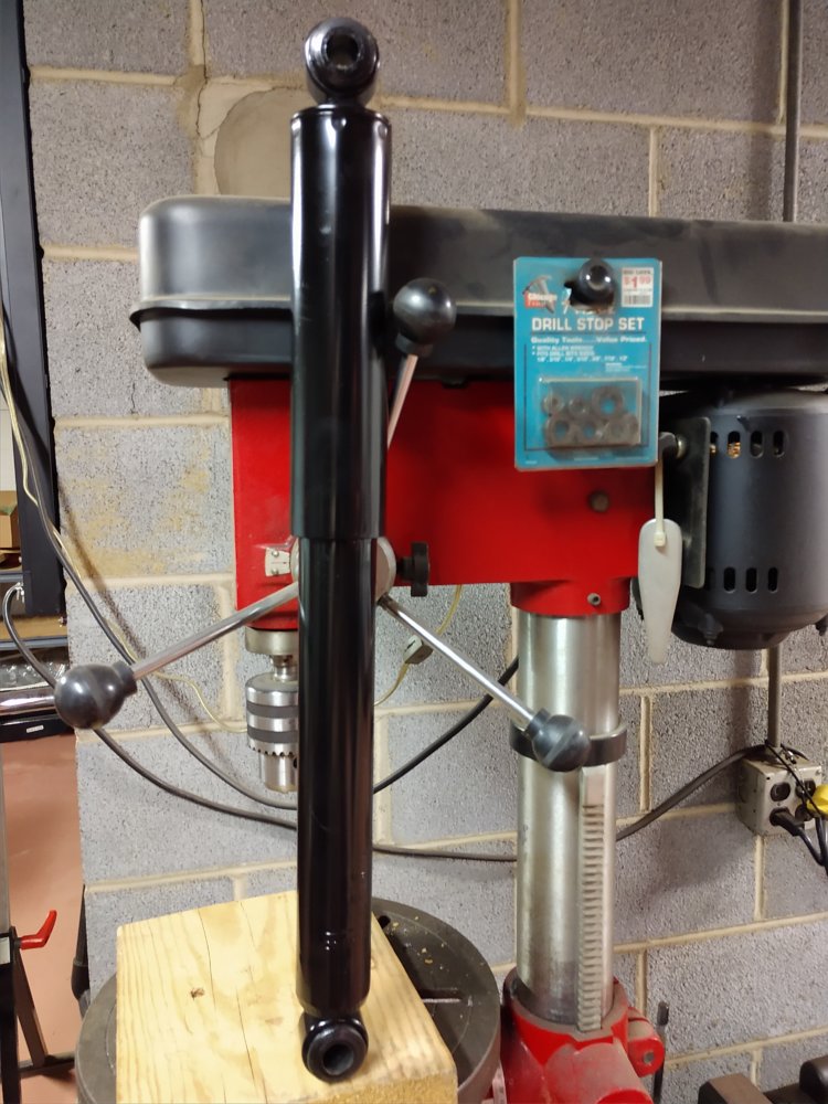

I've got a New set of Gabriel, Guardian-Classic shocks, that was for my CJ. They actually sent me the wrong valved set, & I tried them, but thought they are too stiff for me. Gas charged. Extended - 20.23". Collapsed - 12.37". Stroke - 7.86".
$30 for 4. Your welcome to test drive them.

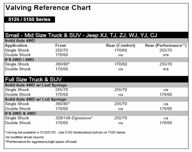

Yeah no doubt having a set of tuned shocks is probably great, but in case anyone was wondering about Bilstein's general shock tuning, there's a chart. I bought mine based off of that, and for my rig, they helped tremendously over the blown out procomp cheapos it had. I can't personally justify spending $1k+ on shocks for something that's a weekend trail rig, as much as I'd like to.
I picked up 14” travel fox smooth body 2.0s for $520 shipped to my casa. It’s more obtainable than people think.
