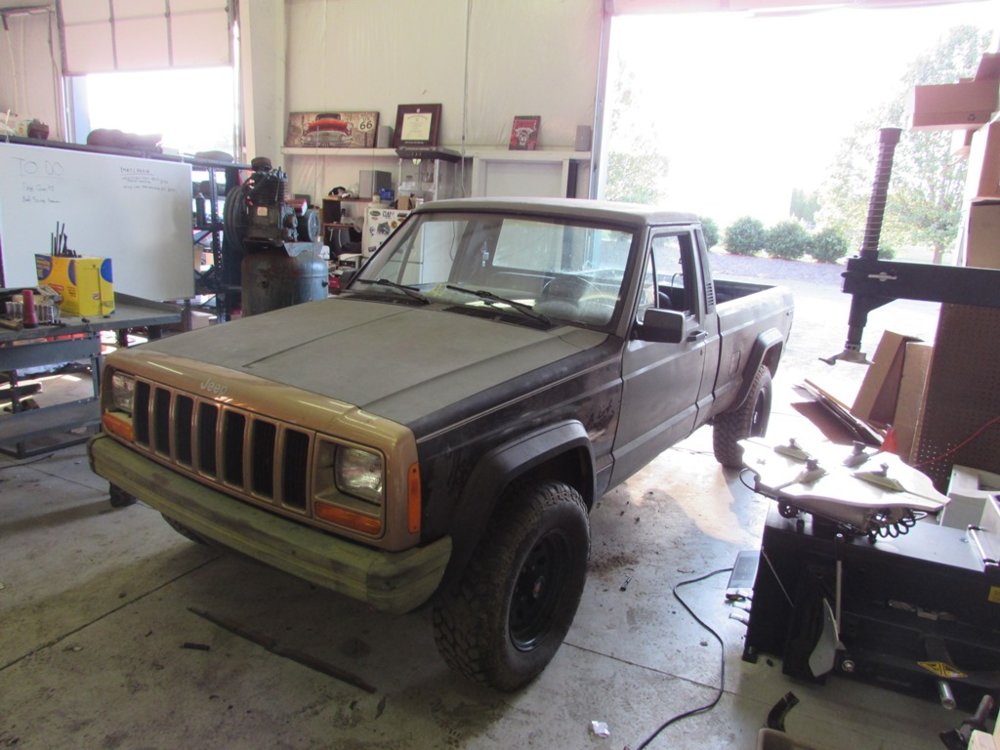

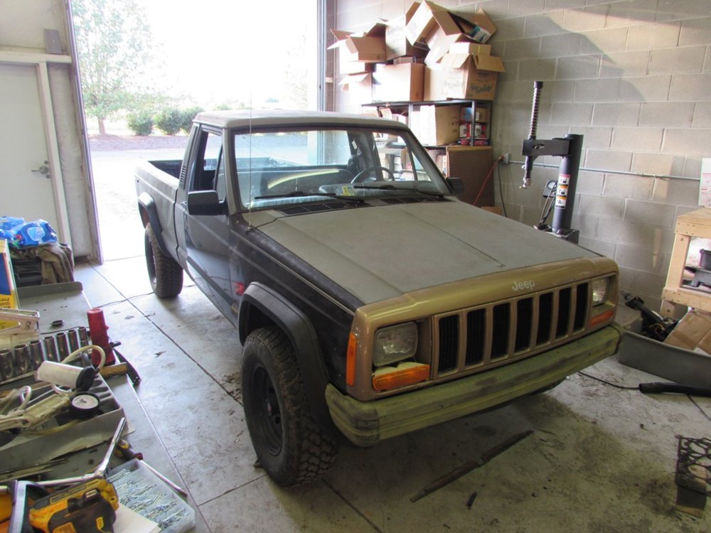

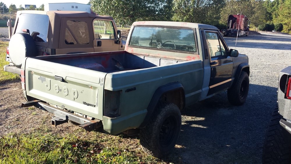

So here's how it looked when I bought it.
So while we were waiting on the head gasket kit to come in, we figured what the hell, we'll climb up to the top rack and see what parts we had lying around for a while. Came up with some 97+ body panels and a new steering wheel. We went ahead and left the old bumper on there and swapped over to the old style flares. It doesn't match up perfectly because of the front fender dropoff, but come on, look at this thing.....it'll be just fine. Can barely tell anyway.

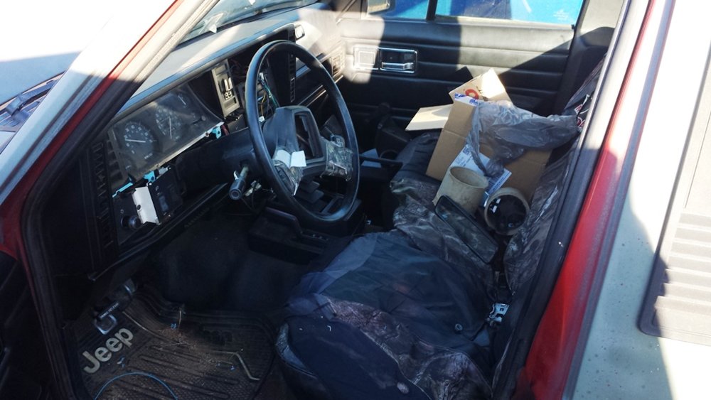

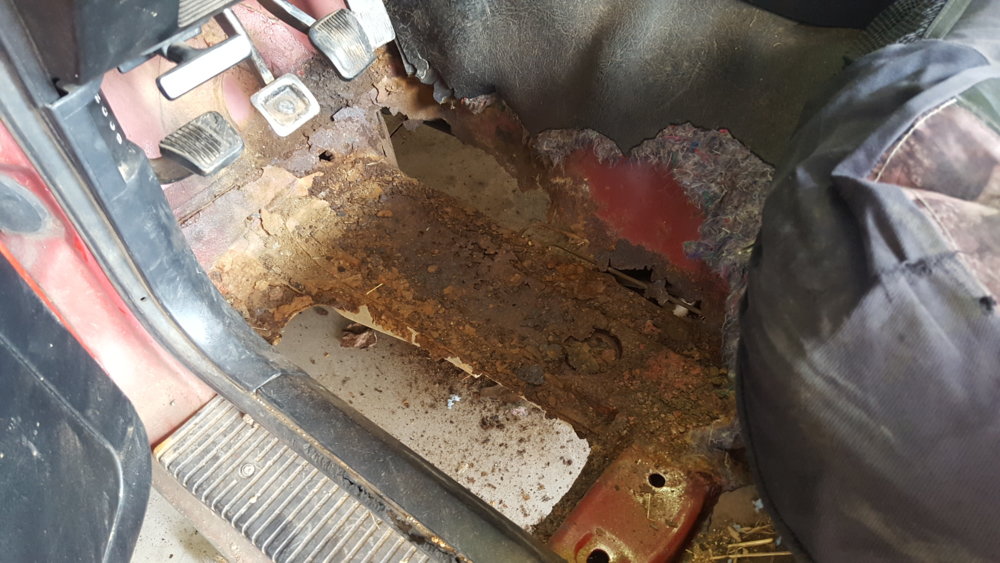

The poor Private has certainly seen better days. He is a tad crusty. First time I attempted to go for a drive I couldn't get my foot on the gas pedal because the floor mat was in the way. After removing 4, yes 4, floor mats I found this:
Good thing too, cuz with it running 3/4ths as well as it should I almost needed to Fred Flintstone it to get up the hill :D

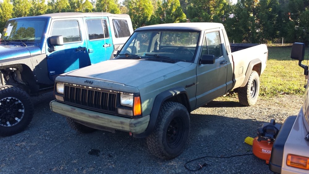

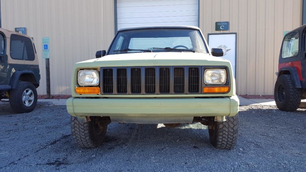

Well, the body is done. At least as much as we are going to. Made some stencils and did our own little military take on the truck. :lol:
And of course, the motor is shot now, no oil pressure. It is just worn out, pretty sure the bearings are shot.

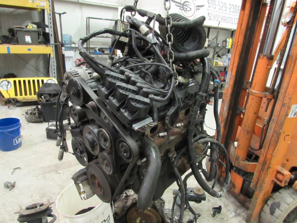

So the motor in the Private is completely shot. We are going to start the engine swap here in the next couple weeks. We are taking these two turds and putting their parts onto our parts and having some fun. With our Private Parts. The joke never gets old.

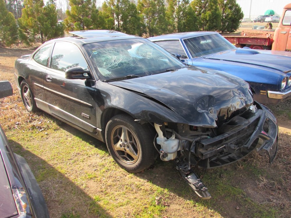

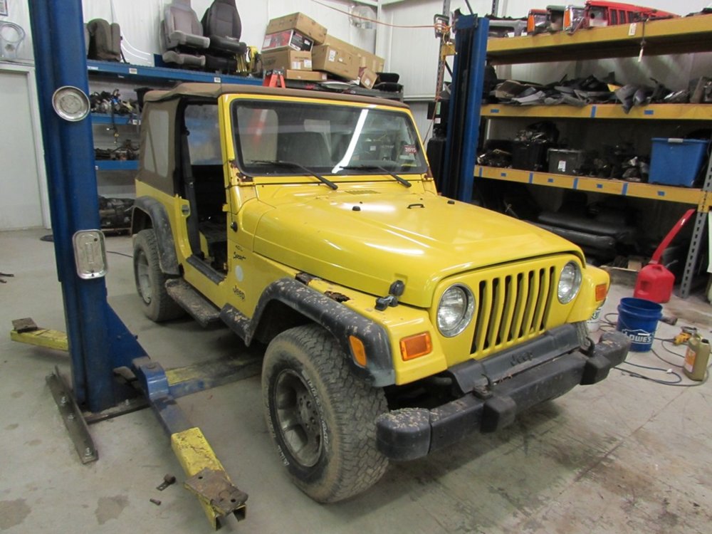

So the plans are to take the GTP 3.8L SC motor and mate it up to the NV3550 out of the TJ with a Novak adapter and a 2.8L S-10 or Fbody T5 bellhousing and 3.8L Fbody flywheel and pressure plate and the appropriate clutch plate.
There are other items to hash out, but this is where we are at right now. :lol:
The parts have been ordered and the donor stripping has begun. We have an early S10 bellhousing with the correct pattern and have ordered a GM3550 adapter from Novak. I also did some research and found that I can use a 3.8L F-body flywheel and pressure plate and once they get here I can figure out the clutch disc for it. I am either going to be using a 4-cyl CJ clutch disc or one out of a 6-cyl 2nd gen Camaro. I'm not sure yet, I have to measure the pressure plate when it gets here. Not sure on the pilot bushing either, that's another measuring item when all the parts are out and ready to be put together.

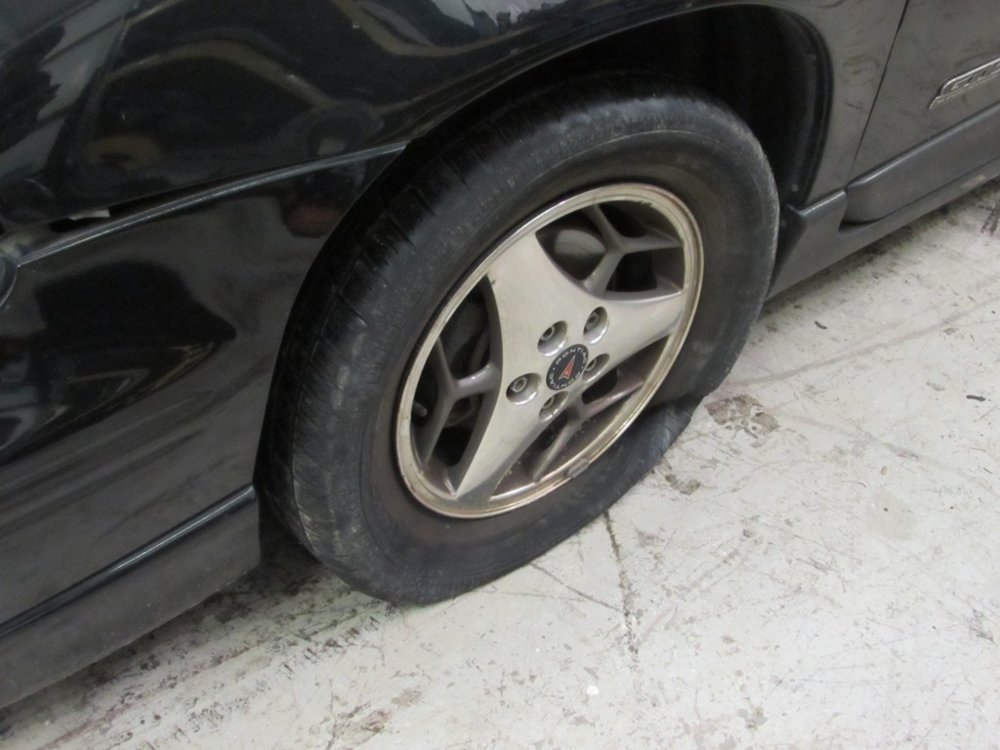

Of course, we went out and did burnouts till one tire went flat. :lol:

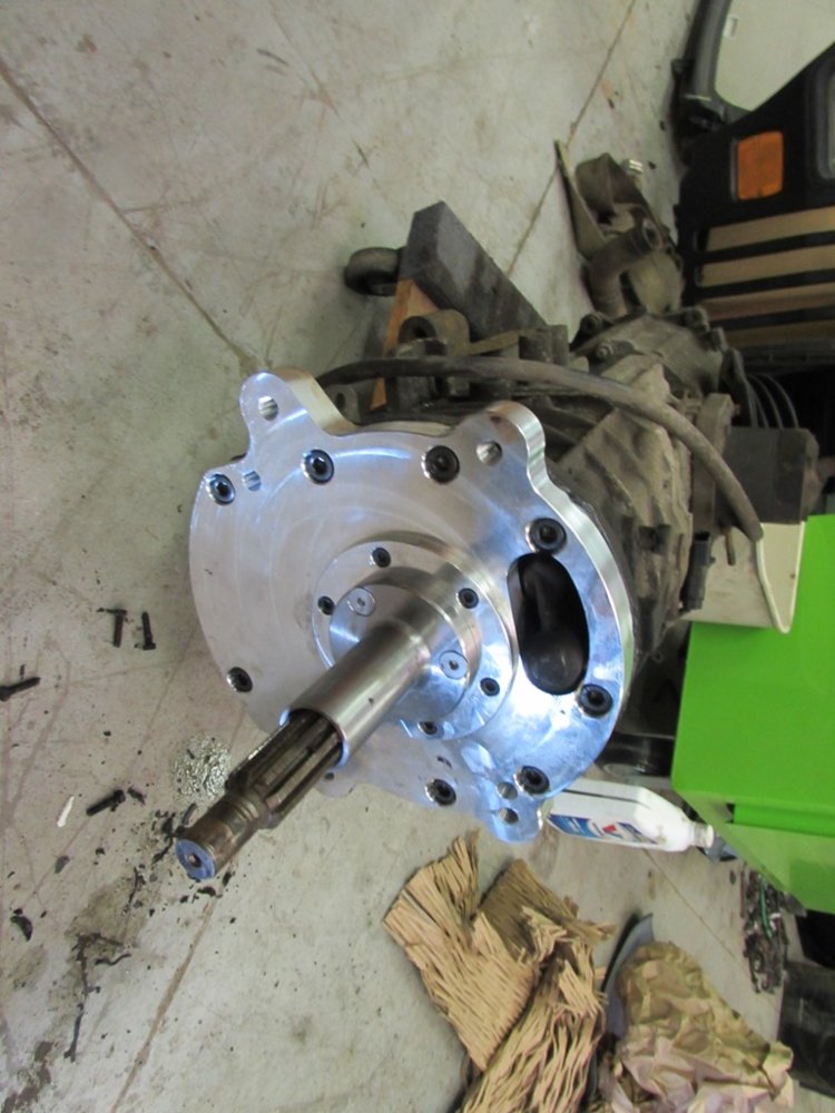

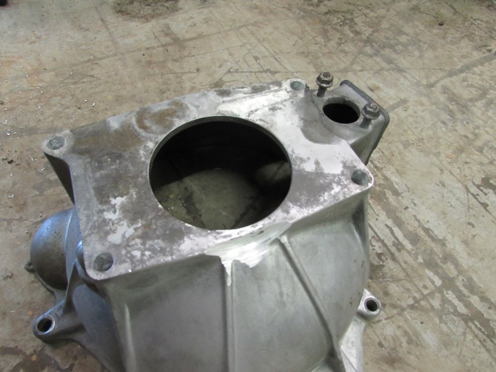

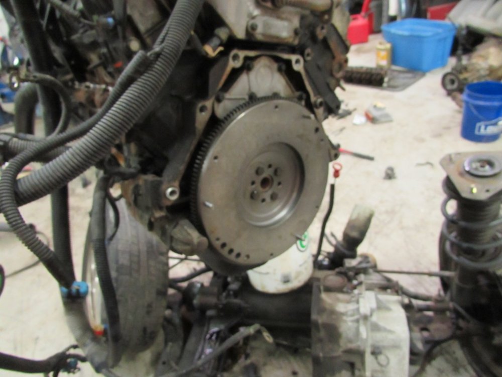

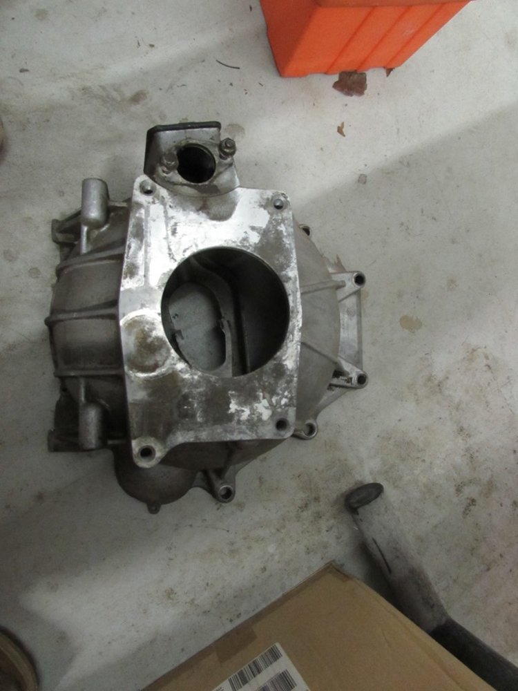

Got a bunch done. Mounted the adapter to the transmission, clearanced the bell to fit the trans. The bolts they sent to mount the bell have too big of a bolt head to fit the bell so I am going to go pick up some flange head bolts to get it to work. Also the block does not have a starter boss on the passenger side, so we're going to have to cut a notch in the bell for the starter on the driver's side. The Camaro flywheel fits, so need to get some flywheel bolts for that and start bolting shit together.

OK, figured out the clutch disc. An early 3rd gen Camaro with the 2.8L and a 4-spd has the exact clutch that I need.
I called Centerforce, they were completely useless and the guy tried to sell me a clutch that was like 1/2" too big. So after I got off the Phone I did some more research and cross referencing and figured it out. :)
