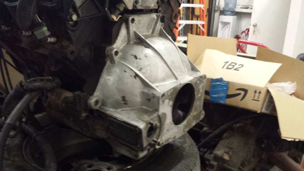

I finally got around to notching the bellhousing for the starter. Did some good measurements and hit it with a hole saw and it came out perfectly. Fits exact and nothing hits, it's about as close as I could get it. I know it gives an opening that can introduce dirt and moisture into the bellhousing but honestly this was the only option we had with this setup.
I'm going today to get some bolts for the bellhousing to trans, bell to block, and pressure plate bolts. Then it is time to bolt it together and start figuring out how we are going to fit it in there.

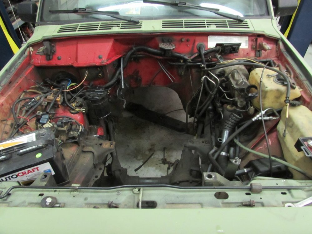

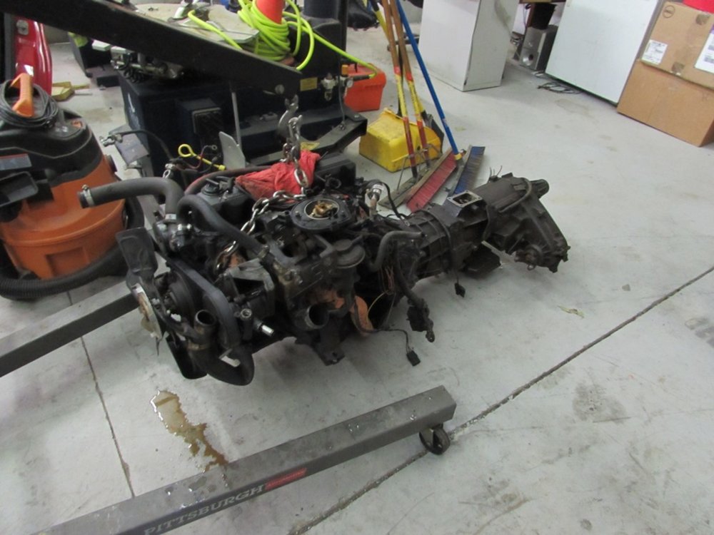

So last night I started the Private up to move it around and I had zero oil pressure and could barely keep it running. I decided that the time was right to go ahead and start the swap. An hour and 15 minutes and I had the old driveline on the floor.

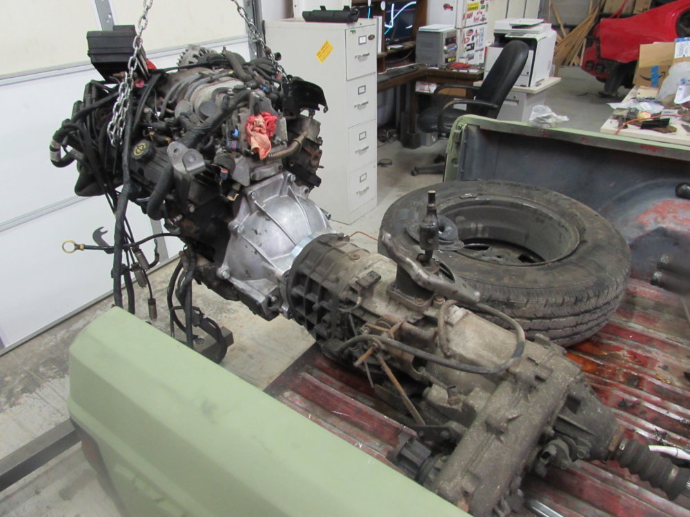

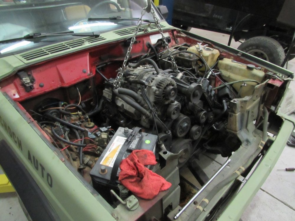

Test fitting the 3.8L SC drivetrain. Going to need to low mount the alternator and build an elbow to mount the throttle body to the side, but the rest should fit!

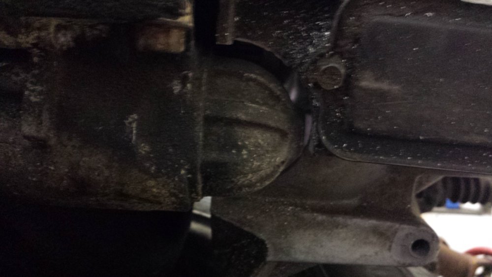

OK, so had a little change of plans here. As cool as it would have been to throw this 3.8L motor into the Private, We are running into issues that are going to prevent us from doing so. If we run the engine low enough to clear the SC snout, the oil pan is literally sitting on the front axle. And that is without any weight on the body. Once we mount the engine, the body will drop even more obviously. At that point we'll have to clearance the oil pan, which will put it REALLY close to the crank or stick the snout through the hood. Neither one is a viable option for us. We can also put a suspension lift on the truck, but it is our parts runner so we really did not want to do that.
