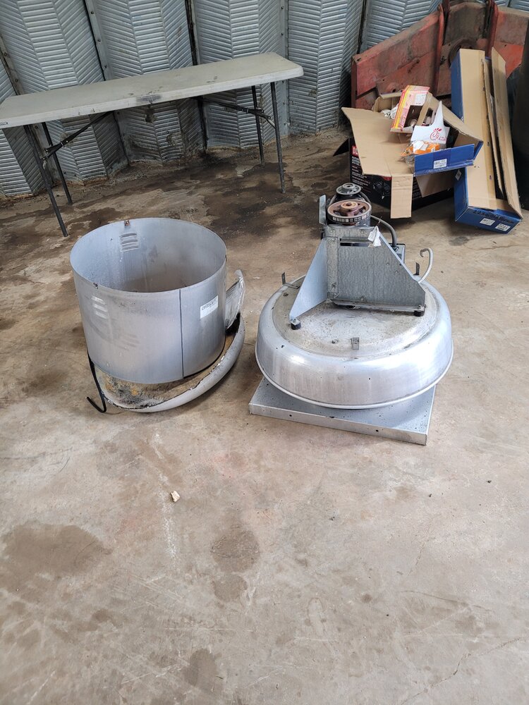

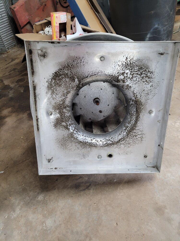

My shop is un insulated and in direct sun anything over 70 degrees it becomes an oven. Was looking for some big fans but I'm doing a commercial restaurant up fit and they are doing away with alot of the exhaust vents. And well free is for me. Originally I was going to build a box with wheels and install this and have it force air to one small area. After looking at it more indepth I'm thinking about hanging this one and two others on the back wall and letting it rip. Which would be the better option. My neighbors will only smell Chinese for a while I would guess.

My shop roof is insulated and it's in the shade for the entire afternoon but it's still too hot. I need to insulate the walls and put a couple mini splits in. But time and money sure do fight these ideals. Anyway, I digress. Hang them puppies on the wall and rock on. Bound to be better than nothing. In my experience, wall mounted exhaust fans just don't evaporate sweat as well as direct wind blowing on me from a fan. But I also sweat like a cold metal roof on a humid summer day.

I'm trying to get some cross ventilation. I can open the front and pull air across and I'm still looking for a swamp cooler. Possibly try to turn one of these into one now that I think about it
Mount fan in sidewall position as high as possible on back wall. Crack garage door for best results (smaller the gap the higher the velocity the air travels). Pull in low on one end, exhaust high on the other end.
