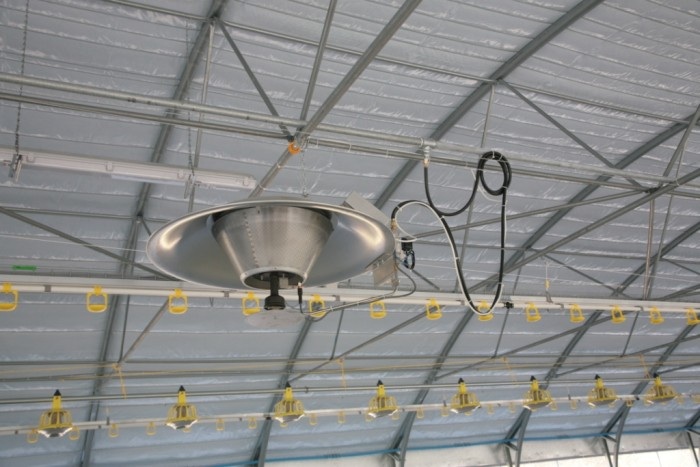

Find a chicken farmer with brooder type heaters. They run on propane and work very similar to the brooder stand heaters on restaurant patios. Plus you can hang them anywhere, run wires for the pilot light, hard lines for propane and then a flex hose from the rafter to the brooder. My dad has several that he rebuilds and has had for 15 years for his chicken houses.

Here's what I was referring to. You can raise and lower it on a cable and use a thermostat

Got an old chicken house heater hanging up in our shop. Think it's around 150k btu, my shop is approx. 30'x40' that is insulated and it can get the shop feeling good in about 15-20 minutes.
Here is basically what it looks, mine is just older.
