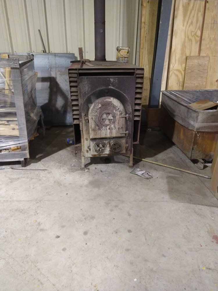

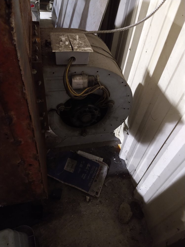

This homemade heater gets out shop nice and toasty in no time 50x50 metal building with blanket insulation. My grandad built the firebox 40yrs ago to fit the tobacco barn heater door. When we put it in the shop we slapped a used piece of 1/8" plate around it as a air space for the blower. The blower is a multi speed hvac fan I got from the dump. I have low and med-high wired up. High speed was too dang loud. We burn pallet boards exclusively since we have an endless supply.

You have an outside picture? How high does you outside pipe go?
I can take one. Pipe outside is 6' vertical. It's roughly 4ft from the horizontal thru-wall pipe to the outside eave, so 2' above that. 16' of pipe total. It draws well.

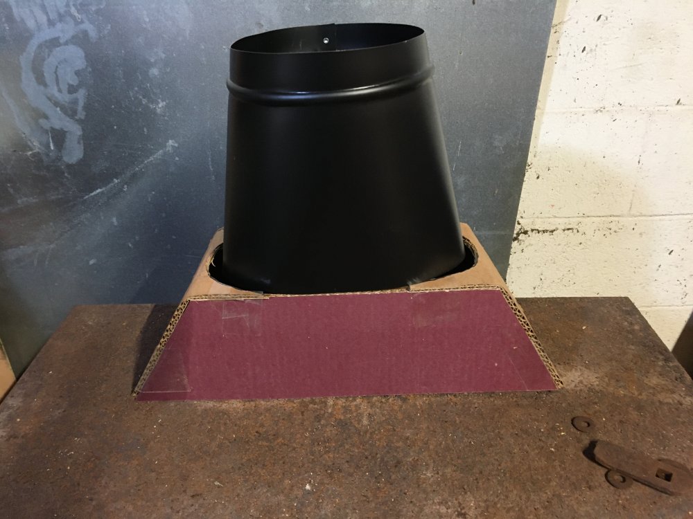

More progress. This is what I’m thinking. I have some old sheet I’ll cut up and weld together. Need to rethink how I make the curved cuts. CAD prototype.

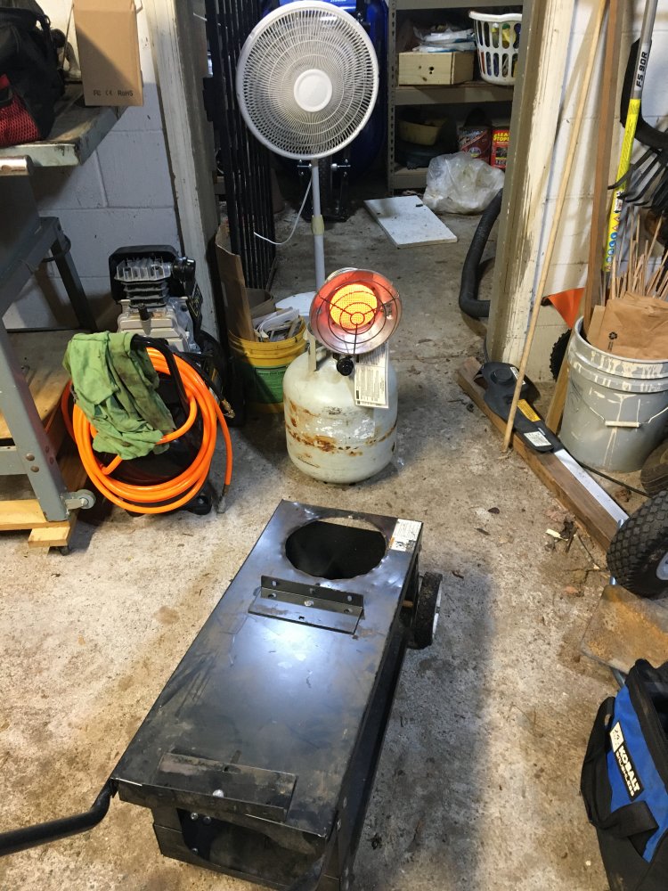

Rainy here today so I’m trying to work on the shop. Got this little guy going.

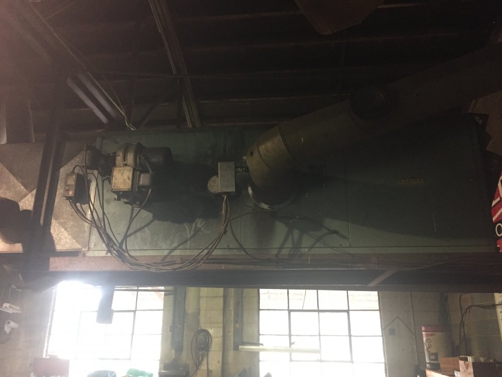

I got two wood stove an and this carrier weatherguard oil furnace works awesome

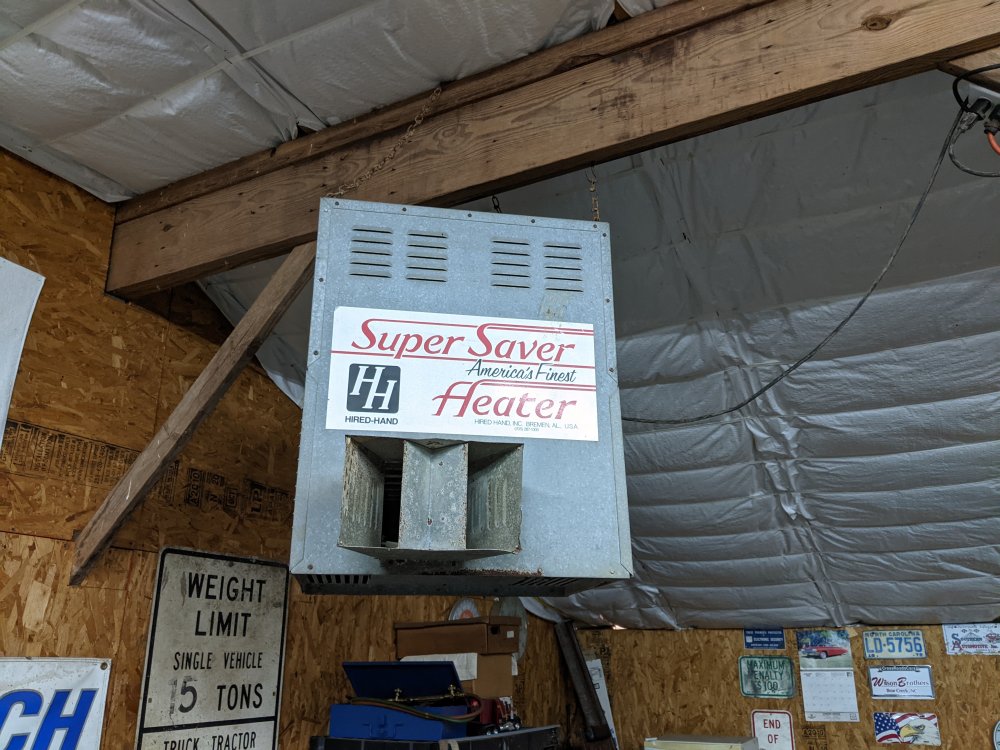

I've got an old chicken house LP heater hanging from the ceiling in my shop. The shop is 48x32 and about 11ft at the ceiling. It's 200k btu with a blower and has a thermostat. My shop is insulated so it never gets below freezing in there. Fire the heater up and let it run for 15 minutes or so and it knocks the chill off enough to work comfortably. The heater is unvented so I don't run it alot.
