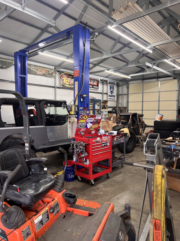

My shop is 28'x 48' with open ceiling about 10'-12' and I have about 20 4' 3000k lumen LEDs in there and it's ok. I could use a couple more here and there. As you get older it's even more important to have a lot of light.
I used hyperlites off Amazon. You can message them and they will send you a lighting plan based off your buildings dimensions.

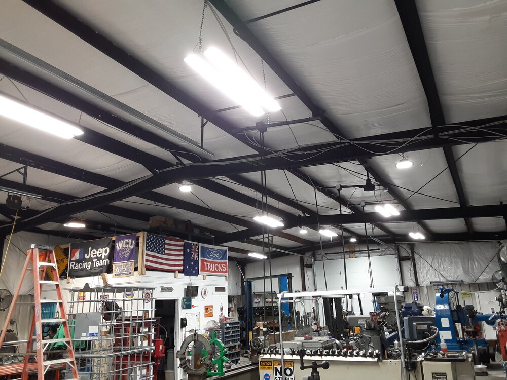

I used 5 lithonia high bay led lights for my 32x48 and was a huge upgrade over
1: 8’ HO fluorescents
2” 8’ LED conversions in above fixtures
Yes they cost more than Amazon specials, but I was tired of changing bulbs and tired of not enough light.
I have mine set to low setting (20k lumen, 4000k temp) and made a 6” cone to hang to reduce some of the angle and glare.
The light directly above was never an issue, it was the lights not above were a small nuisance.
6” wide “cone” or shade on the fixture makes it where I can’t see the leds directly and reduced the glare nuisance.

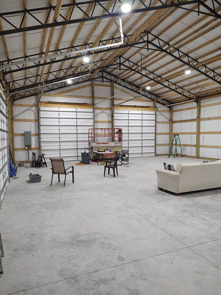

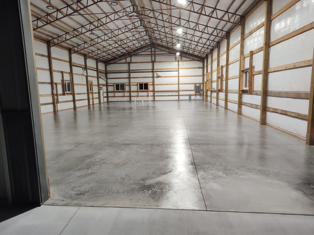

My 40x80x16 has 11 200w led UFO high bay from Amazon. It really should be 13 but one corner is being turned into an apartment so I didn't hang 2 back there. They are bright enough that I added dimmers to them.i don't have a good pic of them all on at night, but this is just the one side one. The middle and other side are my work area so they're on a separate circuit.
Holy crap, that's got to be bright af. My 40x50 only called for 8 🤣
Yep, only called for half of that but I wanted it stupid bright. I also installed bluetooth outlets on all the lights so I can turn them remotely. Kasa makes inexpensive smart home devices that are app controlled. I have them setup on two bluetooth light switches, one for each half of the building. The app lets me control each light individually.
