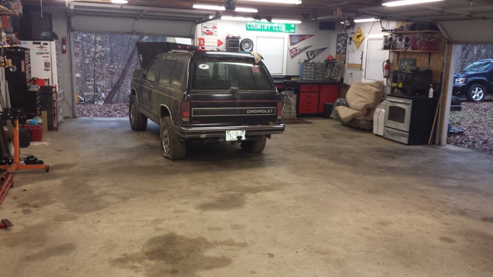

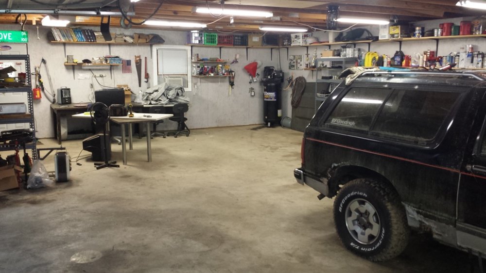

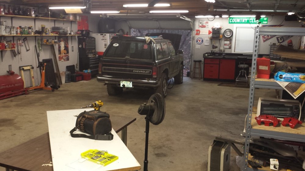

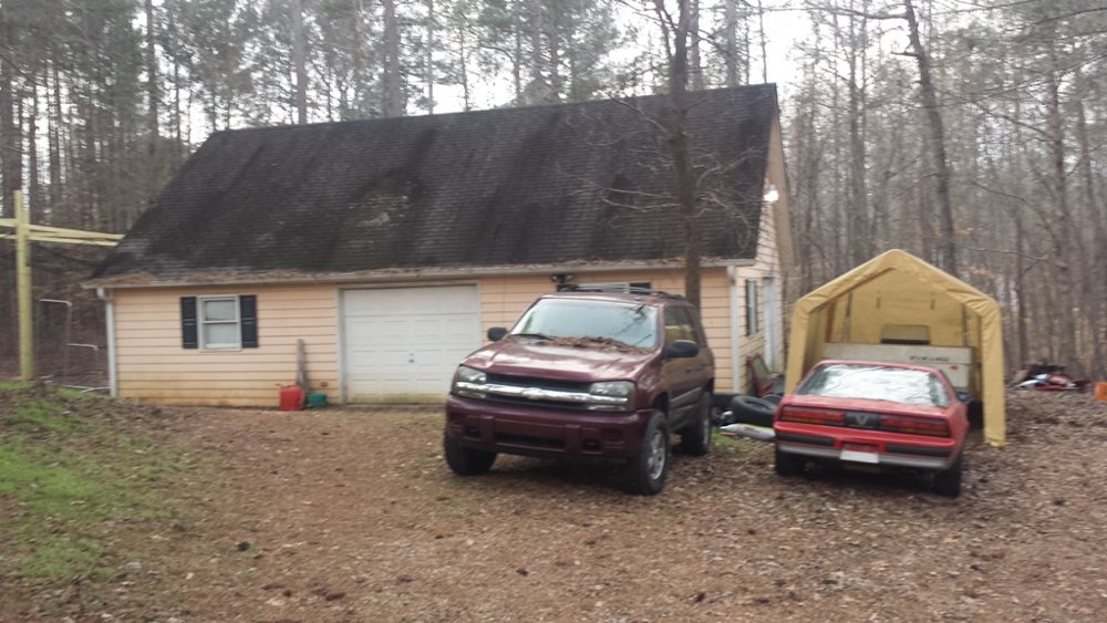

So with me closing down the Jeep shop to move home and build cars with my boys, I need to redo my shop to make it more functional. Right now it is a stupid layout, not sure why a car guy built a shop like this, but it is what it is. Shop is a 26x39 with 8' ceilings and two garage doors. The doors are stupid, one is in the middle of the long side, and the other is on the back corner of the short side. It is barely functional as a shop.
First phase is to build a long 15'x39' lean-to storage area off the back of the shop. That way I can keep all the stuff from inside in there while I redo the inside.

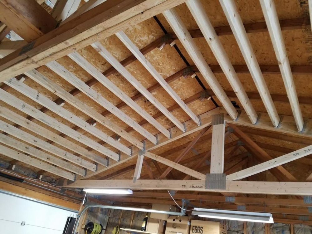

Next phase is going involve reworking the joists to make the ceiling 12'6 to fit the lifts. It'll be a kind of vaulted ceiling look, but it'll work. Talked to the architectural and structural guys at work and they came up with a design that will work. I'm going to do 2/3 of the shop like this so I can still have some attic storage.
Final phase is to grind and paint the floors and paint the walls. Plan is to sheetrock/whiteboard the ceilings and paint the walls so I can make it bright and nice. Then install the lifts. There will be a 2-post in the middle and a 4-post on the right side that can store my 98 TA and 89 Firebird Formula.
Pretty excited about this. I'll update with pictures as I go. Here are the current pics I have.
Outside:

For the roof joist mod, the roof is currently prefab 2x4 trusses. The plan is to sister 2x8 up to the side of them, glued and screwed, attached at the exterior walls. They will be gusseted with plywood triangles glued and screwed to the outside. Then I will have a 2x6 ceiling joist at 12'6" gusseted and glued and screwed, then trim out the lower section of prefab truss. Kind of hard to explain, but I've gotten the thumbs up from people who do that kind of stuff. I'm just an air and water guy. :p
You'll need an engineer to seal the changes. Roof trusses are not meant to be modified.
If your co-worker is a PE and will sign off on the design, cool. If not, you'd better hire someone who will- if you can find one
I'm basically building new joists butted up against the side of the existing ones. Technically I wouldn't need to sister them together, but I figured what the hell, they are there so might as well use them for a little extra support.
I'm sure they would sign off on them if I needed them to. I don't though.
The other idea was to find a way to lift the roof up 4', but that would have been too expensive. I talked to a company that lifts houses to add extra floors to them and they wanted $12k just to raise it up.
Also, in the end, we also may end up just tearing the roof off and extending the walls and building the roof back. The roof leaks anyway and needs to be replaced, so not sure what would be less time consuming in the end.
I would still like to see a DIY job of raising the whole building up 4', and building new 4' walls below with sistered in studs, LOL.
How is the wood under the shingles? If the roof is leaking and there is some rot in the sheeting, then it almost seems easier to just tear off the roof and trusses, then build the new trusses how you like.
Well, we have a plan that we think has a high probability of not killing us, but it would make the shop look HUGE. And still has the small chance of killing us. :lol:
A guy here mentioned something about a free span truss design, and someone also mentioned it on garageforum, so I looked in to it. Might be the best option, it involves having two larger joists smacked together and purlins between the two. I can put one between the two high bays and it'll give me more ceiling space and be less work overall. And easier to sheetrock and all. Going to talk to the guys here at work about this. I think this might be the best option.
The issue there is that the bottom chord of the trusses technically needs to be braced.
I was a truss designer in a past life. I went with attic trusses over two bays of the garage and vaulted trusses over the bay with the lift. The trusses and sheathing went up in a day with a crane and a few amigos that worked for a buddy of mine.
My thought was that I was basically fabricating my own open tie truss in place.
