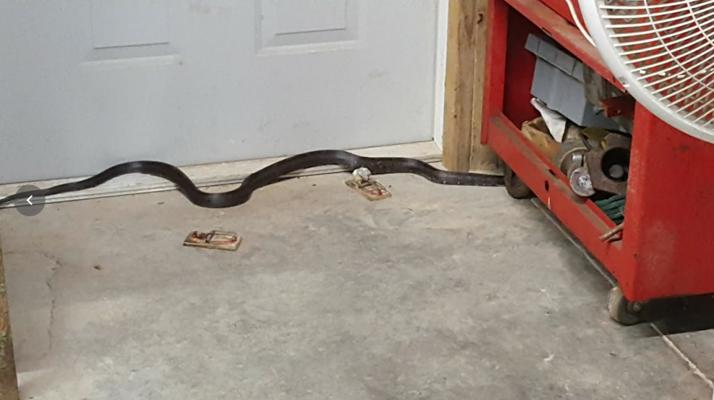

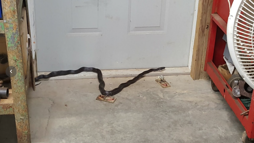

Black snake or a cat will take care of the mice.
Humidity, no help.
What's that old saying about a picture?
Haha nice of you to put the fan on him to keep cool, doing all that work.
