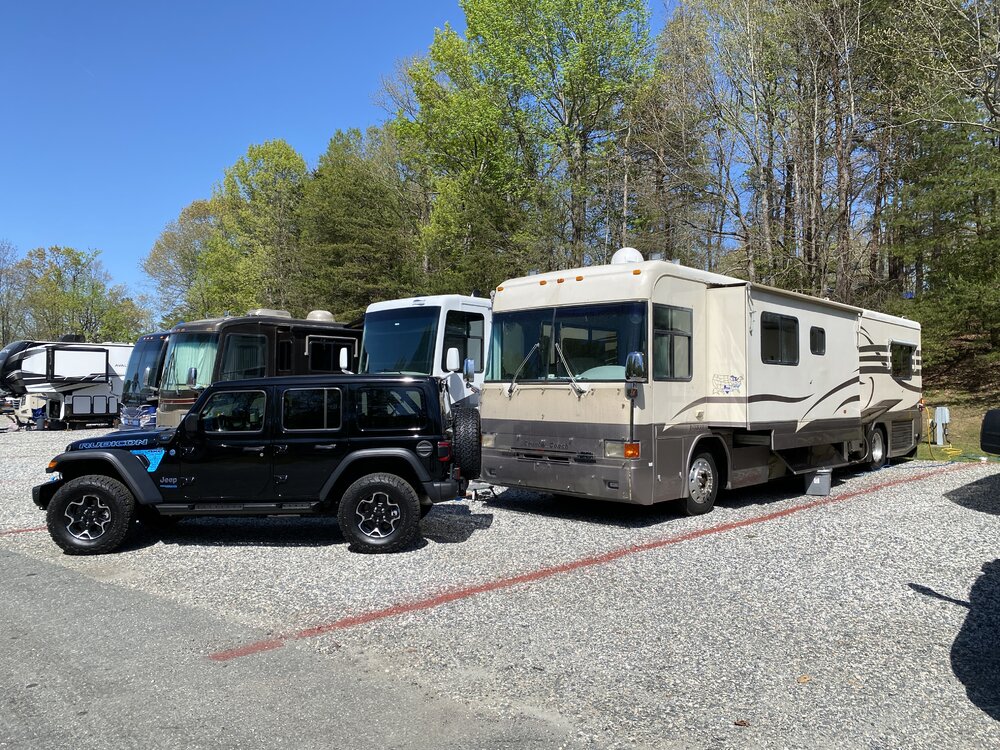

I appreciate all input.. AND side thoughts on, "buy a sport and put lockers/chromolys) also welcome if I am spendign too much for Rubicon vs buying/building something. My longer term goal is to build something I may drag out and do Rubicon someday, Moab, "big bucket list" trails rig that I can pull behind my diesel pusher motorhome. Prob on trailer but flat tow also a really good possibility since we flat tow the JLU.
Pic of the RV and the 4xe below
Sam
