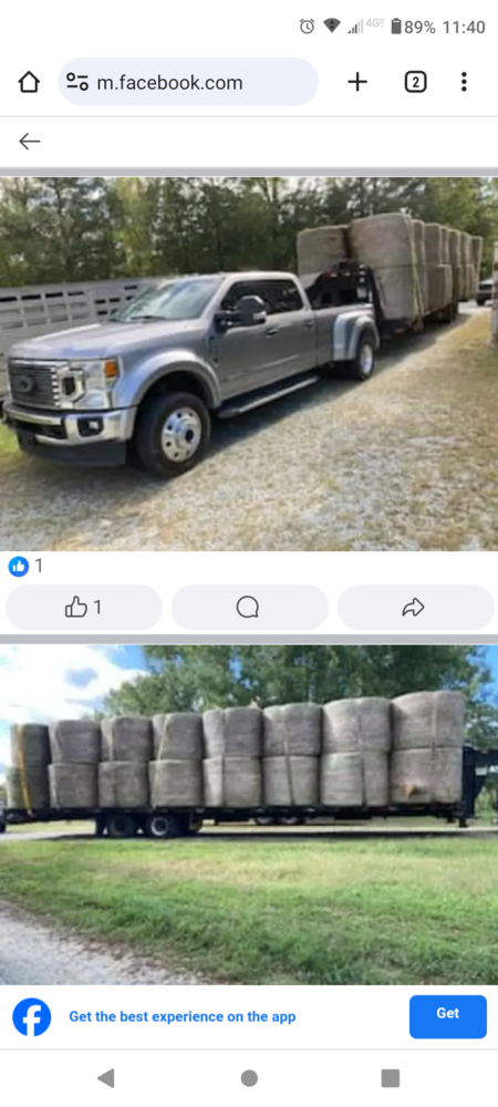

So what is annoying with this type of showing off is that most folks only have a Class C license that has a Gross Combined Weight of 26000#. The truck weighs over 8000#, that trailer is probably about #4000 #8000+, then if we use the low estimate of 650#/bale with 32 bales the cargo is 20,800# so the total is 36800#. Using the high estimate the total is nearly 42000#. Then you can see that the load was over width with no signage.
In nearly any other circumstance I would never want the government involved in anything but I have advocated for a Towing Endorsement on driver's licenses for a long time. Everyone that wants to tow something should learn all about towing capacities, loading, weight distribution, weight limits, licensing requirements, etc. Most of these 1-ton trucks can handle more than most people have licenses for. It is a dangerous game. I see improper equipment and overweight trailers all the time. My favorite ones to stay away from are pretty much anyone towing a large 5th wheel camper; I have witnessed so many highway tire blowouts on those that I lost count.

On the subject of "how insane tow capacity of light duty trucks is today". A guy I went to college with posted these pics this week. He said it was oats and they were guestimating the bales were between 650 and 800.

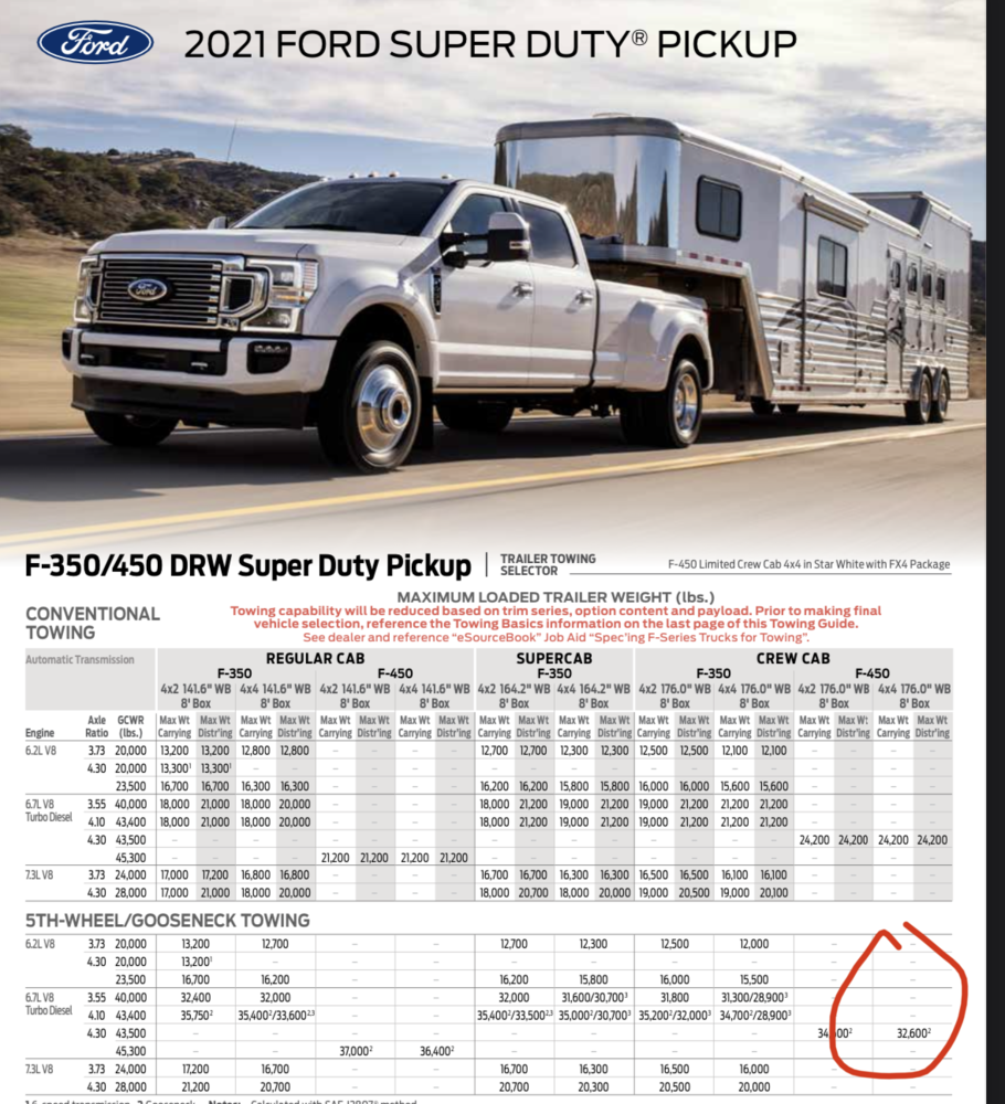

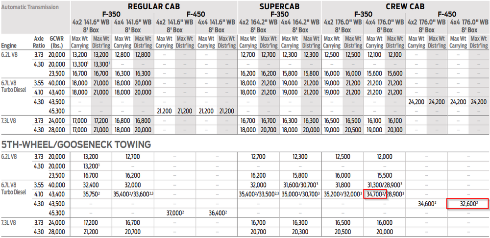

Those trucks do have a Dana S135 or M300, which is the same axle used in the F550/5500 cab and chassis trucks of Ford and Ram, they just have a GVWR limited to 14,000 in order to still be classed as a "light truck" instead of "medium truck". When I was truck shopping, I found it amusing that people on the forums would argue that the F350 was the beefier truck because it had a higher payload capacity than the F450, even though the F350 only had those higher numbers because it was the lighter truck. An F350 Dana 80 rated at 9750lbs is certainly a good axle, but nothing compared to the 13-15k load ratings of the big axle in the cab and chassis trucks and F450 pickups.

All that does is solidify my argument even more. That truck was probably over-dutied if it was an F350 (cannot tell from the picture.)
The funny thing is that the dude who posted it is a complete stiff. I'm 100% sure he was completely legal. Caleb is always by the book.
Towing capacity on that truck is around 33k pounds

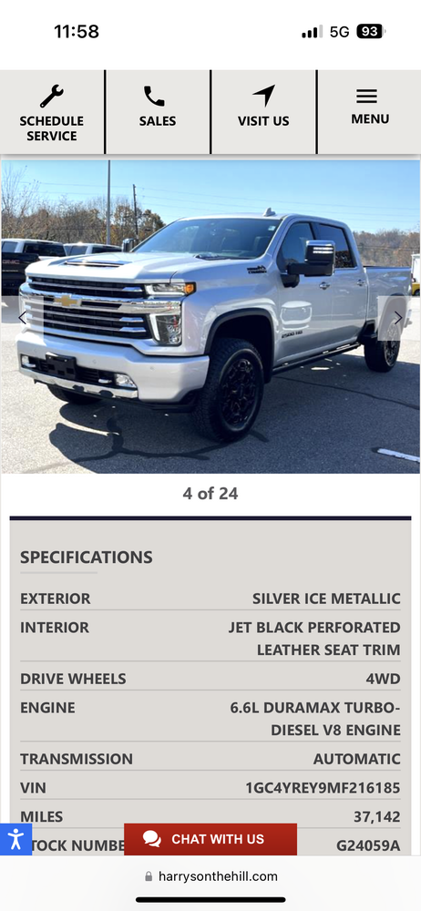

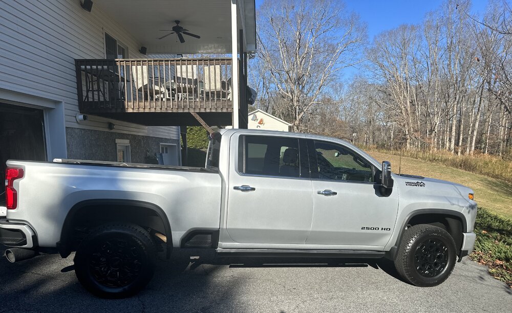

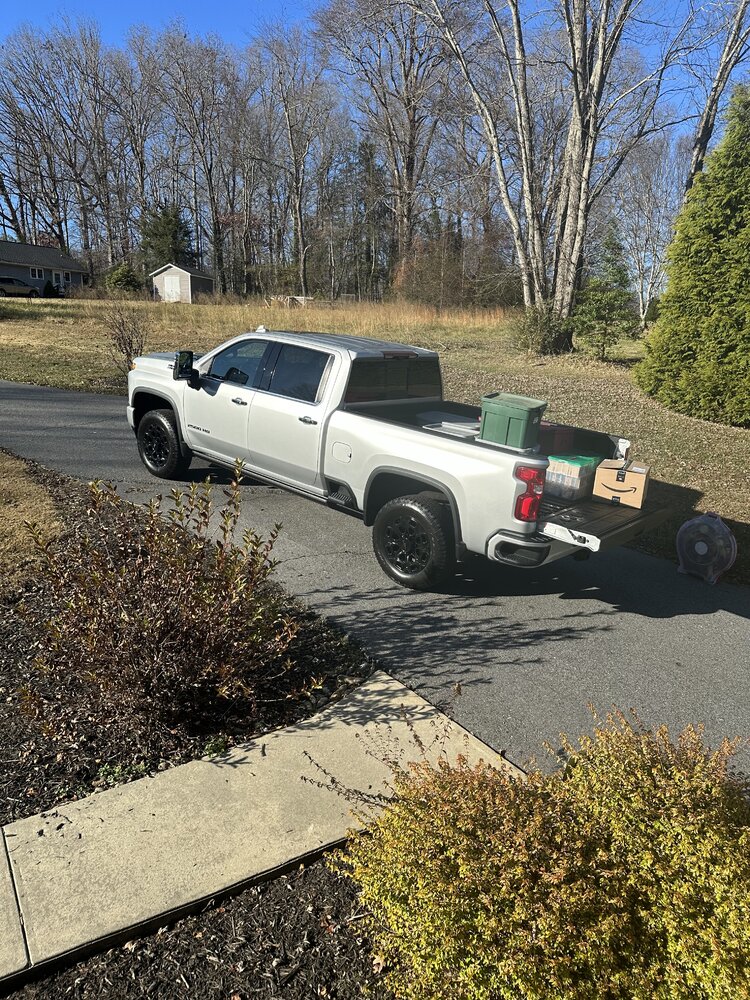

Well after a long interesting battle with the person that hit me insurance company I will finally get my check for the loss of my truck. I decided on a 3/4 ton Duramax to be used as my daily and a backup to my work truck for a new business venture I’m starting up very soon. Feel I got a deal on a low mileage 21 High Country that is in like new condition. I will be picking it up in a couple weeks after the check gets to me from insurance.
