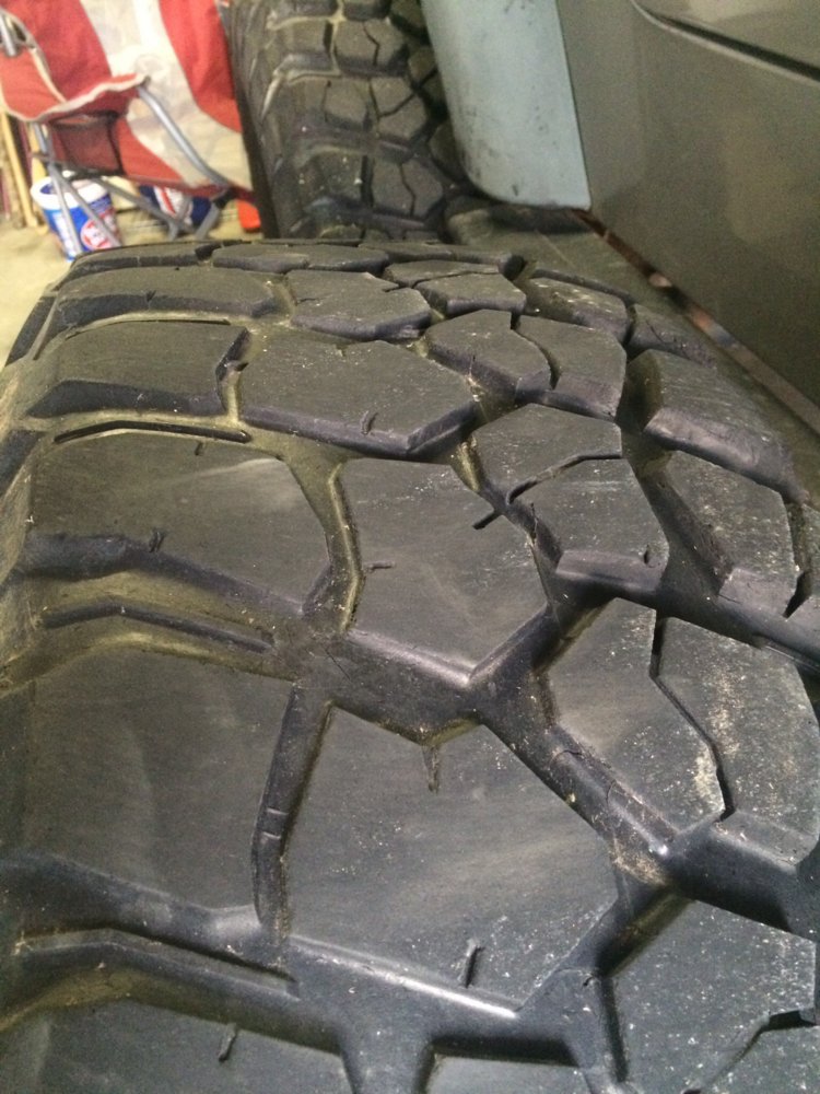

HP Dana 44 front in my TJ. Alignment is fine, I can let go of the wheel and it tracks straight down the road. But the camber has worn my front tires uneven. I finally decided to correct it so I can drive it more, so I bought the shims, and am currently putting everything back together with the camber corrected.
The back tires are worn evenly. The fronts, as you can see in the pic, look terrible. At this point, should I rotate front to back and back to front? Or buy 2 new tires?
Just rotate and run then, look similar to my tires on the Toyota.
Sent from my SAMSUNG-SM-G890A using Tapatalk
Rotate and roll with it!
Usually once a pattern is set on a tire, it continues
This!
I use to think I could rotate a tire to the rear and it would wear the GOOD part down to the bad part...but I learned the hard way the above truth.
