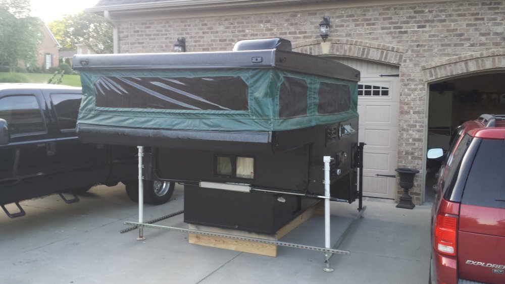

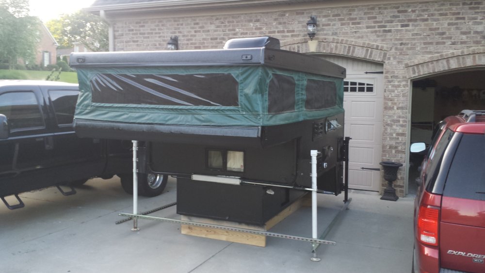

The 1 my friend sold on here, was sitting on some blocks & pallets. He had lowered the jacks to the homemade platform.

I just use 2 saw horses the ones i have are metal and fold up but support 1100 pounds each

I made mine out some cheap tubing I had laying around. But we built buddy's out of some 4x4s in the corners and two in the middle and tied them all together with some 2x4s. Was cheap and took probably less than an hour to make. Here is pic of mine maybe he will post his. @Noel

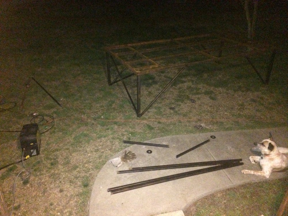

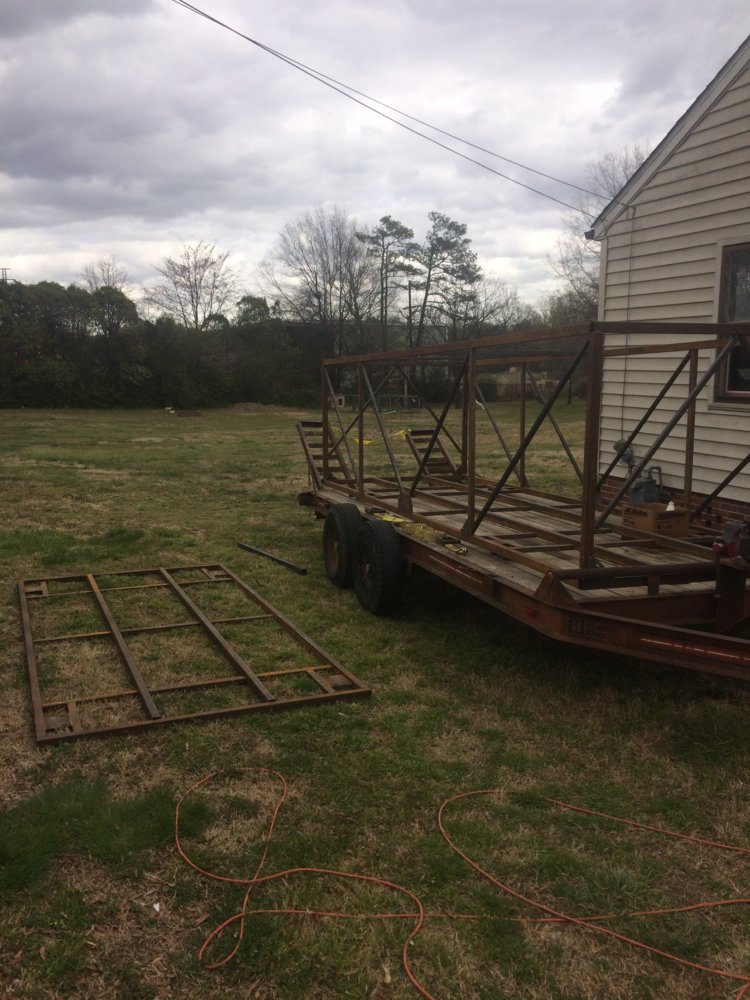

Got some free scrap metal from a shipment that came in from work.
Gonna use the smaller frame and just weld some legs and bracing on it.

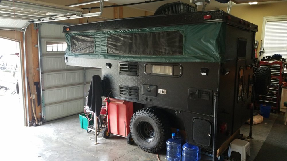

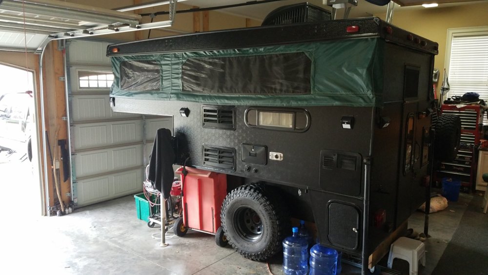

I keep my slide-in garaged....I made a "cart" for it so I could roll it in and out with ease
all I did was add 6" solid casters to the bottom of my 2x10 base I made for painting it
Got some legs welded up yesterday. Gonna put some bracing on them and be done with it.

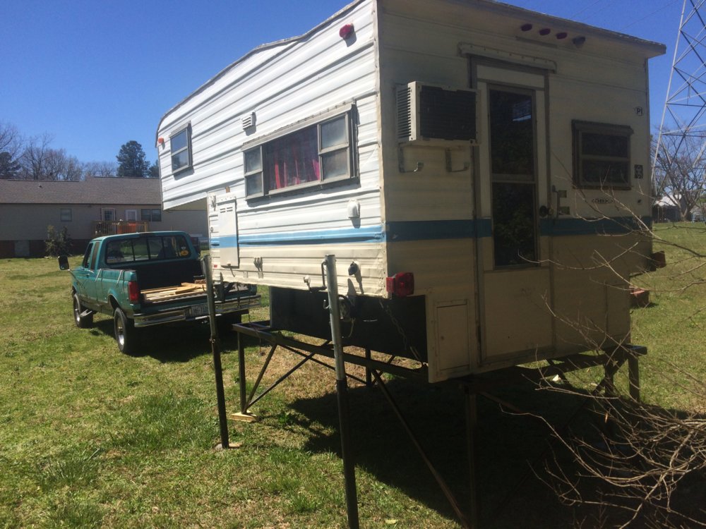

I like that for a transportable stand. Metal was free though. I'll do the plywood for when I want to pull out while camping.

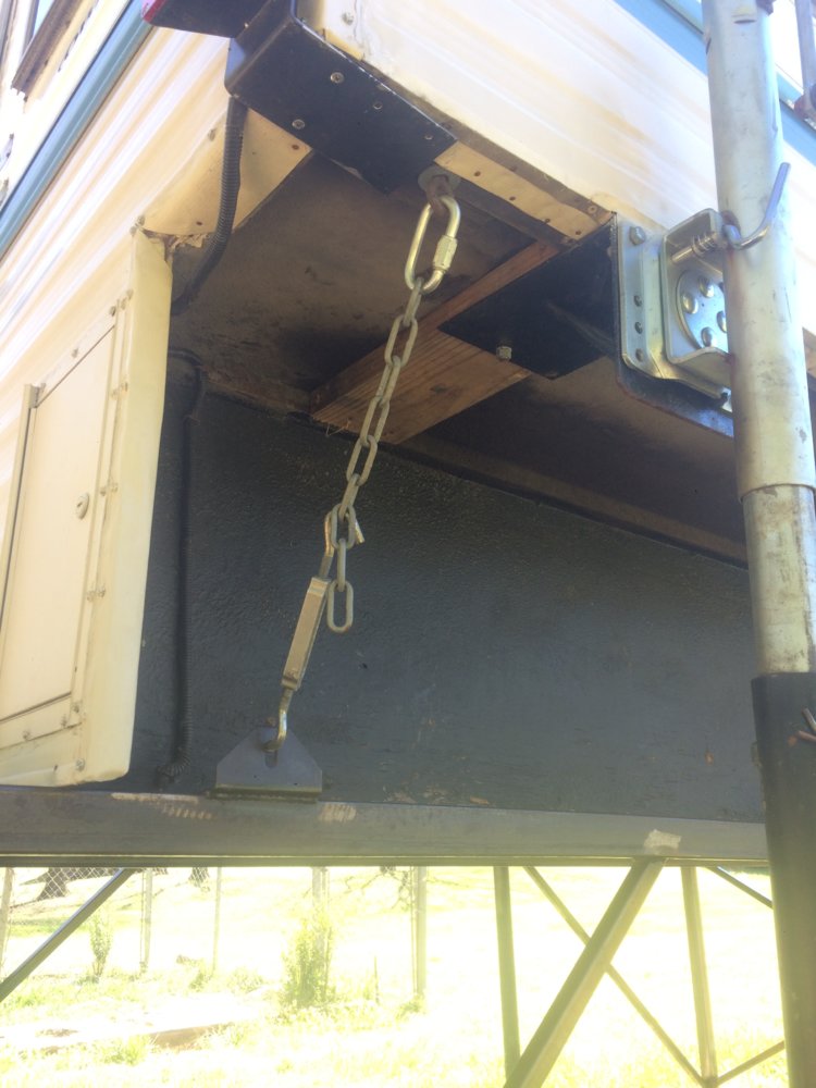

Got it almost done tonight. Not much time to work. Just a couple of hours.
