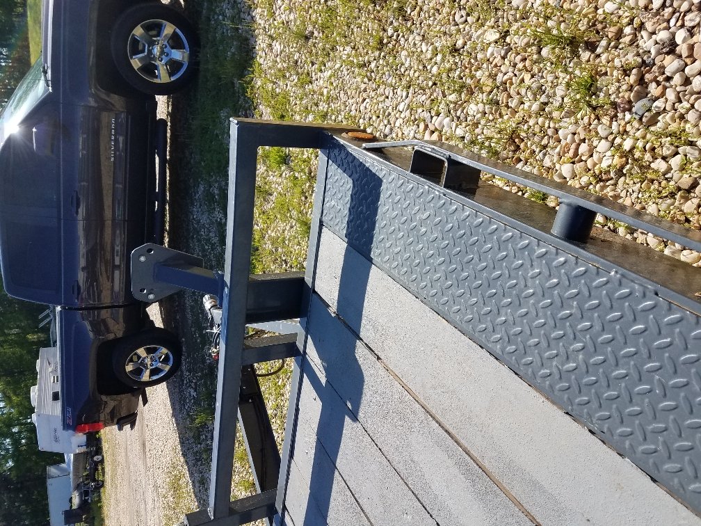

There is a deck "paint" I covered my trailer deck boards with that seems to work and wear so far. Cant remember the name but it came from Lowes. 1 gal was about 2 heavy coats on my 18ft available in black brown gray maybe more.
