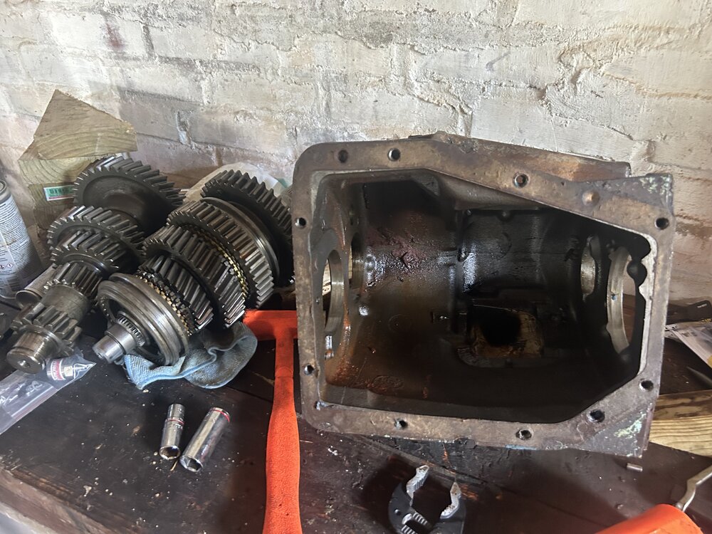

I am terrified to open my. 40+ years old and never openedFinally getting around to this, if you pull the bearings from the countershaft first the input comes out pretty easy, but that main shaft has the clearance of a frogs hair and is one heavy sob. I have 2 gears with bad teeth but have replacements already
My gears all looked good last i had it apart. just that 2nd gear synchroFinally getting around to this, if you pull the bearings from the countershaft first the input comes out pretty easy, but that main shaft has the clearance of a frogs hair and is one heavy sob. I have 2 gears with bad teeth but have replacements already
