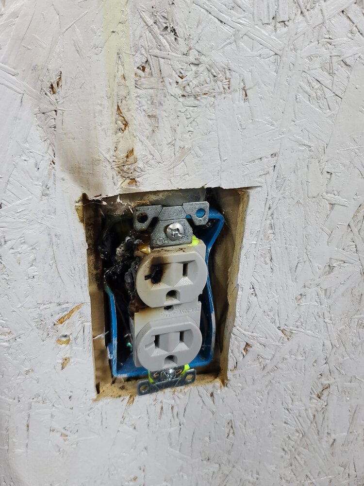

Anyone have anything like this? I almost had a fire in my shop yesterday due to an electrical outlet going into full meltdown mode. It melted the box and charred the stud but somehow didn't catch anything on fire. Unbelievably lucky.
My wife was wondering if there was any way to do a fire or smoke alarm in there, but I wasn't sure if there was anything that would work with grinding and general smoke that would happen in a shop. I don't want to be setting it off all the time.
My shop is about 100-125ft behind the house so if it caught on fire it would be too late before I realized any issue. BTW, the stud was burned up behind the wall and the insulation was charred. Crazy.

My question would be "why didn't my breaker trip?"
Two different types of smoke detectors - ionization and photoelectric. I think photoelectric would probably work better in this case, but that's just a guess. If you had one, would you hear it going off? What was the deal with the receptacle? It looks like it was decent quality. Was it wired correctly? Backstabbed? Was anything plugged in when it failed? Switching to arc fault breakers is an option, but expensive.

I'm not sure, but judging by the charred stud and the black soot up the outside of the wall I assume it made some smoke. Not sure enough to set off an alarm though.
The receptacle was broken and someone shoved it back in the wall. I'm assuming that had something to do with it. I had a small space heater plugged in to it, but it is one that I've run for years in there without any issues, just not on this circuit. I've thought about arc fault stuff but yeah, very expensive to convert it all.
So it was probably the combo of the high current from the heater and the broken receptacle, probably arced.
It looks like your wallboard is just painted OSB? Is that right? If so that could have ben a lot worse. Hanging gypsum drywall is a PITA but it's a great fire retardant.
Are the receptacles wired under the screw terminals w/good contact, tight screws, etc? If any of them are backstabbed into the spring terminal holes, I'd rewire that shit ASAP.
The cover plate is obv missing, but keep in mind that the terminals in 20A receptacles are a lot stronger than regular 15A recepts. It puts more load on the cover plate when you plug/unplug and makes it more likely the recept moves around, cover plate breaks, recept body breaks, etc. Important to make sure there are spacers under the recept body screws (to the box) and that you have a good quality (metal) cover plate.

Photoelectric detector *should* detect a smoldering fire. Whether you'll get nuisance alarms from it I can't say.
Yeah, it's all painted OSB. I'd like to replace it all with GWB but 1200 sqft shop wouldn't be cheap. It had the OSB when I moved in.
All the ones that I've looked at so far are on the screw terminals. I always do it that way anyway.
